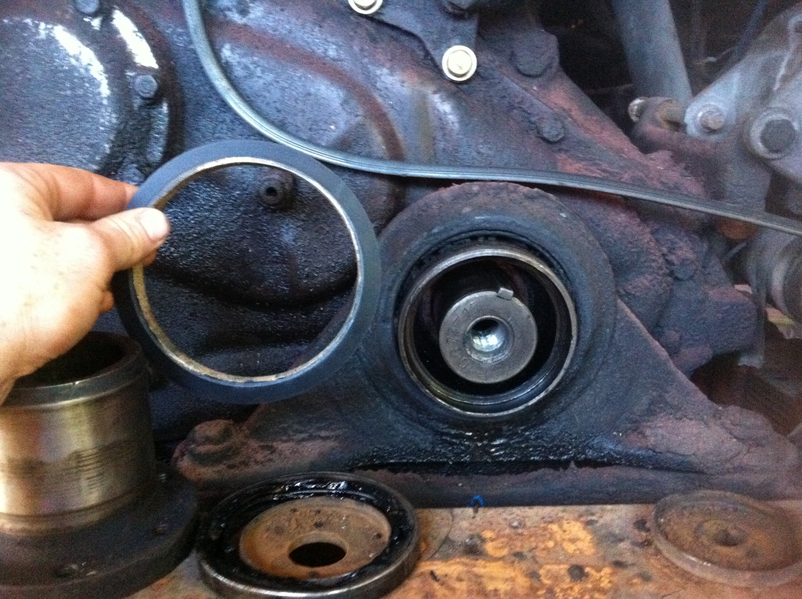

I got my front seal and rubber front motor mount from Watt's.    any tips or tricks in installing the rubber in the front motor mount on my b67?  Is it going to be easier to unbolt the mount from crossmember and install the rubber in that first?   Then the entire mount onto the motor.  image.jpg

Well, I just had mine apart,  I would suggest jacking the motor up and sliding the mount off and repairing it and sliding it back on.

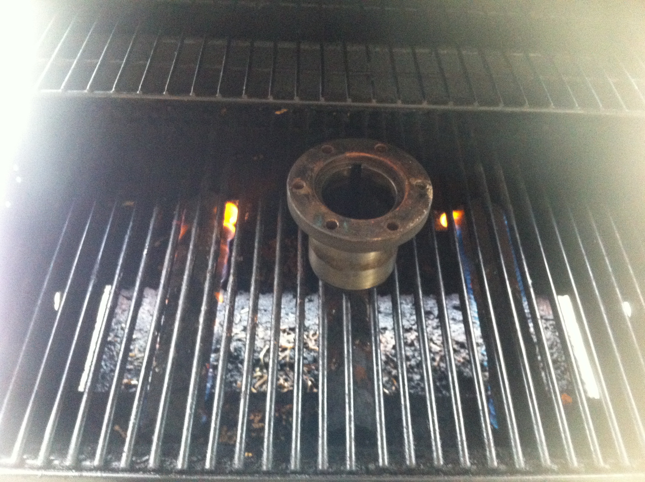

For reinstalling the front hub, I just put it in the oven at about 200* or so for about 1/2 hour(it didn't stink up the house at that temperature).  It slipped on effortlessly.  Don't want it too hot as it will overheat the seal and possibly distort it.

I just changed the front hub due to the 237 having a different set up then the 673.  I had to put my 673 hub/balancer on the 237.  I didn't heat the mount, only the hub for the balancer.  Like I said, don't over heat it as it could melt the rubber seal/mount after it soaks in.  The old manual I have says don't use a torch.
