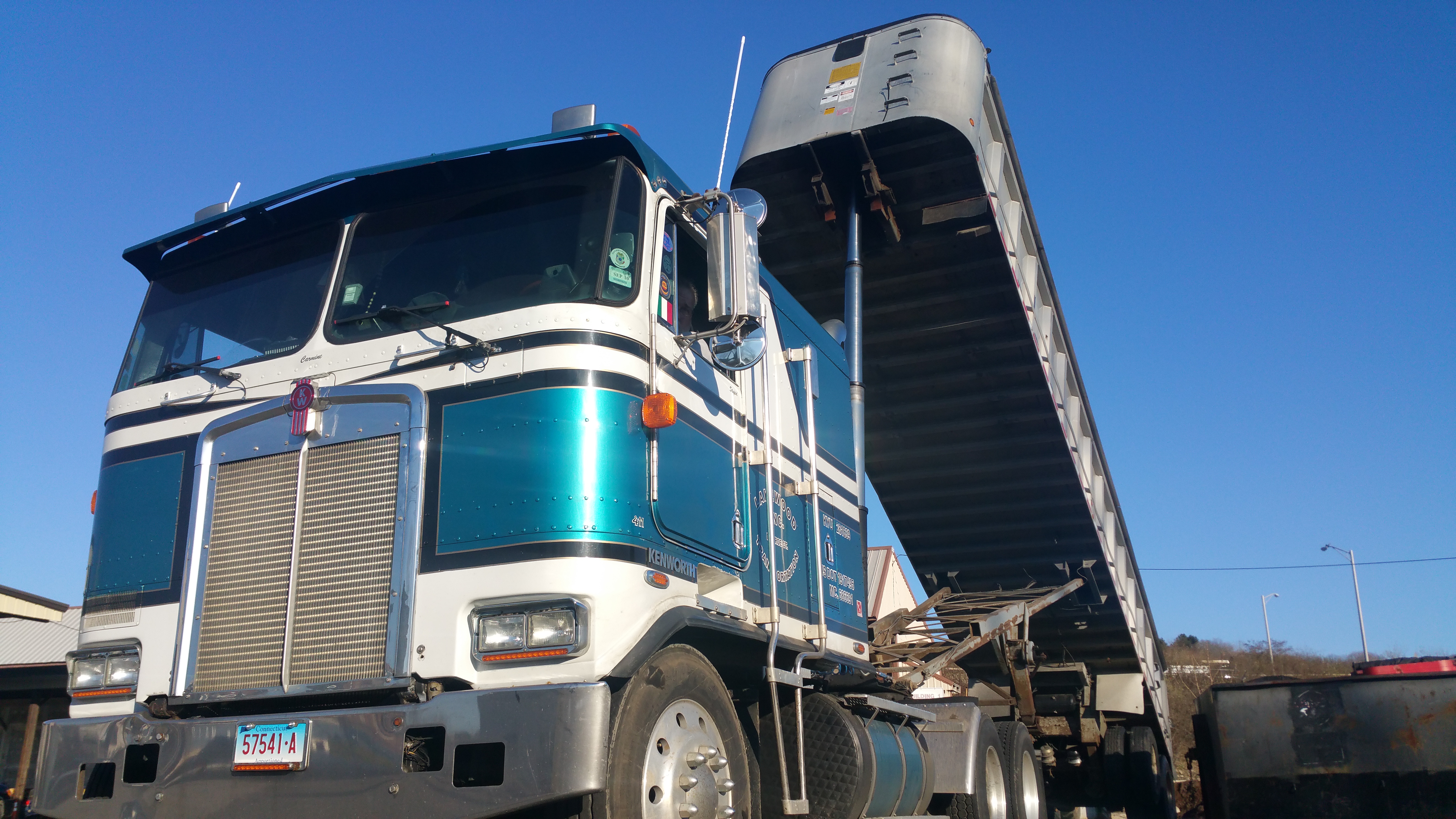

Im in the wrong buss after 35 years fix en mack I should go back to fixen them for profit not truckin that's pure robbery was that your trailer in New London with the coil it had the same name but from WTBY
I know it man, it's insane. Unfortunately not my trailer. I actually should of kept my dump trailer and cabover..*sigh*
