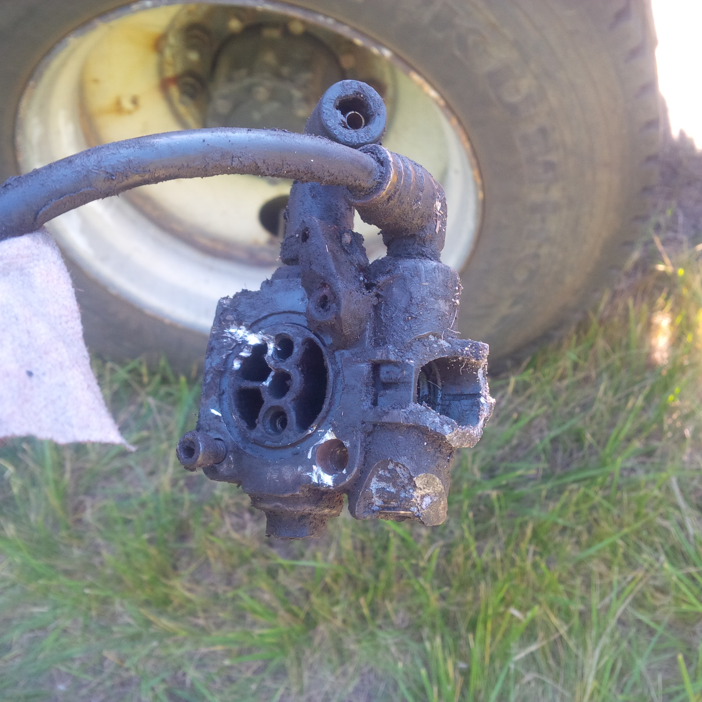

It took all of 1/4 mile to go from "crap...that vibration don't feel right" to (BANG) (hissssssssssssssss) "CRAP".
Yolk on the short shaft let loose, sending the shaft a-twirling around. Put a good size ding in a shock (amazingly enough avoided the brake can), ripped holes in the front 2 air bags (setting the truck down hard enough to bend the upper brackets that hold the bags to the frame rails...luckily, new bags come with 'em), obliterating the leveling valve and mangling its bracket (which I was able to straighten). Anyway, they patched the air leaks on the side of the road so I could limp it to their shop, where I show up today and they were all standing around with their thumbs up their butts..."storm knocked the power out". Whatever. My brother (shop is MAYBE a mile from his house) gave me a ride over to Mack to get the other airbag we needed) only thought we needed 1 at first) and when I got back, nobody in sight...so I got to work. Had everything done except the driver's side air bag and leveling valve done before they came out and said "I don't care if you want to keep working, or if you want to stop and let my guys finish it, but I can't have them working along side you.". Whatever. I'm not paying for MY time spent wrenching, so if they don't want this truck on their clock, that's fine...but I have to get back on the road. "I know. Every truck in here needs to get back to work, but I'm short handed and..."

Anyway, trying to figure out how the air lines are plumbed into the valve. 5 ports. 2 marked "I/E", one marked "C1", one marked "C2", and one labeled "Dump".
That last one is easy enough to figure out. I'm assuming the I/E ports are the outputs to the airbags. They ran the supply line to C1 to get it back to the shop yesterday, and the valve seems to be working...so in theory, all I need to do is run the line to the front bags off that 2nd I/E port, leaving C2 plugged. Does that sound right? Not much left of the old one to go off of...

Nevermind...figured it out. I/E gets supplied on one side, and exits the other. Dump is for an air supply from a dump switch. C1 & C2 were for the lines to the bags.
