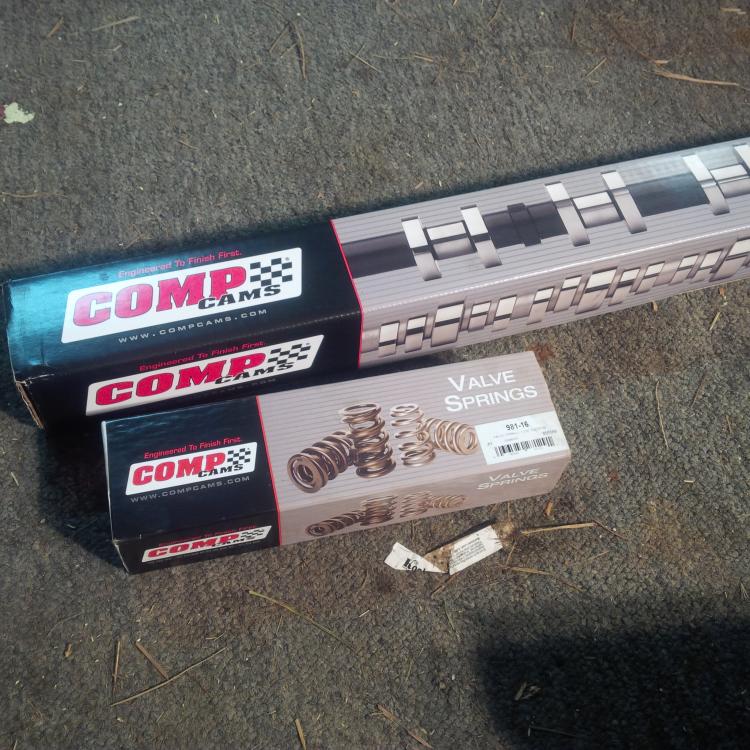

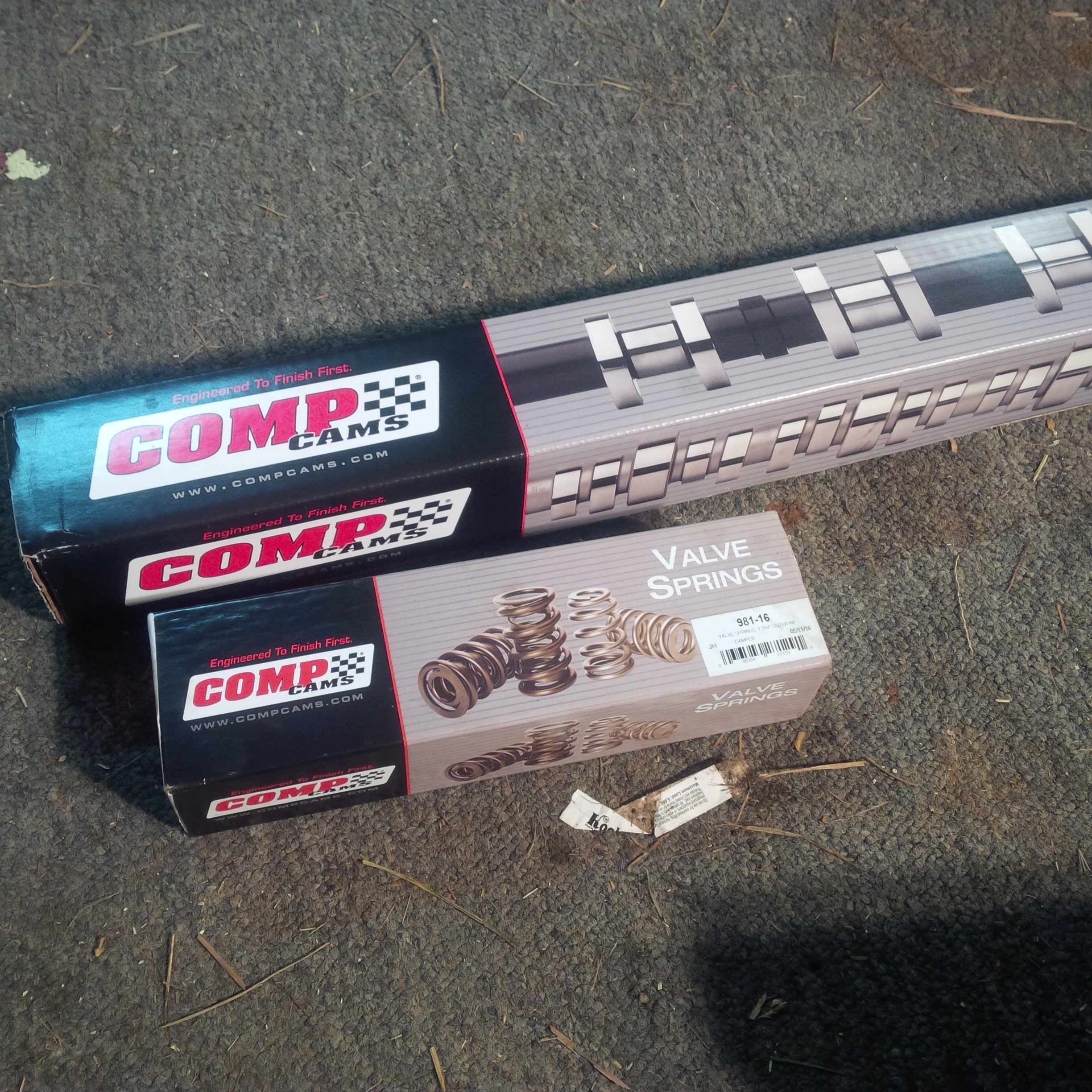

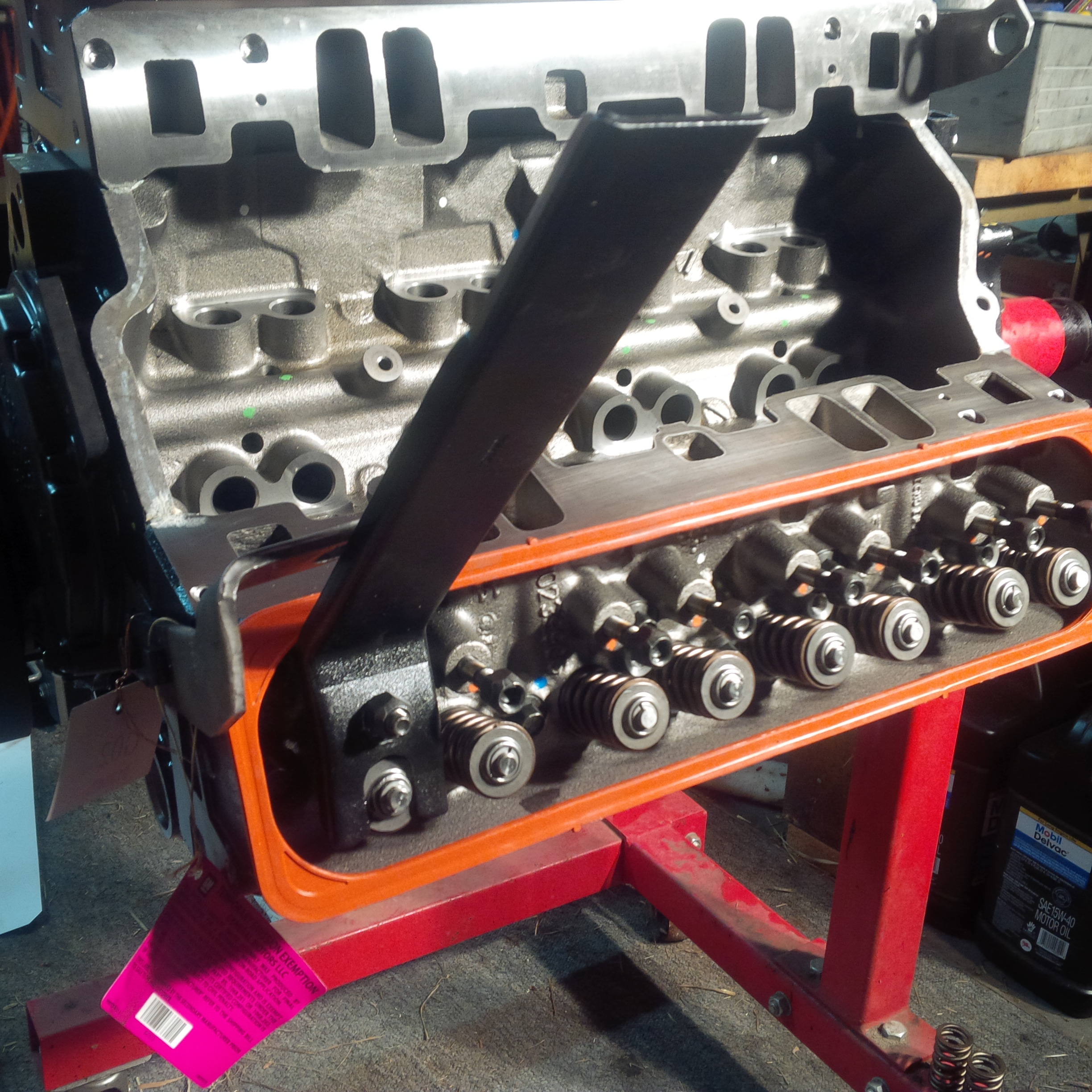

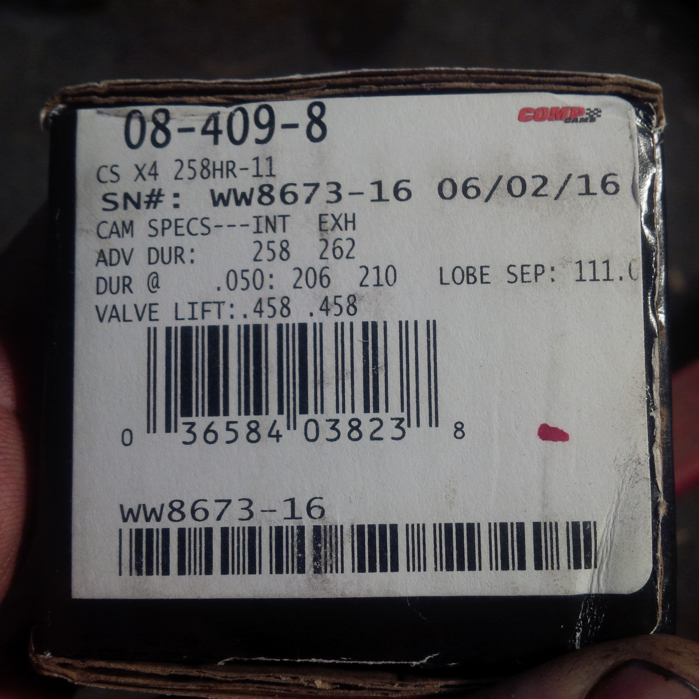

Long block 350 (VIN R) for 1995-2000 Chevy/GMC 3/4 to 1 ton trucks. VORTEC heads (and bought the intake that my 1990 throttle body will bolt up to)...going to do the swap tomorrow. Prep-work tonight. Should bump the power up by about 50% from where it was with that VIN K engine. Block was the same from '86-early 2000's, so it shouldn't give us TOO much trouble...
Well, I THINK I finally have everything I need to get it back together.  Had an issue with the water pump...Vortec heads block the thermostat bypass tube in the block, but not realizing that and thinking it was a BLOCK issue, I figured a water pump from a newer truck (that this particular engine would be a direct drop-in) would be needed.  Nope.  So, had to return that pump and pick up another OEM water pump for a 1990.  Turns out there's a pipe plug in the housing that can be removed to run a 5/8" hose to one of the fittings on the intake manifold.  If the vehicle's heater core doesn't have a valve somewhere in that loop that closes whenever the heater is turned off, that COULD serve the same function....but since I don't KNOW, I figure it's best to run the bypass.
Then there was the whole engine mount deal, where the mounts it HAD were pretty well shot....not much rubber left to 'em.  So, I had to pick up a couple of those today, too.
Then there was the issue with the crank position sensor (which the new block has the hole for in the timing cover, but the old truck doesn't have a wire to plug into it).  I was debating about buying an el-cheapo CPS to fill the hole...but when $65 is the cheapest I can find, well, gotta go to plan B.  I'm thinking of using some fiberglass resin I have left from fixing a crack in the horse trailer's roof to fill the hole.  Can trim the plastic plug they have slipped in there so that it keeps the oil off the fiberglass, and basically fill it in...or epoxy...or anything of the sort....and do it a heck of a lot cheaper than $65.
Picked up some longer bolts to press the harmonic damper back onto the crankshaft as well....the one O'reilly sold me yesterday was too short (2-1/4")...so I swung by the local farm store and picked up some 7/16-20 grade 8 bolts that are 2-1/2", 3", 3-1/2", and 4".  When all is said and done, the 2-1/4" bolt may be what I need...just can't get the threads started to press the damper back on.

Drove it to town today (all I did yesterday was around the block a couple times) and got a "service engine soon" idiot light coming on...which I halfway expected because of the new intake, heads, and cam this motor has that the last one didn't.  Still unimpressed with the seat-of-the-pants feel of this motor over the old one, but may have to find a chip or someone who can tune the computer so that it knows what it's working with.
