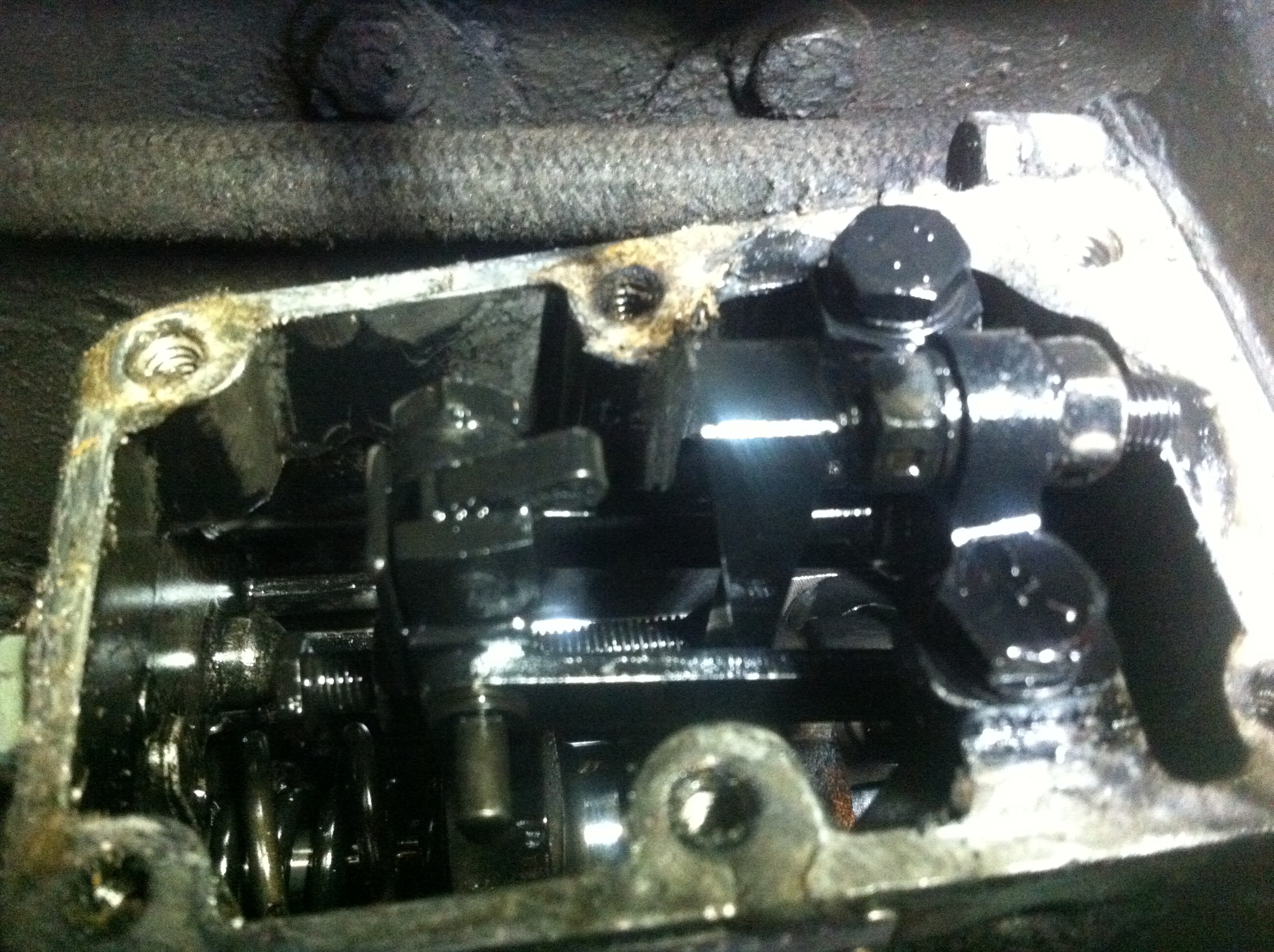

On June 29, 2016 at 0:30 PM, fjh said:
Remove the 6  or 4 bolt cover at the top back loosen the rear 5/16 nut 1 half turn tighten the front nut the same amount!
image.jpgThe 2 nuts to the right of the picture right?   Back the one on the left side of the arm off then tighten the nut on the right of the arm back against the first nut.

http://www.thedieselgarage.com/forums/attachment.php?attachmentid=11787d=1187814018              I found this link with pictures.    It is the 2 nuts I thought.    While looking in this part of the pump I still don't understand what's going on.   Or what I'm really adjusting but I'm glad others do.
https://www.bigmacktrucks.com/topic/45849-673na-fuel-pump/#findComment-338648
Ya, you got the correct ones.  It's all rocket science to me too.  It has to do with engine rpm and throttle position and that determines how much fuel it allows.  It is a real Rube Goldberg kinda thing and I'm not really sure myself.  Lord knows the new ones are likely much worse.  Some how they work?
