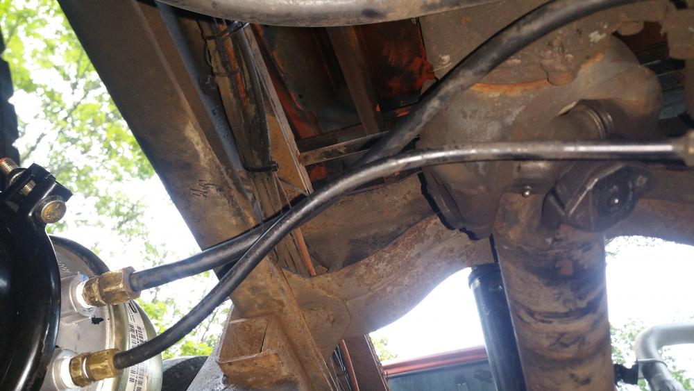

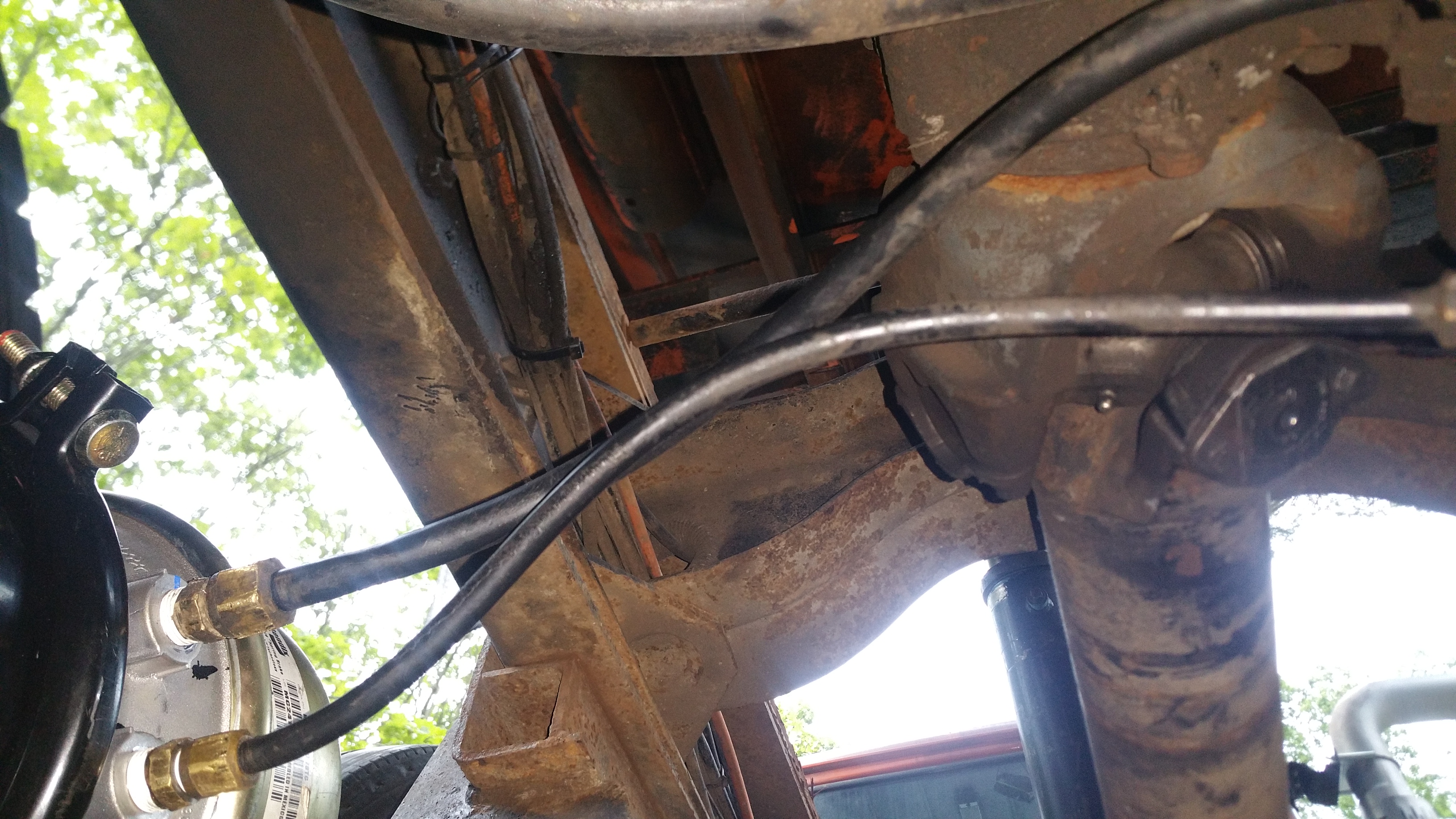

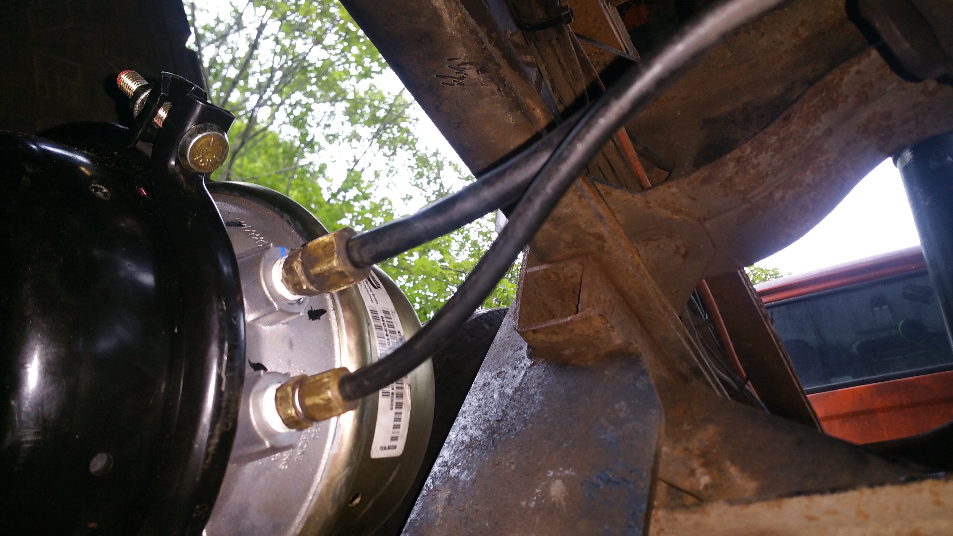

32 minutes ago, lakewood said:
Yeah rod is cut proper. Everything on it looks good but the push rod won't go into the can. Slack adjuster isn't even moving it
if you can`t  move the push rod in and out with some effort you must not have the spring end caged
  • 0
Guess n U installed the Can with the brakes applied
Chok the truck from rolling hook up the brake release pipe n release the parking brake
th@ way it will suk in the push rod
then U can adjust the slak adjuster n compare it with the other cans n stroke of the push rod
Hope U aint cut the push rod tooo short as they normally cum with a mile long push rod for U to trim to desired length
BUTT
WaddaEyeKno
LOL
cya
