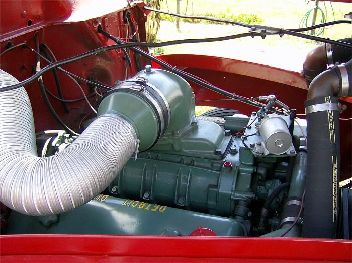

I have spent some time in a B model with a 8 71 in it still had the Quad box , The B model had the cast radiator up front never over heated even in Australia's hot climate and it drove ok no problems at all that I can remember except the noise
Was told by the fella that owned it that it came new with 8 71
The fella that owned it had it on float work shifting his road building gear about
and it looked like this had the air start fitted as well

Back when, the 2-stroke Detroit Diesel was certainly the most popular engine in Australia.
Yeah Australia had real love affair with the leaker Swishy still has LOL and despite what a lot of people say on here they were and still are a great little motor and for 99% of all work done even today they still get along ok but as we say "you gotta drive em like ya stole em" LOL your busy stirring the porridge all day
Think about this they used the 6 71 and 8 71 on road trains with gross weights in excess of a 100 ton would have been a very steady drive for sure but they got there and they used to get a million miles yes miles on them out here now for our crappy conditions and the weights they hauled thats pretty impressive and figures and B model Thermodyne could rarely match
