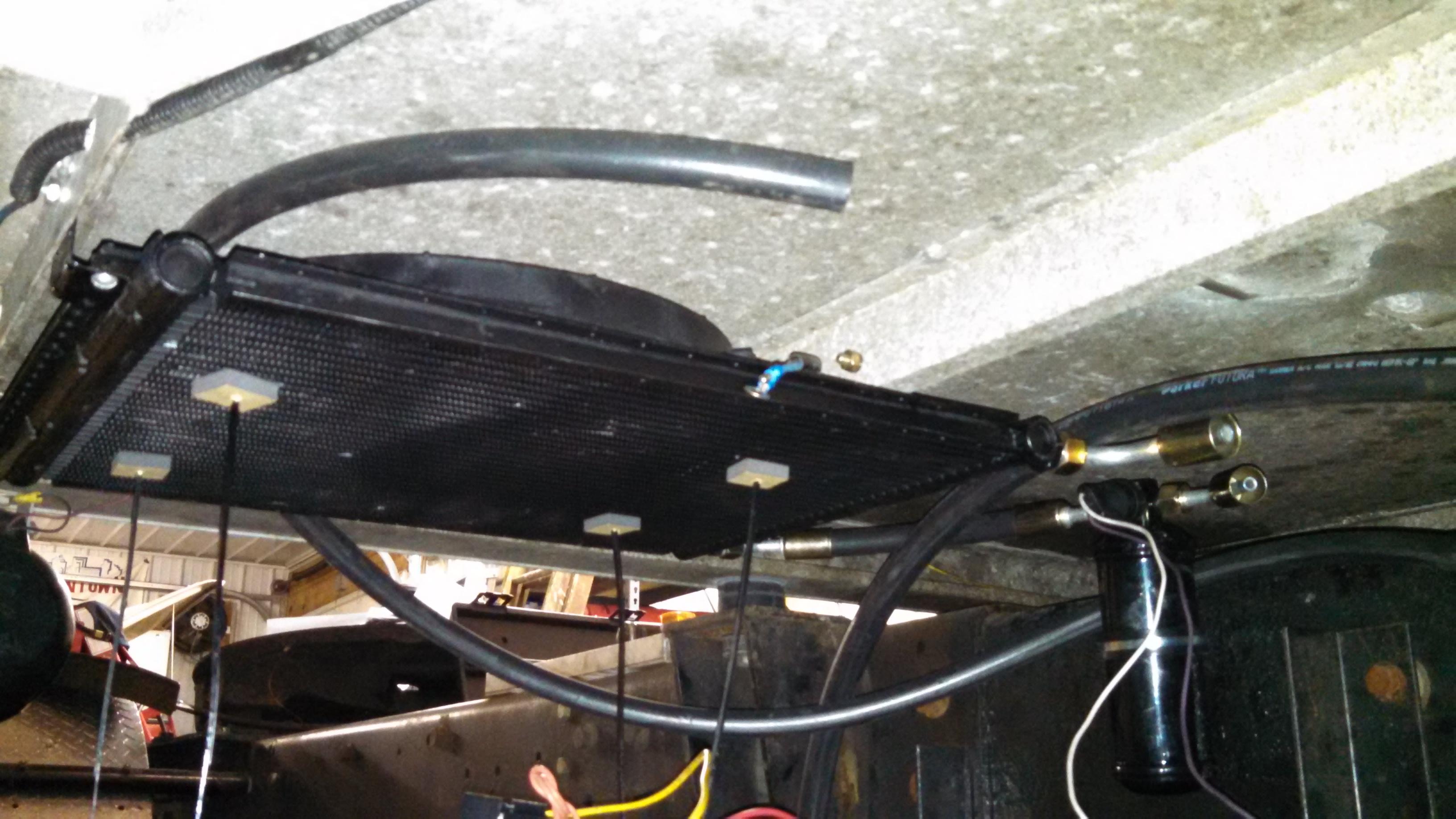

Condenser mounted under the bunk with a fan on it.

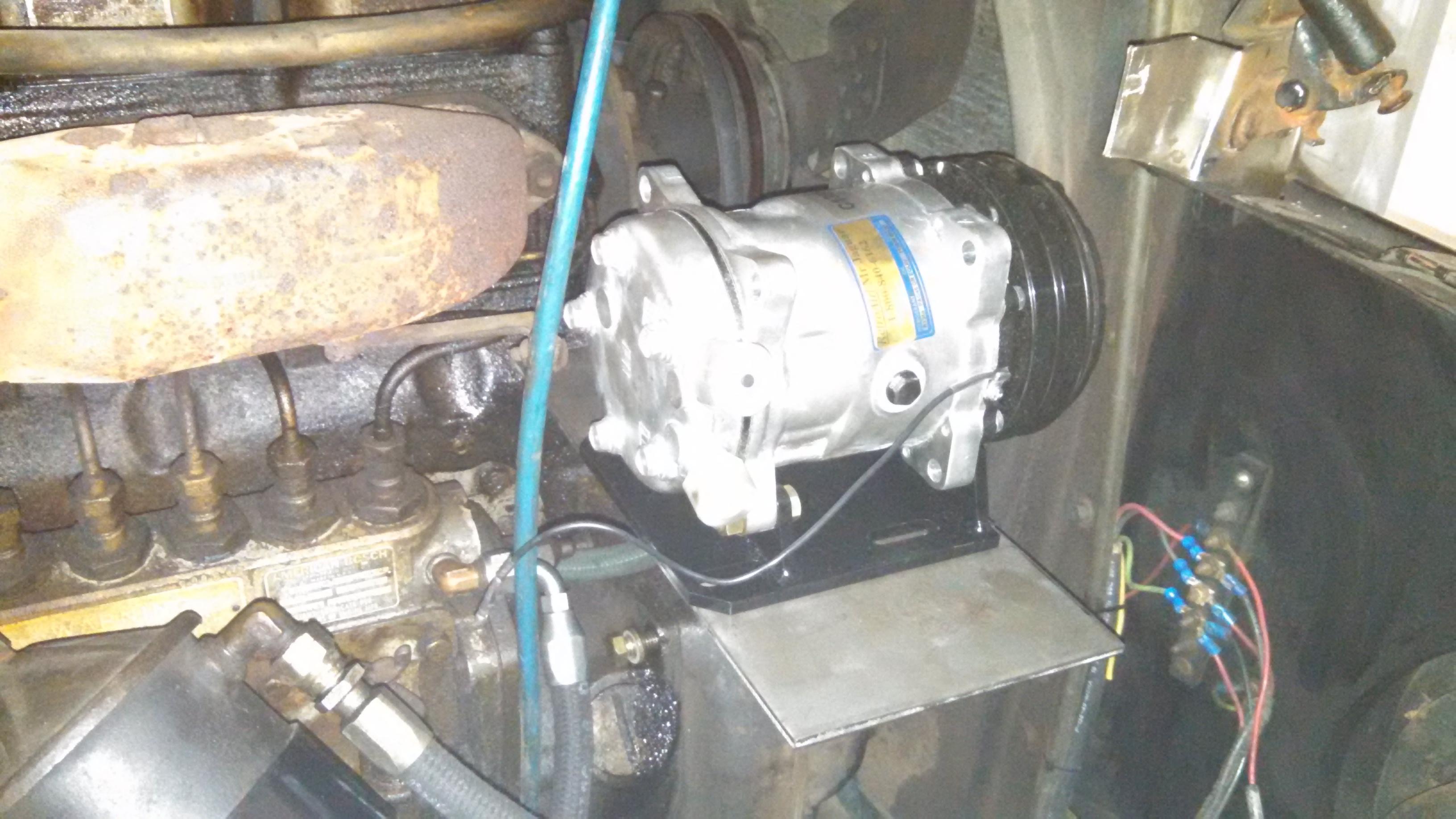

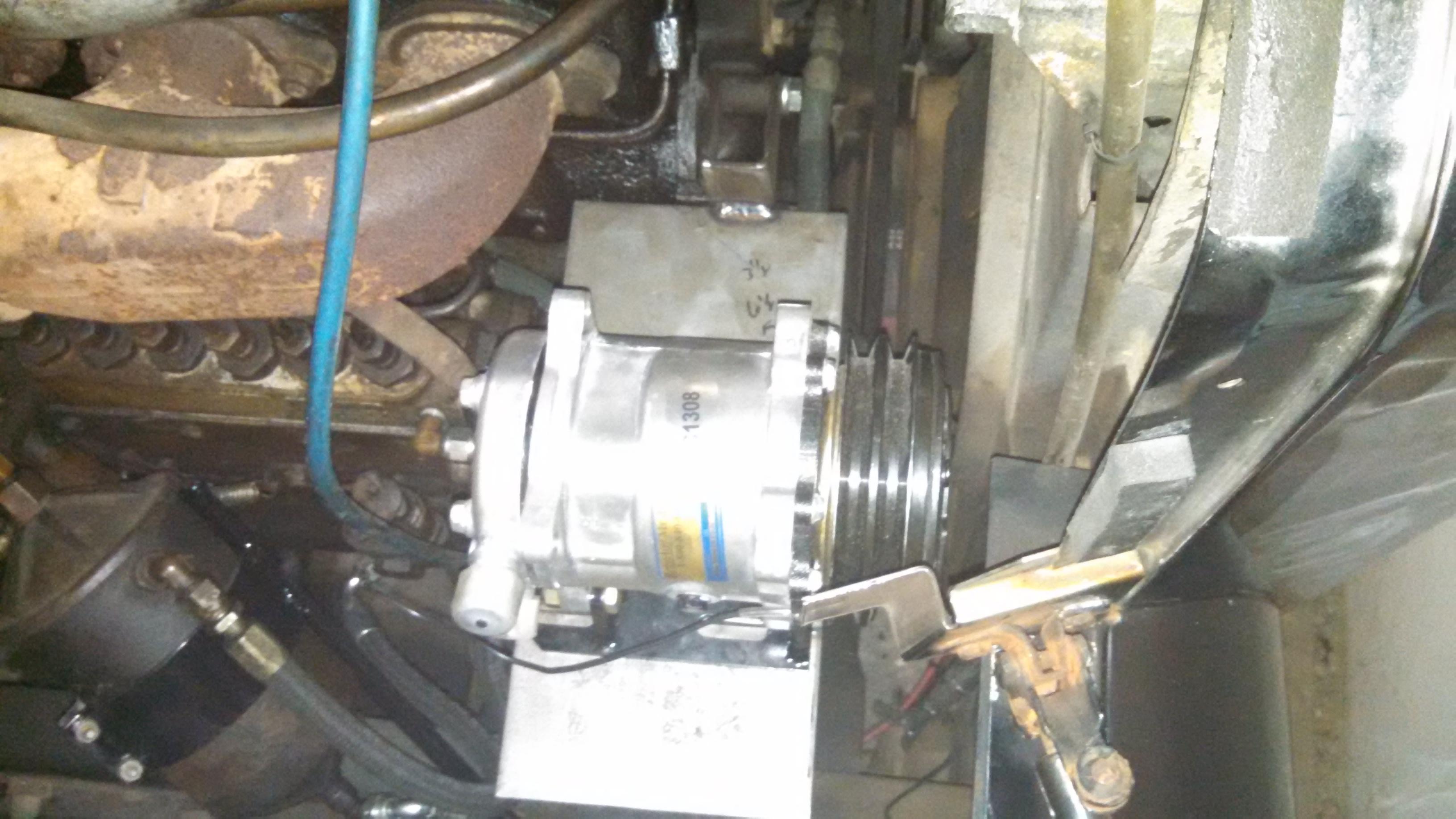

How did you mount the compressor and what did you use, pictures would be helpful?
I have a  1960 B95 Mack with a 707C gasoline engine and want to install an A/C unit in it.  My major problem is mounting a compressor.  Can anyone send me info and possibly photos of the mounting hardware and compressor for this application? Any help.would be greatly appreciated.

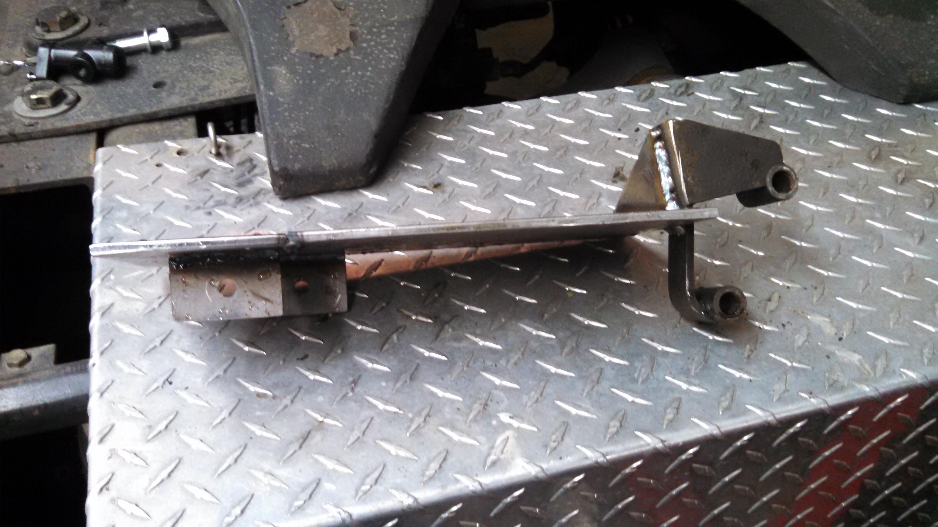

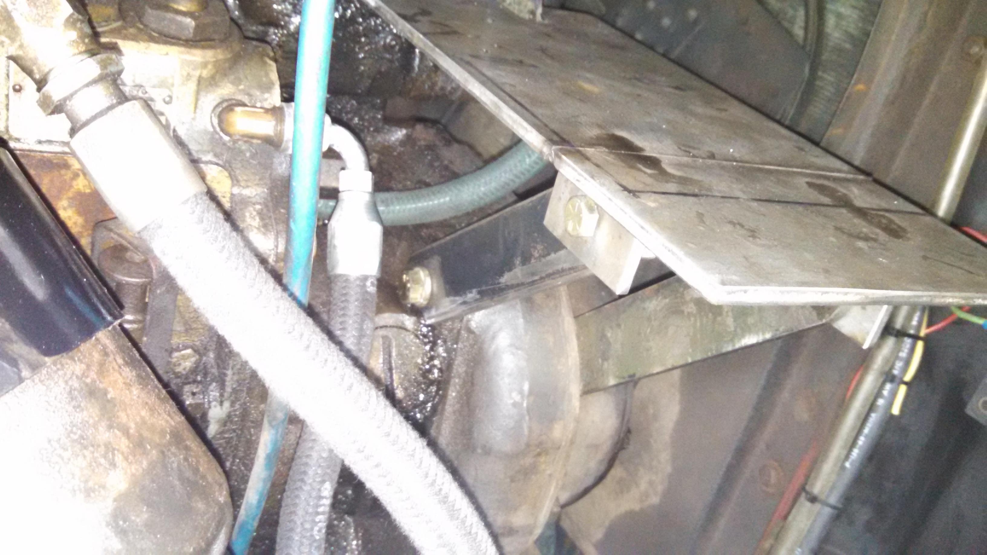

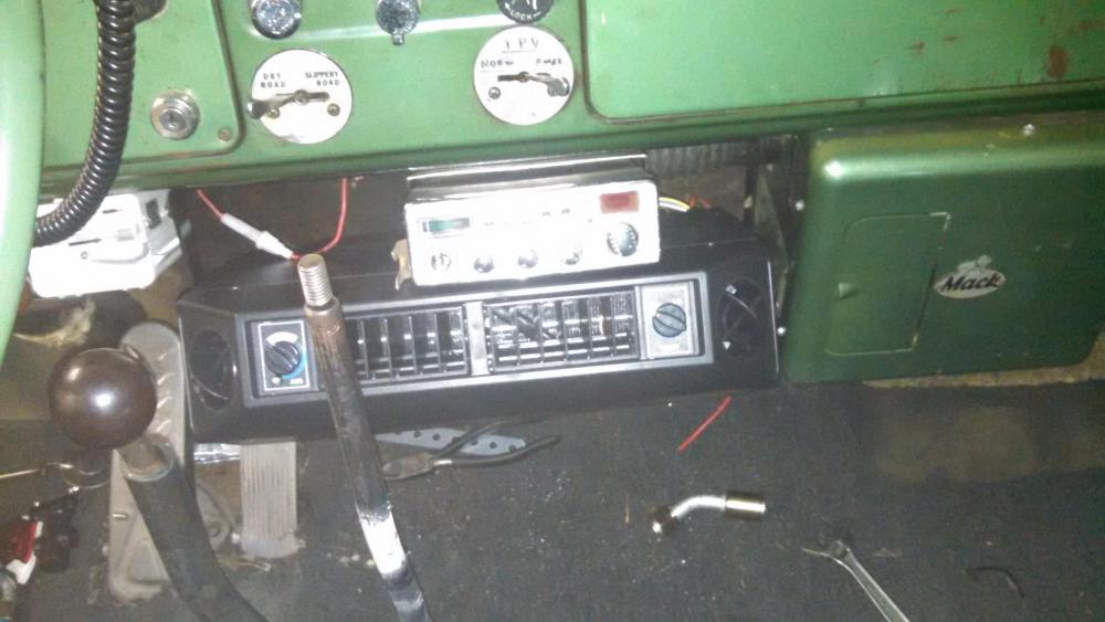

I closed my PB acct so lost all my linkable pics.  Here are a few.  I duplicated what they do with an R model basically.  The condenser is under the bunk since there is no place out front to mount it.

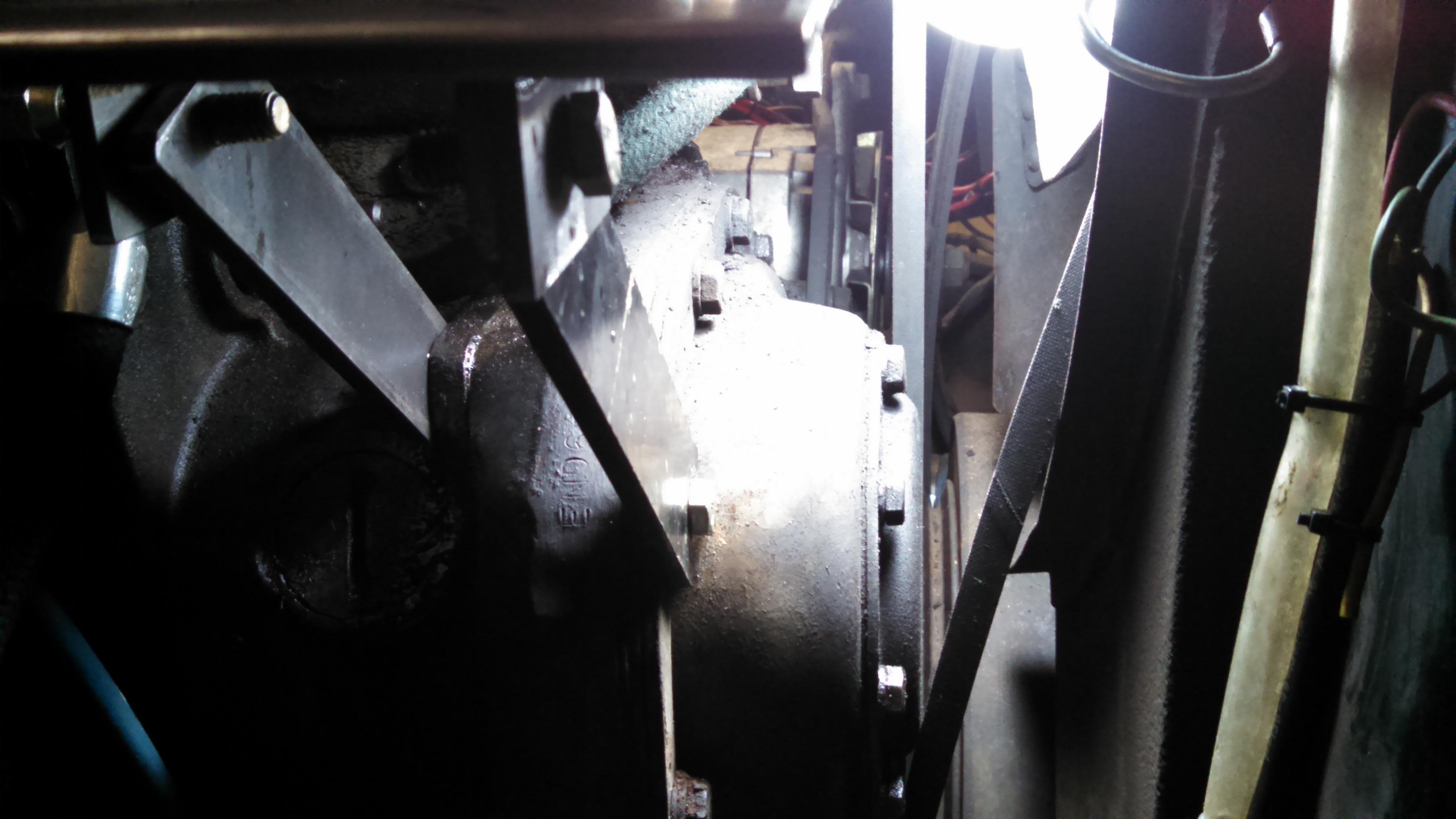

I am familiar with the black bracket the compressor is attached to.  What is the stainless steel bracket below it and how is it attached to the engine block? I could not tell in the picture which pully or pullies are driving the compressor.  Thank you for the photos Sir.
The lower bracket is homemade, using the original fuel filter mount portion.  I then ran two legs down to the accy drive to support it.  Rock solid.  This mimics what they do with an R model that has a/c.  I only run one belt, on the front pulley, as it won't clear the protrusion of the accy drive down below.  The belt just touches it as it wiggles around while running.  Never a problem, works well.  I had to clip the fan shroud a bit to clear the pulley on the compressor.
Ok, I see it now, thank you for the photos.
