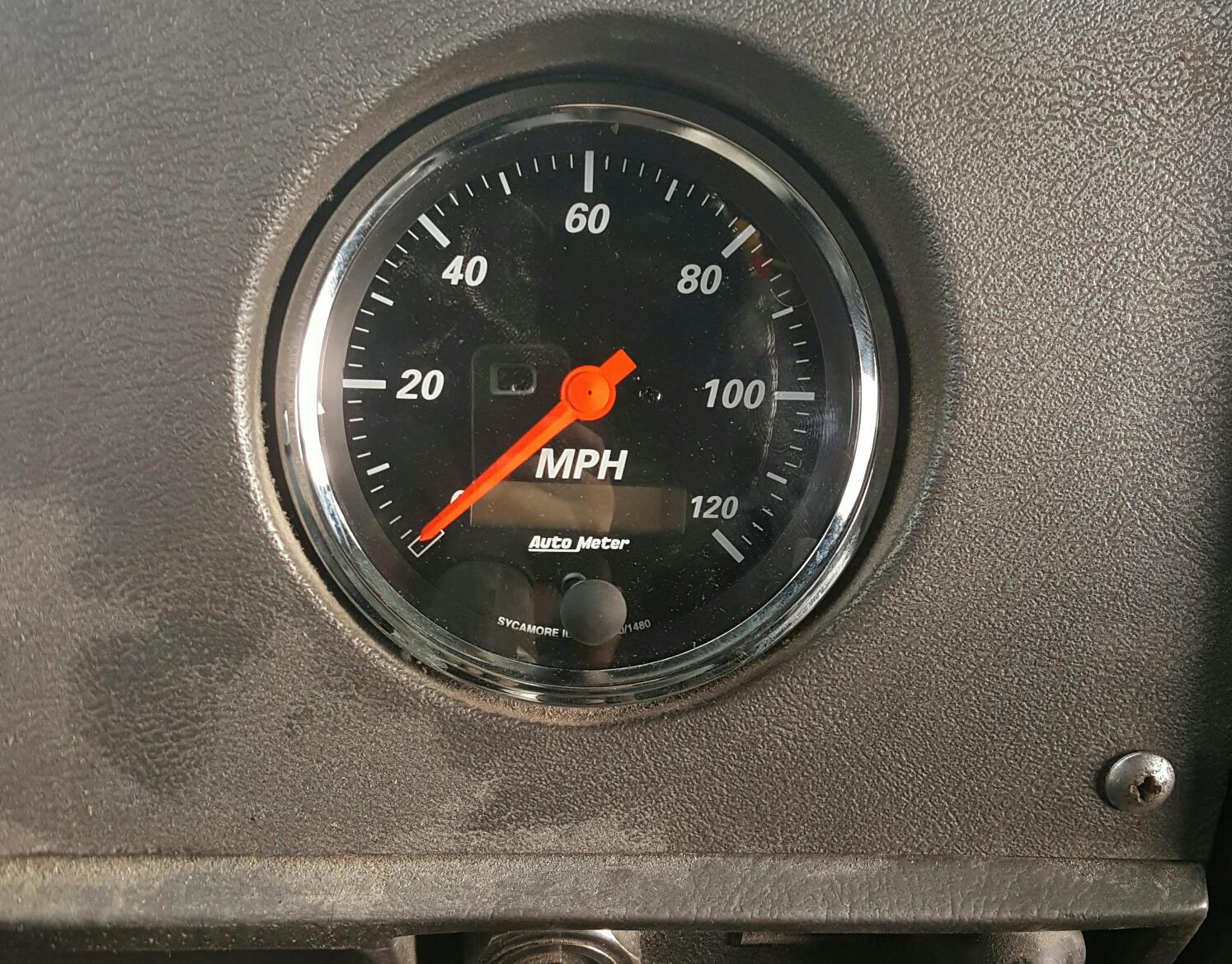

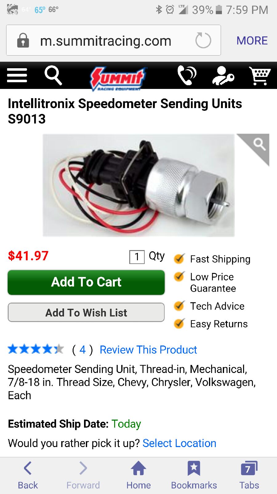

So I had the cable break on me taught no big deal.  Went to mack bought a new one $120 later installed it. Monday went to work lasted 8 hrs.  So when I got home started cruising Summit Racing's website found an autometer guage and a signal generator that'd screw into the trans.  Finally got a chance today to install it real simple and easy had to modify the the generator drive with the stock tang which went well and 5 wires to hook up and route

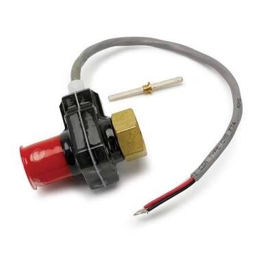

This is the one I used had to modify it with an original drive tang.  Cut it down and drilled a hole in the middle
The speedometer head is autometer part number 1480. Had to calibrate it basically find a measured 2 miles and drive it following the instructions on how to set it up

That look like it would fit better in my gearbox. I have a 4 inch extension and then a 90 degree fitting on my cable. Did you fit it in the gearbox or at the 90 degree bend?
Thanks a bunch for the link. I've ordered it already.
