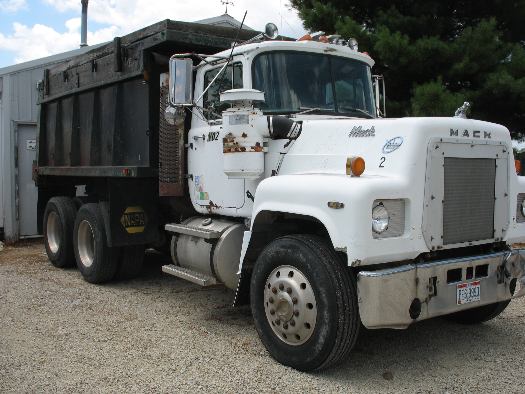

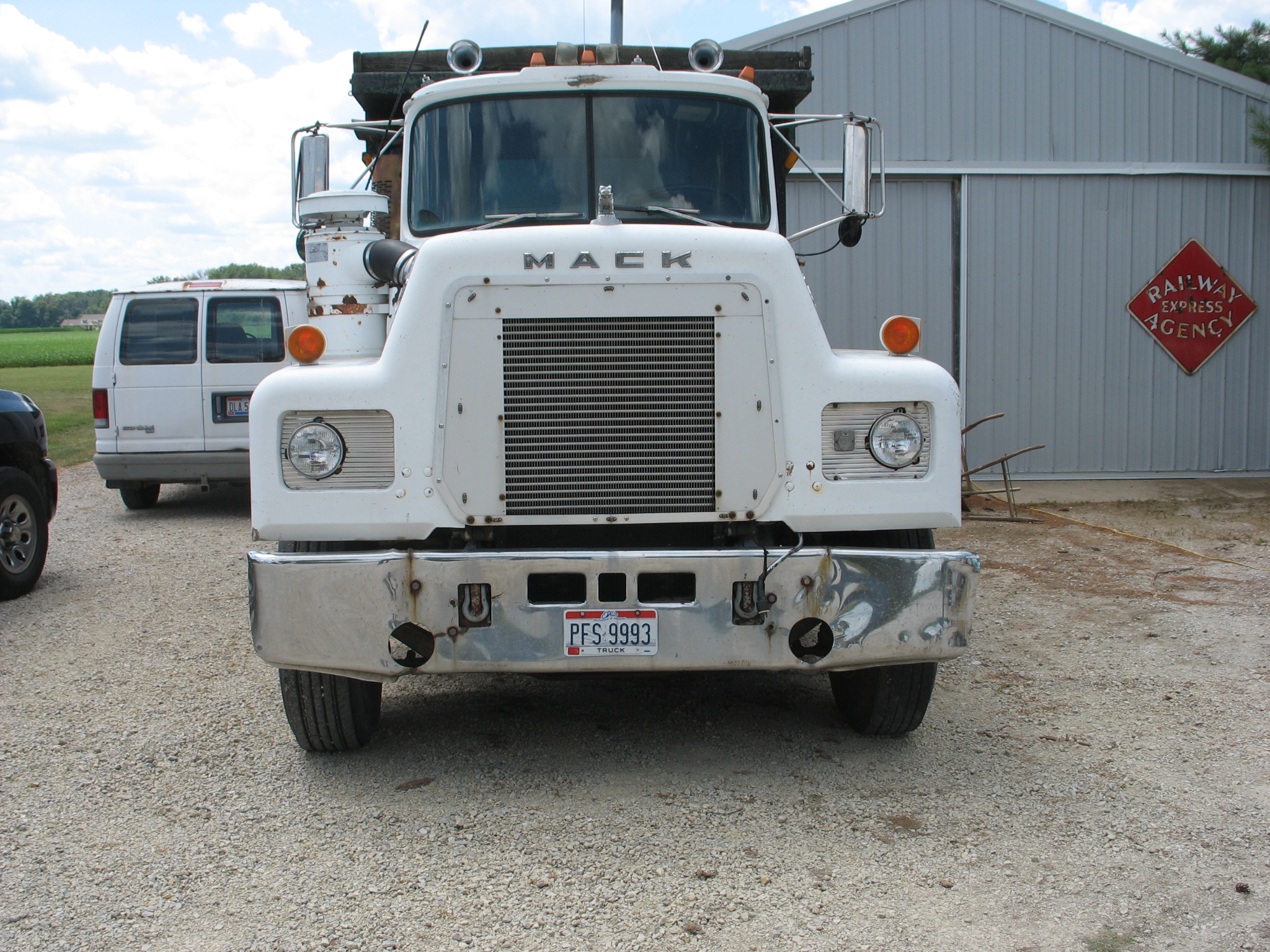

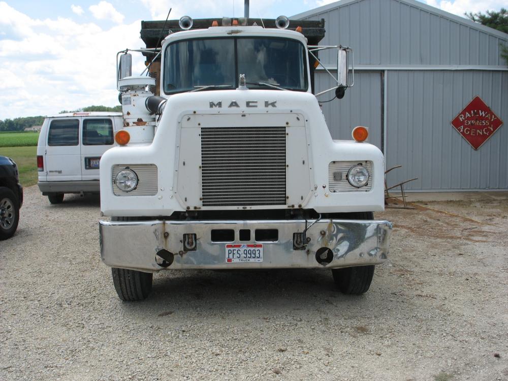

Have been looking for a dump truck for sometime. Something  I could  use on the farm.  Found this in a local farm publication.  RS688LST  1985  550,000 mi,  5540 mi on new engine.,  RR 9 speed trans. Do not know what engine. Was a road tractor. Asking $5000.  I think I will pass on it. More truck than I need. Any thoughts.
https://www.bigmacktrucks.com/topic/45995-mack-valueliner/
It was advertised in the Country Living monthly publication. The bed is 12 ft. Owned for about 15 yrs. by a farmer who is downsizing 1000 to 200 acres.  The front end has been recently rebuilt drives straight. some wear on rear tires. Phone # 937 492 1930. Located near Sidney OH.

On 12.07.2016 at 2:34 AM, kscarbel2 said:

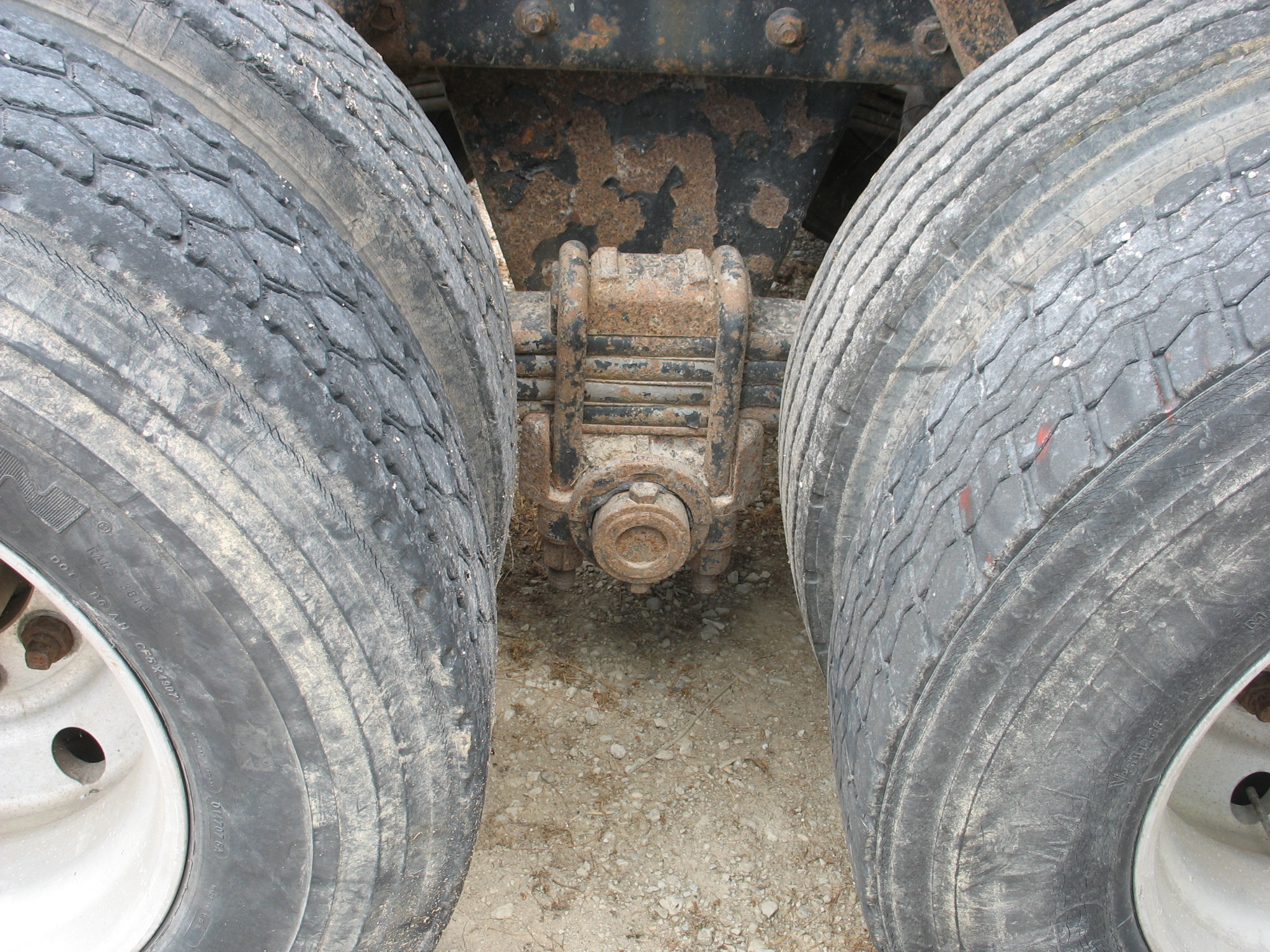

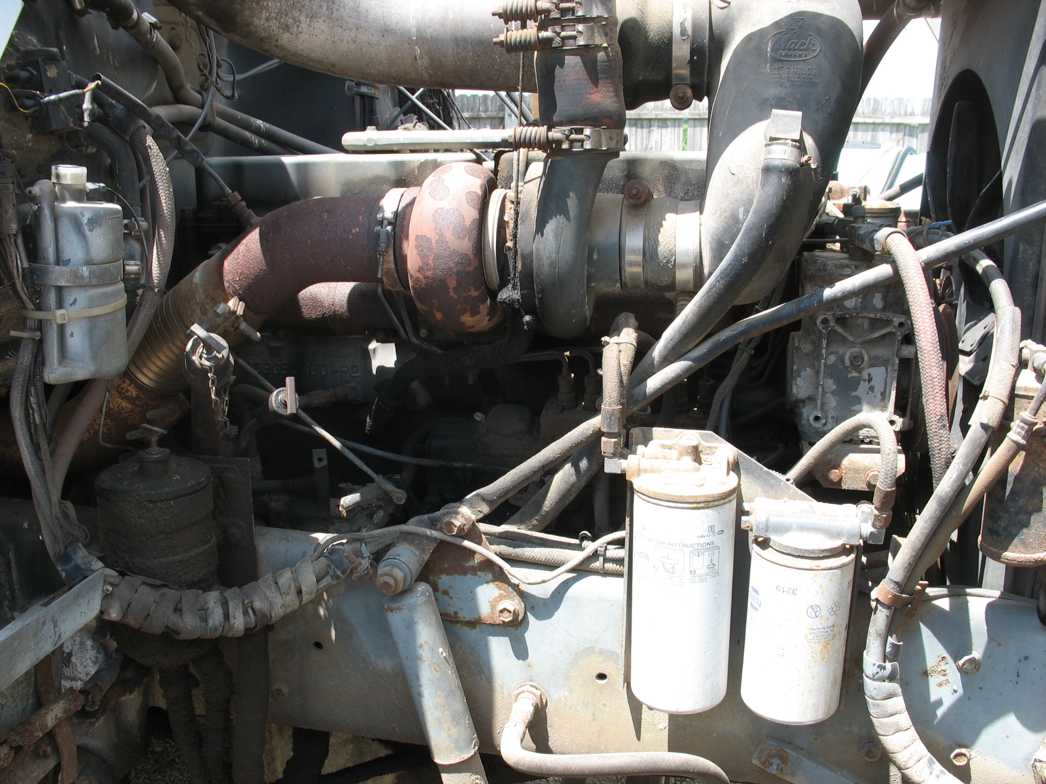

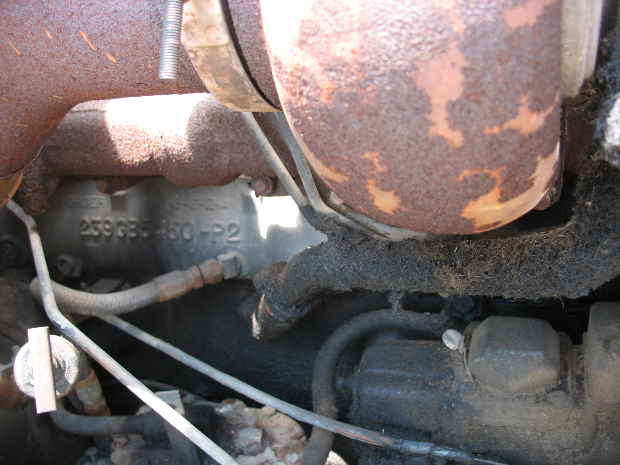

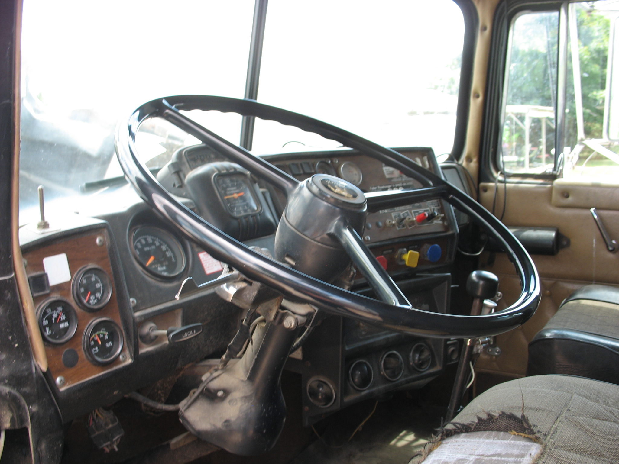

It's a Macungie-built Value-Liner (3-piece grille). That's an E6-350(R) 4-valve engine. The power passenger window (electric) is factory. It has an ST34 parabolic taperleaf rear suspension, ideal for a lightweight tractor, but wrong for a tipper.
If the truck was originally red, it could have been an Amoco unit. The horn button will reveal.
Wonder what did Macungie-built Value Liner have of the frame?
The straight rail design as on the Western trucks or the Eastern R-model frame with wider spread at the front?
From the pics above it seems to me more like Western RS/RL rails.
RS would be a straight frame.
