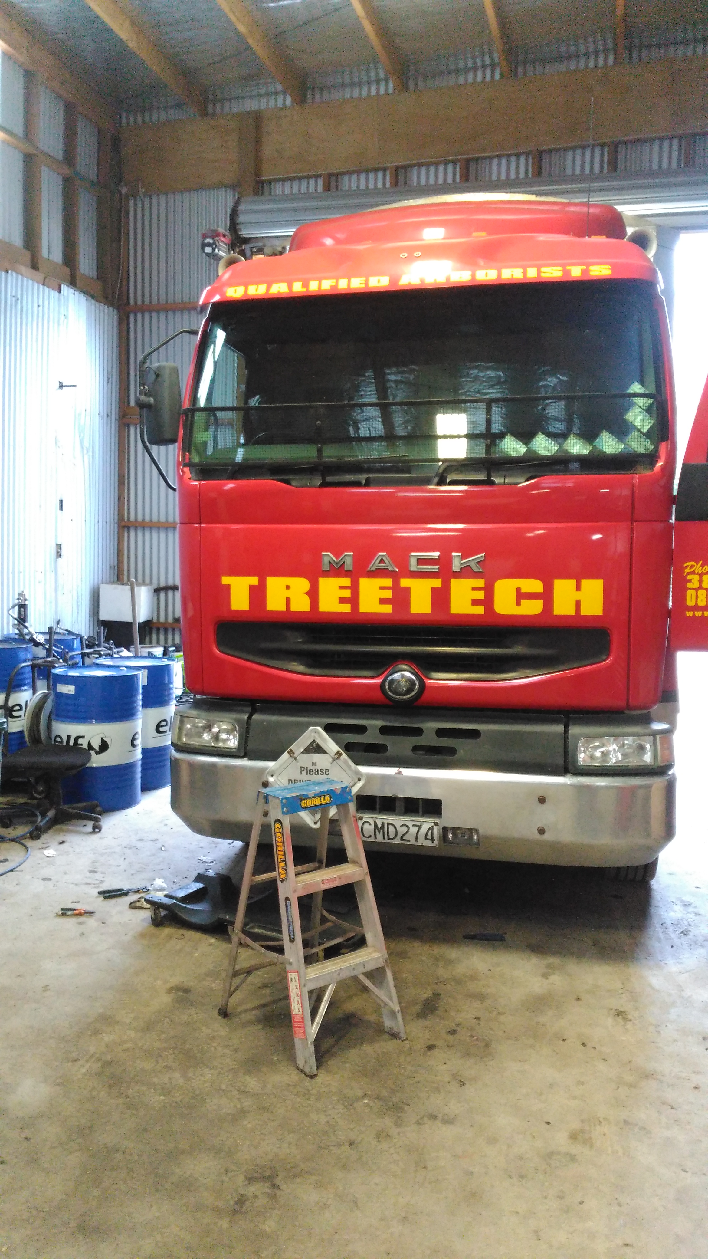

"in general practice", the two fog lamps will be off one feed and switch, if one is working and no voltage on the other you may have a open circuit on that side... trace back to where the left and right lamp wires join, probably around the bumper area.... should be a simple job for a local auto sparky.
your truck is not well known to north americans, locally assembled in NZ from Oz??... interesting "Renault" Quantum cabover....

Yes it is a mack/Renault made in France. Thanks for your tip on the fog light. Found the fuses and all good. One feed for both lights.
