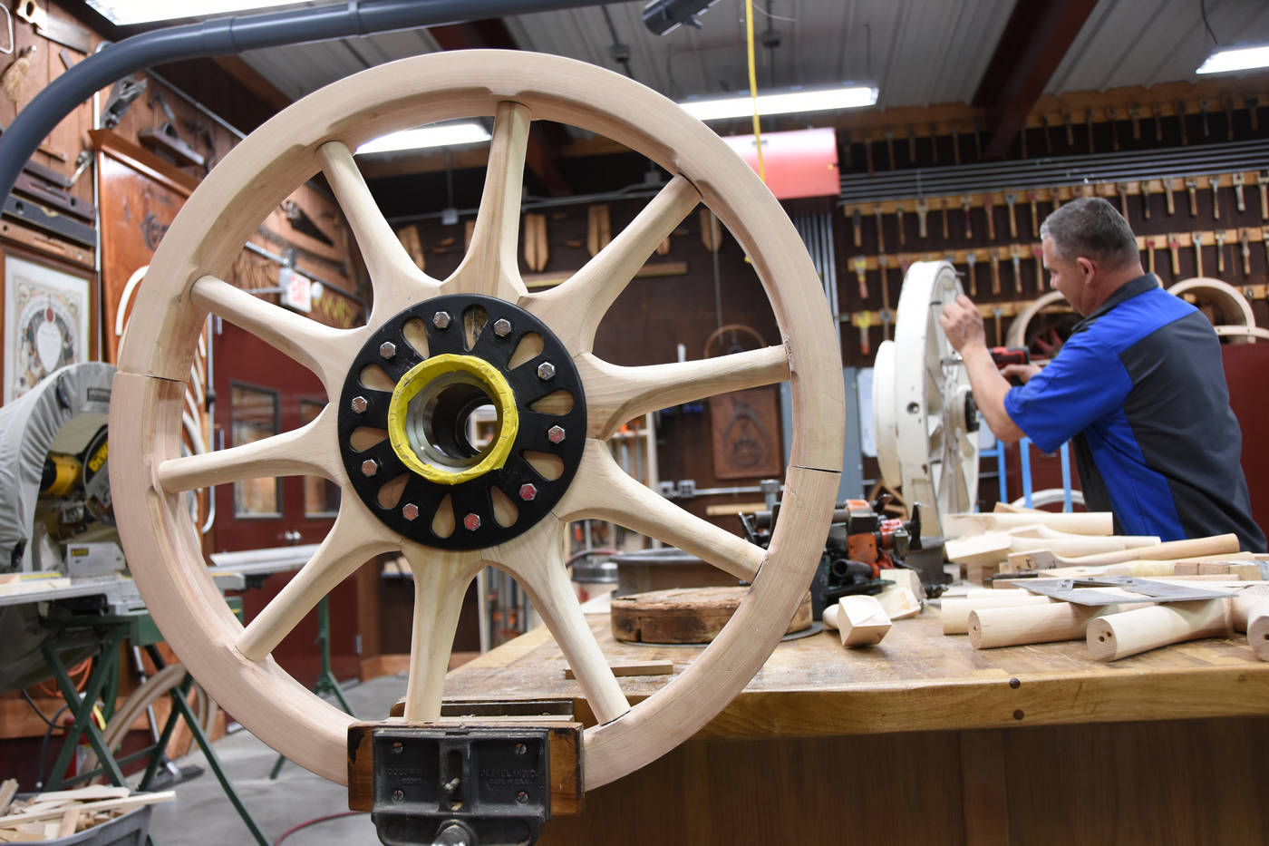

Coker Tire will build new copies of your existing Spokes. I'm going to talk to them in the fall about a set for on of my AC's.  Interesting article one the basic method they use.     Paul
http://www.hemmings.com/hmw/how-its-made-wooden-wheels.html
https://www.bigmacktrucks.com/topic/46066-new-wooden-spoke-wheels/
