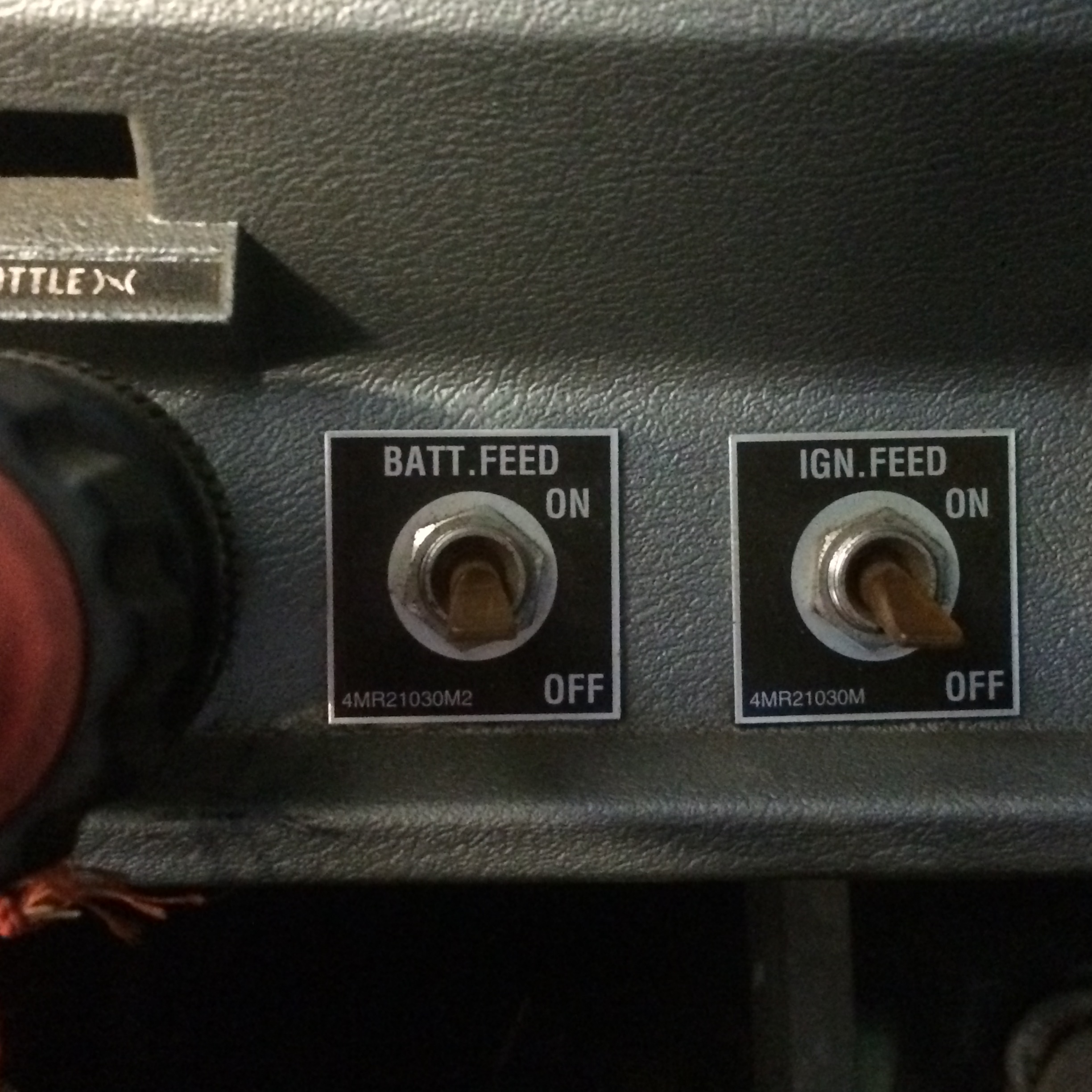

I'm going through this Mack I bought and there are 2 switches that are factory that I'm not sure what they do. I figured rather than trace wires I would just ask. Both are located next to the PTO throttle and both light up but don't appear to actually do anything.  Any help would be appreciated.

Those switches are an add on option when you order a truck. The batt switch will be hot all the time and the other is hot only with key on. The wires are in the dash in the center of the dash. This way Mack figures people won't be splicing into factory harnesses.
