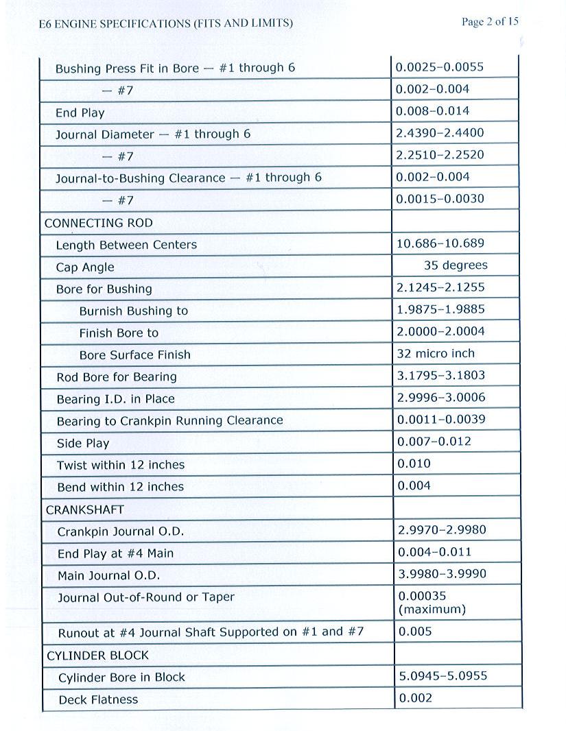

The bearings are stamped 8331 STD. One of it showed that it has been seriously scrapped including the crankshaft. So I need to under size the crankshaft to 010 or 020. But i need to know the diameter of the sizes so as  to help me know what am getting during the under sizing.

In theory you don't need to undersize the shaft to the exact figures. You may just undersize it to the grade the wear is gone. Then measure it and fabricate new bearings of brass/bronze stock of the size you made your shaft. If you can get factory bearings and keep the correct under sizes it sure would be better.

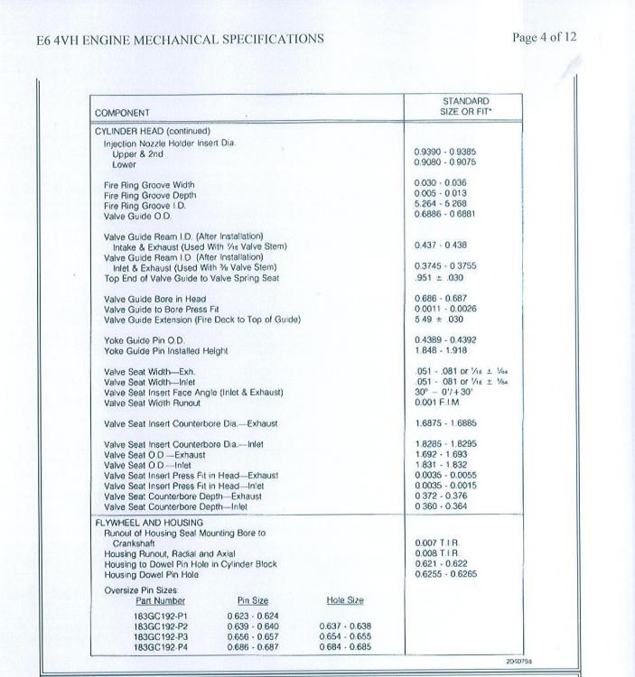

The issue now is the injection pump. The injector pump technician here only knows how to tear down and change the plungers. He does not know what is port closure even delivery rate and other injection terms so i need to be involved to get it to standard.
1. My engine plate reads 23° BTC but ambac injection Pump reads port closing at 21°. Is this 21° PC reference to engine flywheel or somewhere else. (I use degree wheel)
2. The governor of the amback injector seem to have been tampered so I need to find out the appropriate quantity of diesel to be delivered to achieve 350hp at the governed speed. My engine plate says fuel rate at advertised hp is 190 mm³ /stroke. How do I convert this to liters /minute. Is it per compression stroke and how many seconds or minutes elapsed during one stroke? Or is there another way of determining the quantity of gasoline to be delivered into the combustion chamber for appropriate performance.
3. I intend to use PRESSURE TIMING METHOD to check port closure. Where can I get 600psi pump. Many that i have seen online are less than 150psi.
4. Where can i buy overflow valve? The one on the truck does not maintain pressure. The ball valve seem to have warn.
