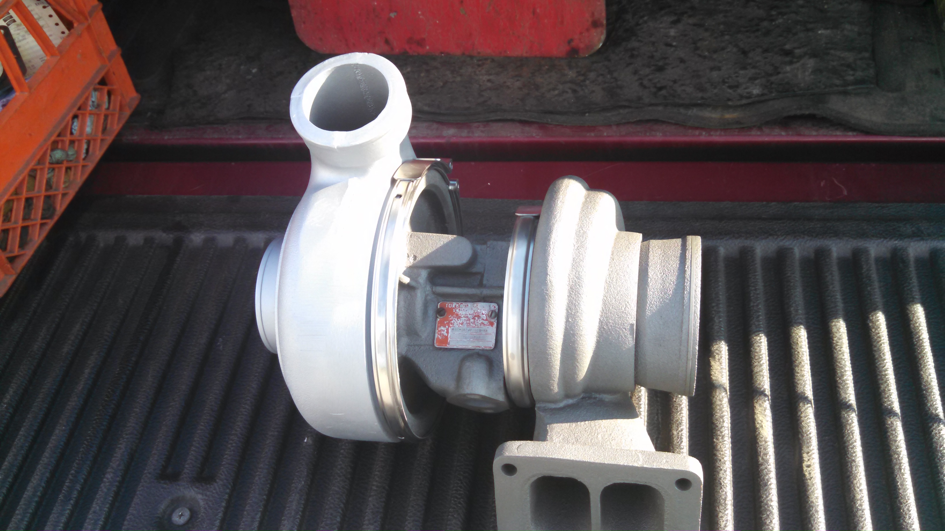

Well, got the turbo dropped off Friday afternoon.  They looked at it, it doesn't look terminal.  They are going to give it the once over, new bearings/seals, check balance on shaft, etc.  Should have it back mid week.
