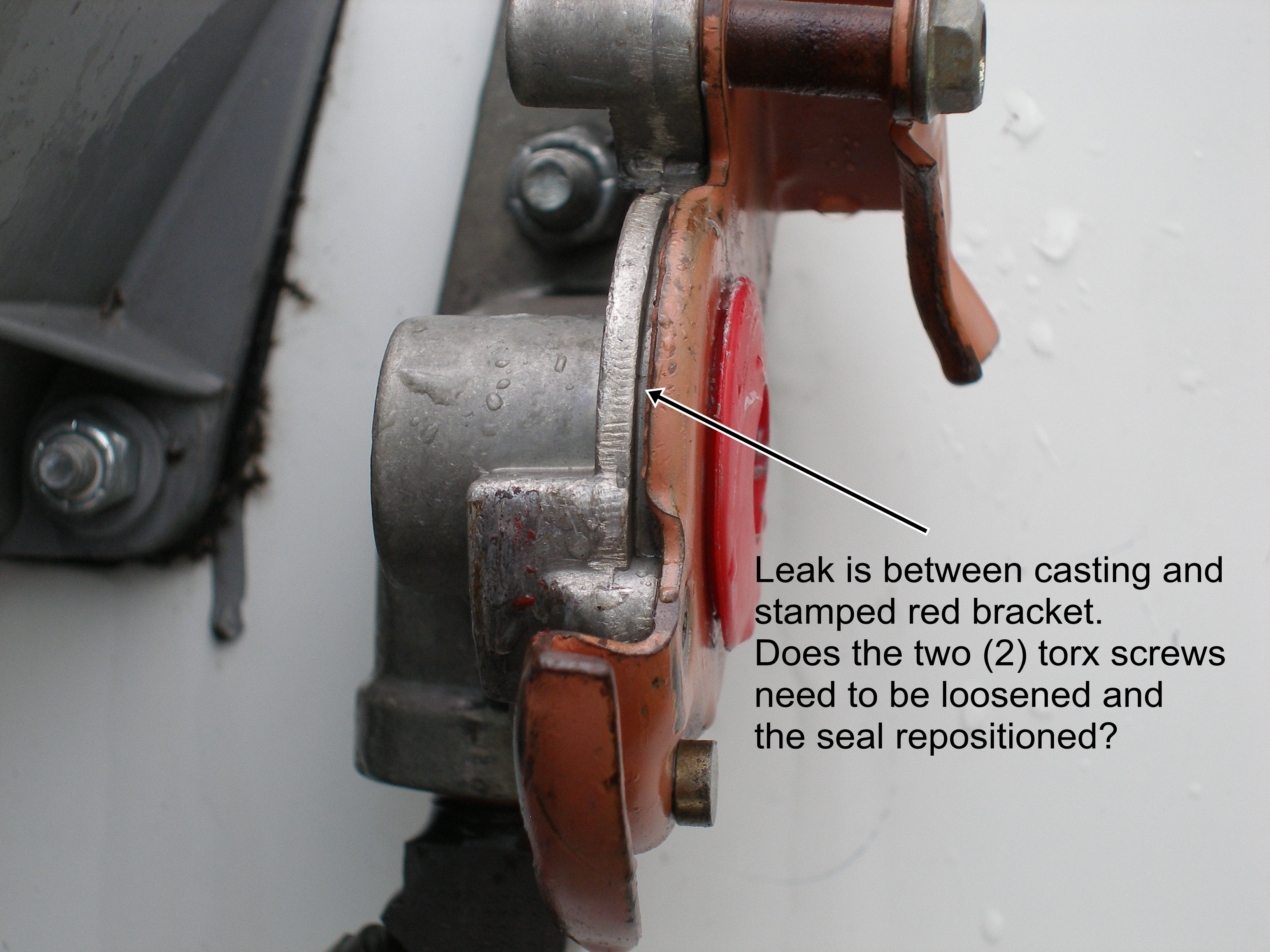

I think I found the cause of my air leaks.  First there is to be a check valve in the line from the RH primary tank to the LH tank (at the LH tank).  I cannot see one, unless it is an internal check valve in the line.  That might resolve my "parked" leak down.  Now for the big one, my moving leak (hopefully) is at the trailer gladhand port on the trailer.  I replaced the gladhand seals but there is still a major air leak behind the clamping mechanism (don't know the correct nomenclature).  Is there a gasket/o-ring between the stamped steel bracket and casting?  If so is it replaceable?  Or is the glandhand seal the "gasket"?  I searched the Great Dane parts catalog and Sloan but I do not see anything concerning a gasket/seal.  Anyone know what I am talking about?  Or do I need to replace the complete "port" on the trailer?  See attached pic, do I need to loosen two (2) torx screws and reposition the gladhand seal?
UPDATE: Being the inquisitive engineer I could not sit back and do nothing.  So I removed the torx screws and the hex bolt (at the top of the picture).  This allowed movement of the red bracket but not able to remove (round head rivet at the bottom of the bracket).  But I could see behind the bracket and there is no gasket.  I removed the gladhand seal, cleaned the casting and seal, used white lithium grease, and reinstalled the seal and screws/bolt...NO LEAK.  So now comes the road test on Friday.  Stay tuned for the continuing saga of "Roll Hauler Express Air Leaks".
BTW, I checked the tractor brake cans and there are no leaks.  In all the "excitement" I forgot to check the trailer.  I will do that on Thursday.
Ken

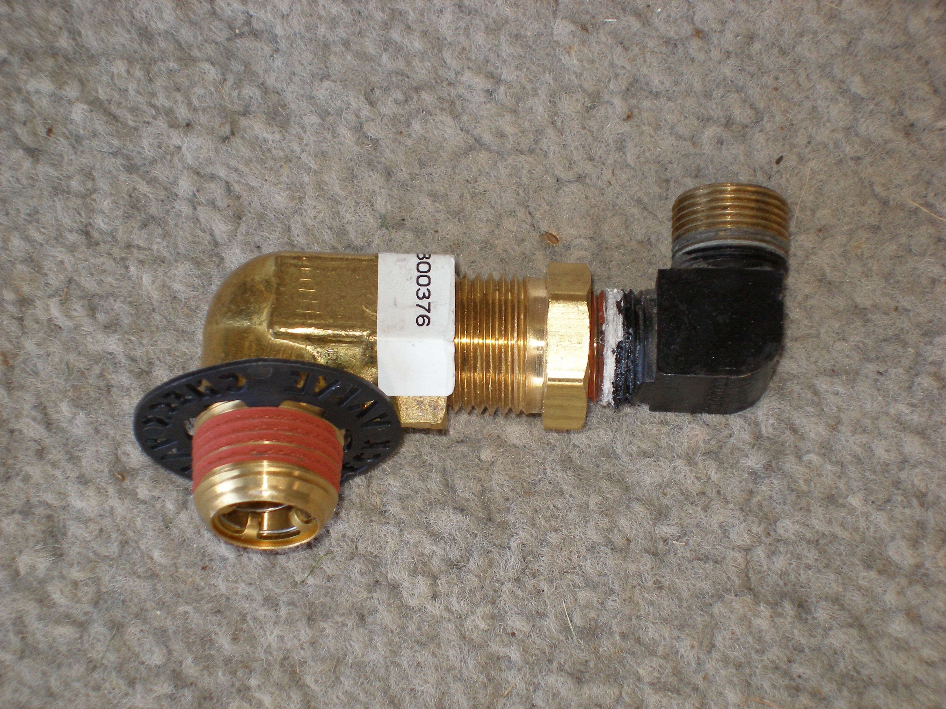

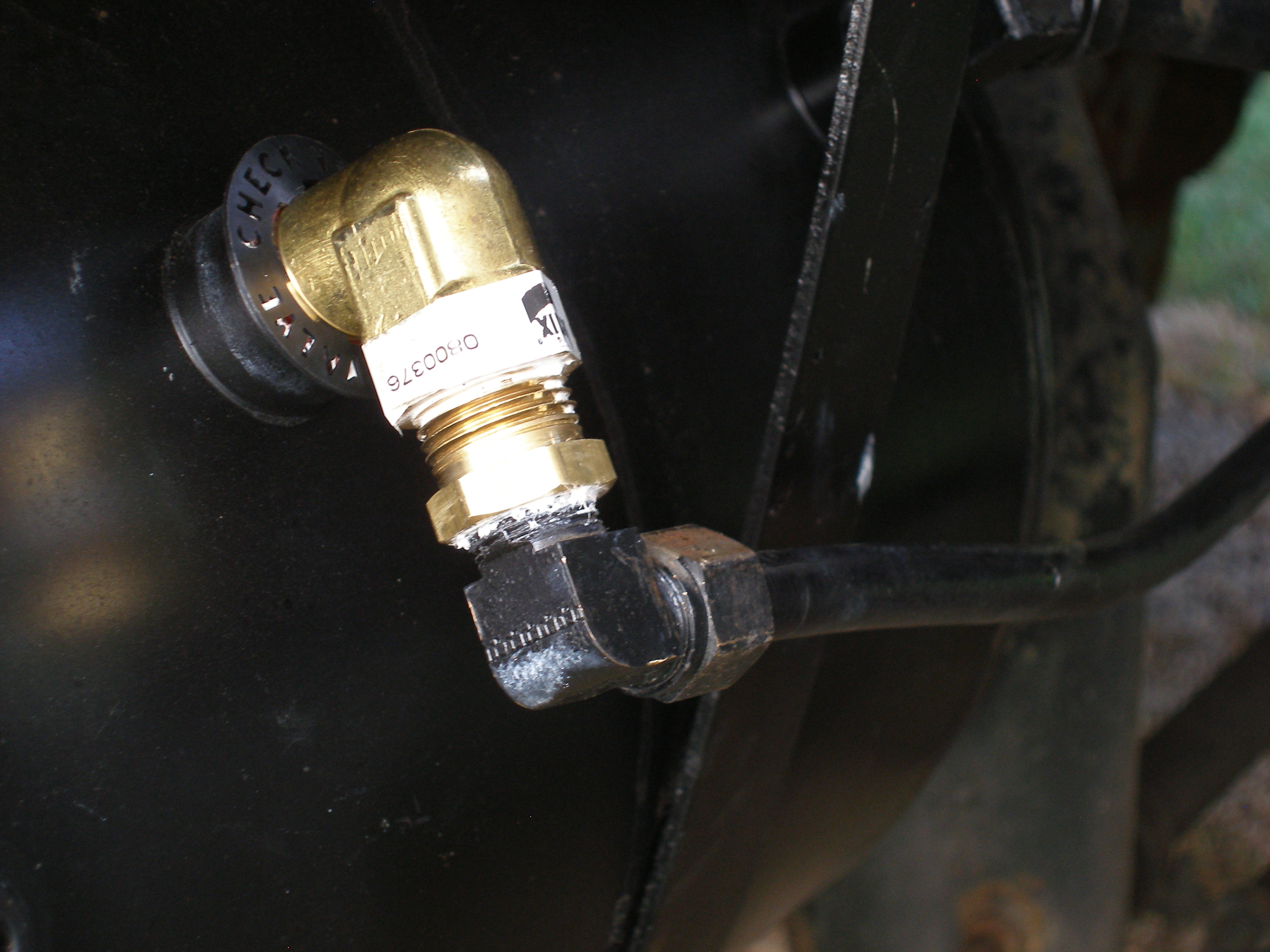

Success at last!!  I installed a check valve (Bendix 800376) at the LH tank inlet.  The air pressure this morning (both primary and secondary needles) is 80psi, down from 125psi.  I calculated the air leakage and it is about 3psi per hour.  :thumb:  Saturday will be my "check" on the running air leakage (compressor cycling) during my bouncy trip (without trailer) to Hagerstown, MD.
Ken

Well the air leak saga continues. :angry:  On Wednesday afternoon I installed a check valve at the inlet of the wet tank.  Thursday morning before I left for Winchester, NO AIR IN WET TANK!  It leaked down overnight even with the check valve.  I pumped up the air and did a quick soapy water check but did not see any bubbles.  Driving to Winchester, the air compressor cycled every 10 minutes.  So I concluded I STILL have an air leak with the trailer connected.  Today (Saturday) before I departed Winchester, I pumped up the air and did a more thorough check with soapy water.  No bubbles at the check valve tank connection but saw some bubbles at the trailer air supply gladhand.  I did not hear any air leaks at the back of the trailer (brakes or air bags).  I checked the gladhand seal and reattached the gladhand making sure it was snug.  On the return trip to the farm, the air did not leak down as rapidly.  I estimate at least 30 minutes between cycles.  Need to try different gladhand seals but still puzzled why the wet tank leaks down even with a check valve.  Stay tuned...
Ken
