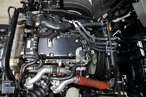

The four cylinder engine displaces 5.2 litres and uses two-stage turbocharging and an intercooler to produce two performance ratings;
  • 154kW (207hp) at 2400 rpm accompanied by 726Nm (535 lb-ft) of torque at 1600 rpm.
  • 177kW (237hp) at 2400 rpm with 765Nm (564 lb-ft) of torque at 1600 rpm.
For emissions compliance, the 6HK1 runs an EGR system fitted with a diesel oxidation catalyst (DOC) rather than a diesel particulate filter, or diesel particulate diffuser (DPD) as Isuzu refers to it. In fact, the company asserts the 6HK1 is, ‘the only medium-duty engine in the Australian market with neither a diesel particulate filter nor SCR.’
What’s more, it is the sort of emissions technology said by Isuzu to be ‘… suited to vocational applications requiring high idle time, high PTO use and frequent stop-start duties.’
In other words, the DOC deletes the need for the diesel particulate regeneration process which has been problematic for Isuzu and most others in those applications unable to generate sufficient heat for the regeneration process to occur without interrupting the truck’s normal work routine.
Yet while the new 4HK1 engine does use an EGR emissions system with a diesel particulate diffuser (filter), Isuzu is entirely confident of the engine’s environmental and efficiency credentials, and critically, its ability to avoid regeneration problems.
As a company statement explains, the 4HK1 employs Isuzu’s ‘… latest diesel particulate diffuser system with a dedicated fuel injector in the manifold to take care of regenerations.’

Isuzu 4HK1
Type: 4 cylinder 16 valve SOHC
Displacement: 5,193 cc
Bore x Stroke: 115mm x 125mm
Power & Torque: 154kW (207hp) and 726Nm (535 lb-ft).
177kW (237-hp) and 765Nm (564 lb-ft).
Induction system: Low pressure turbocharger and high pressure Variable Geometry System (VGS) turbocharger sequentially operated and with air-to air intercooler.
Fuel injection: Direct injection high pressure common rail system. Exhaust pipe fuel injection for DPD regeneration.
Emission system: Cooled EGR with exhaust Diesel Particulate Diffuser.
