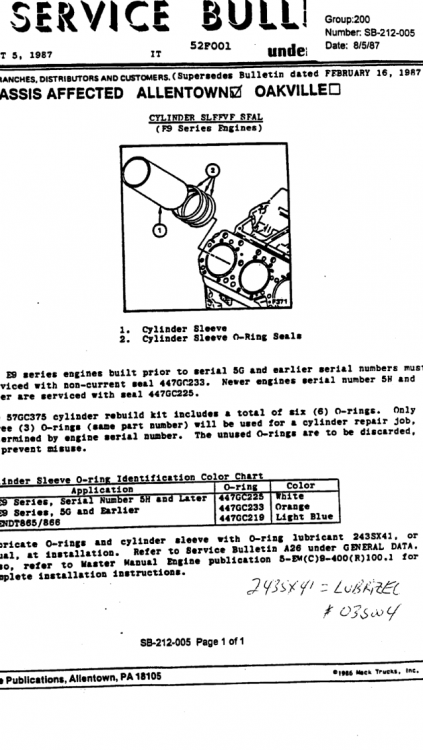

We are rebuilding our show dog it packed up a rod bearing and I need to find the Liner oring TSB
Anyone know where to find this document!
The liner o-rings changed by engine serial number Back in the day  And I want to be sure I'm using the correct o-rings
Thanx
Fred

So we finally got the engine tore down today and unfortunately the block is toast this engine has never been pulled down.
there were beads from the factory block cleaning process thru out the block number 5 and 6 the upper oring groove was totally gone haven't seen this in years used to see this back when you could still get warrenty for it.
40 year warrenty coverage do they offer this?  Probably not?! :rolleyes: We are now scrounging up another block we will se how this goes.

All I could find as of now.
MTPI 210-044PB.pdf
Thanx Bud that would have done the trick  read the post ahead of this my project went a bit sideways. Our block ( was) a
serial 8F0058
Thanx
fred
