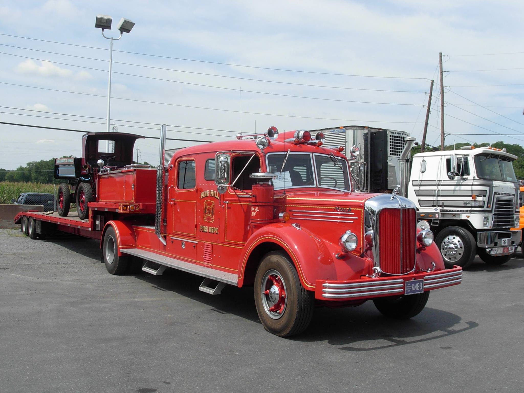

This is probably a naive question but I've always wondered about single axle tractors.  Maybe my memory is failing me but at a lot of truck shows it seems I'll see single axle tractors pulling full size tandem step deck trailers with a couple of big trucks on board.  It seems to me that these single axle tractors are often pulling the same size/weight tandem trailers that the twin screw tractors are.  I know back in the pre-war days you could get massive single rear axle trucks with high rear end weight ratings (like the big ol' FKs and so forth) but I thought modern single axle tractors generally came with approx. 23k lb rear ends.  Is this not the case?  Wouldn't a 45' drop deck with two tractors on it be quite a load for that single axle?  They sure don't seem to struggle with it and it seems like I see more than a few of them at shows which is why I ask.   Or am I just remembering wrong?

If you spec and load carefully, you can easily haul 40,000 pounds with a single rear axle tractor- Fifth wheel set forward on the tractor to put some weight on the front axle, and have the tandems on the trailer about three quarters of the way forward from the rear of the trailer to maximize the load they carry. With a spread tandem on the trailer you can haul 6,000 pounds more, even more with a tridem.

A single axle tractor isn't very heavy on the rear by itself, maybe 4-5K lbs at the most.  That gives you 18K more to put on that axle itself.   A 45ft trailer, even with two trucks isn't putting 18K on the tractor.  Two trucks might be 20-sumthin thousand pounds.  Split that between the trailer and truck and that is only 10K sum pounds on the rear axle of the truck.
Since the weight of the trailer is directly OVER the axle,  there is no squirm like a ball hitch.

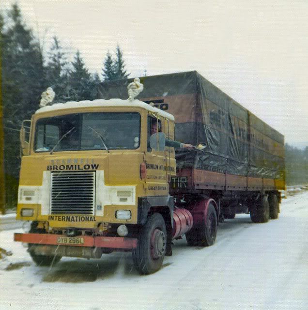

Back in the day for me.... 70's, this was a typical 32 imperial ton set up that gave at least a 20 imp ton (44000lb) payload on a 40ft TIR tilt trailer....
why drag around that extra axle if you don't need it for weight distribution...

Here's another pic of an old Autocar.  Seems odd to me to have a tandem trailer but a single axle tractor.  The load seems pretty well evenly distributed between the truck and trailer.  So why is one tandem and one not?  Just the discrepant tire sizes?13730999_1158645290845080_6537374984342745381_o.jpg
Sodly,that single screw L model fire truck makes a beautiful double bunk road tractor! Hobert was that B model a twin screw originally? It's really coming along great! Freightrain you reminded me of the days before deregulation when Pa didn't permit doubles and there were "drop yards" in Ohio and New Jersey on the tpke and I 80 where the freight companies left behind their second pup going west in Jersey and going east in Ohio. Consolidated Freightways had a long wheelbase Freightliner day cab that backed under a standard length pup trailer and locked into place creating a long straight job.I've never seen them hook up but the dolly legs must have been on the outside of the trailer and removable! Anyway the thing had a pintle that hooked up to a converter dolly and second trailer,therefore creating a de facto set of doubles! The things were all over the road,nobody wanted to be behind one! And the drivers had their hands full but the things could be "cross docked" just like a standard set of doubles!
