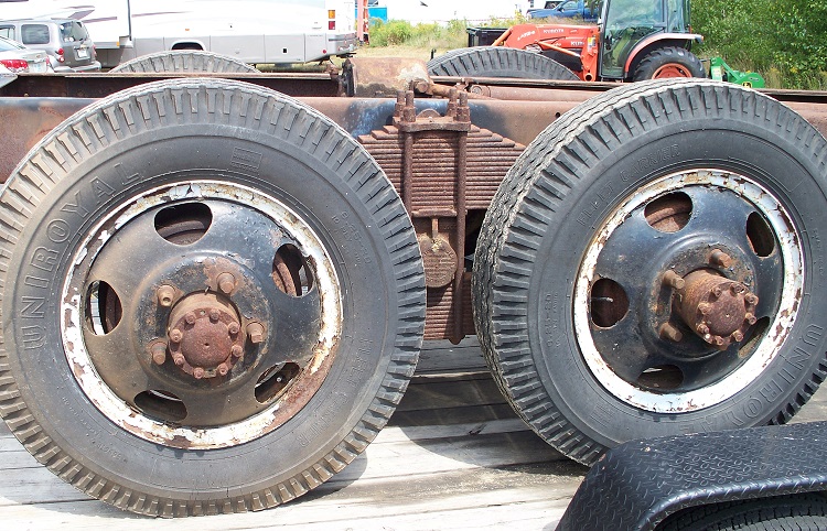

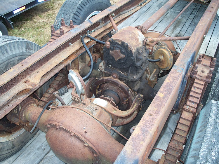

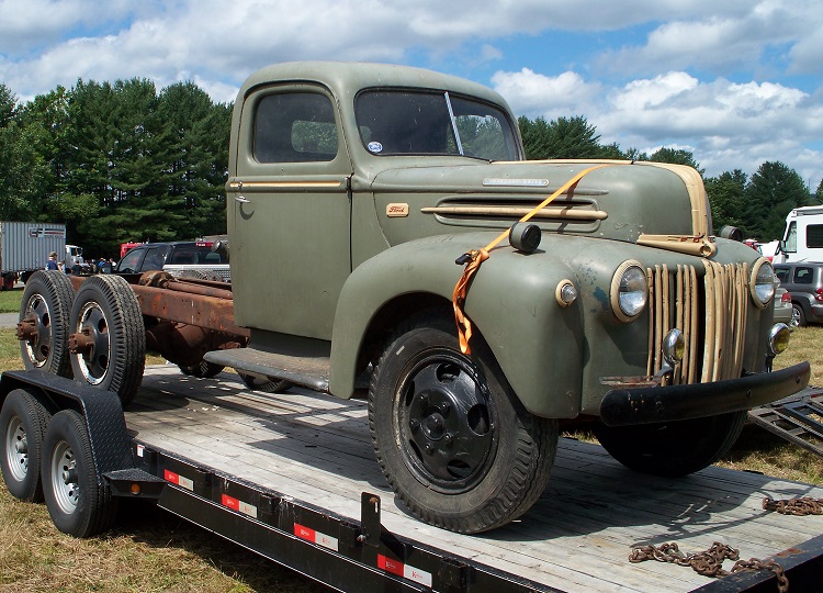

Wow! That's as bizarre a twin screw setup as I've ever seen! Axles appear to be Vacuum operated 2 spds,is that a "brownie" or similar auxiliary between the 2 axles? How many gears in all? Chassis appears to be f5 or f6 so limited weight carrying capacity why all the axles and springs?,what was the application? Speaking of bizarre,anyone old enough to remember the short lived belt driven tags?
Agree on vac shifted two spd-had same question.   as for "brownie"-doesn't drive shaft go into that "box"?-which then drives axles???

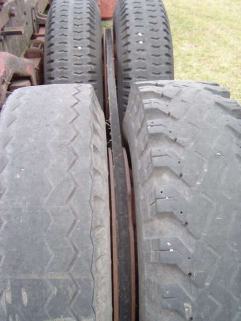

Agree on a lot of spring weight but then again look how narrow they are.
As for belt driven tags, when I started (1966) my company had a bunch of single axle B models that pulled 6500/7200 gallon tandem tanks.  Weight laws changed and instead of buying new, we had Page & Page belt conversions.  They were not around too long.
my dad had a 46 ford (canadian built) 2ton with FABCO rear suspension.front rear end turned over and put behind. transfer case at rear of main with two drive shafts.In US the same truck was classified as 3 ton with the LINCOLN  V8.
Good point Red horse,so that gear case is just to connect the two axles,doesn't ad either reduction or overdrive?I did note the narrowness of the spring leaves,have to wonder how much more a larger (but low spec'd ) chassis with conventional  full screw and air brakes would cost? Compared to the conversion?
Ford original truck 2 speed rear was cable shifted, the rears in the photo are Vacuum  shifted. Look close the drive into the rears is Fords Torque Tube set up with a sprocket on the shaft for the drive chain to spin the rears.

"Silent Drive" and "Transpec" were a few. Tony Champion has a H model I think with Belt drive on Page and page suspension.
