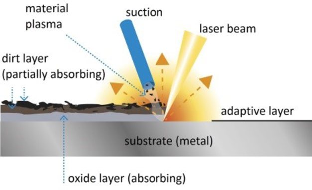

This device is called the P-Laser QF-1000. Like its rigid-mounted counterparts, the hand-held instrument is meant for industrial applications, like preparing metal for robotic welding or removing residue from manufacturing molds. As such, it’s very expensive: P-Laser told us that a low-power QF-50, with only 50 watts of muscle, costs €47,800, or more than $53,000 at today’s exchange rate. We assume that’s outside your tool budget.
How does it work? A P-Laser spokesperson explained that the system uses short pulses of laser light. When aimed at a metal surface, “the dirt layer and any oxides underneath will absorb the energy and evaporate.” The metal underneath will not absorb the laser energy, leaving nothing but a clean surface ready for welding or painting.
We know what you’re thinking, and the answer is no: This thing won’t vaporize human flesh. Amazingly, aiming this laser blaster at your finger doesn’t even hurt at all.
