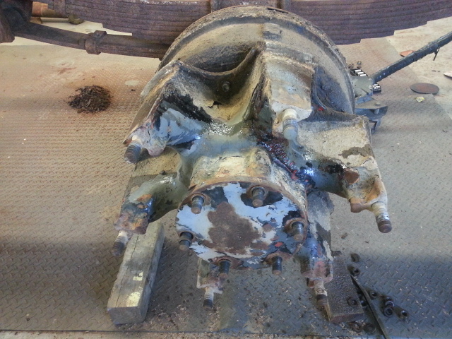

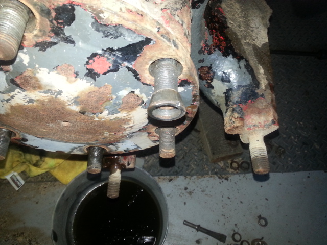

Ok fellow Mack veterans.......how do I get the rear drums off?
It looks like it would be the same process as my '72 f-250 where you take the bolts out of the center hub, slide the axle out and remove the drum that way.
 Everything is still tighter than Dick's hatband and I don't want to beat on anything for fear of breaking the casting somewhere.
The six nuts are off of the "spider " as well.
https://www.bigmacktrucks.com/topic/46707-continuing-on/#findComment-344884
Take a sledgehammer and give the center of the axle shaft a good thunk.  That should pop it.  Because there is oil inside lubricating the bearings, there is usually a good coat of RTV or gasket shellac on the mating surfaces so it doesn't leak.  Had a stubborn axle one time and resorted to using two small cold chisels to get the axle out.
Jim
https://www.bigmacktrucks.com/topic/46707-continuing-on/#findComment-344886
I use a small flat screwdriver to separate those. When re-installing, I try to set them that the opening is aimed out.
https://www.bigmacktrucks.com/topic/46707-continuing-on/#findComment-344890
