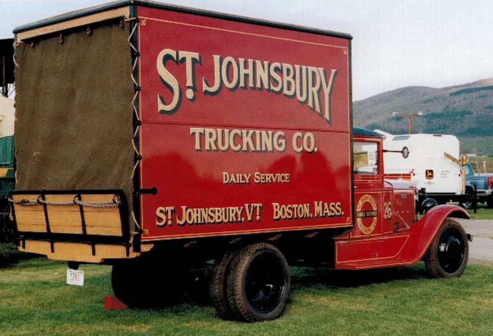

1 hour ago, j hancock said:
Maccar started in 1912 by Jack Mack, one of the founding brothers of Mack trucks and business partner Roland Carr.
Found some notes showing the truck is a 1933 Maccar 100 model.
Thanks J!!

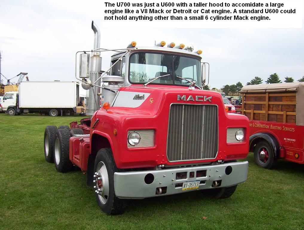

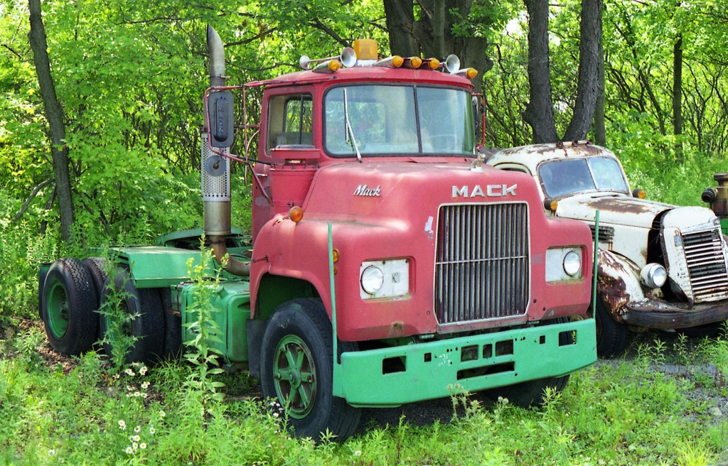

To my knowledge, the U700's indeed were built to accommodate vendor engines. I do believe that St. J did have some, yes, but Lord knows how many. The hoods were bigger (taller) to do this. See attached photos. The extra hood is visible in both the fenders and the narrow part of the hood top. I've been told that the Cummins 903 could not fit in a U700 because it was too wide. A Cat 3208 was the biggest V8 (other than a Mack V8) that could fit in there.
Dave

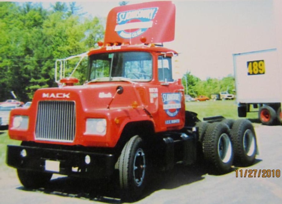

If you look at the David Faust pictures of the Transcon U-models (ex Wilson Freight U's with 903's) they clearly are U-600's. After the founding brothers of St.Johnsbury sold out to Sun Oil the frieghtliners from a west coast buyout showed up in the St J fleet. Sun Oil also bought out Jones motor lines from South Carolina. I believe this is where the IH 2500 and Ford L9000 influence in the fleet came from. There last big purchase was Ford 9000's. There were a few R models in the fleet alsobut they may have been test tractors.  It would have been neat if they had more R models . St. J went from L models to B models and then U models. After that IH's and fords. Dave 41's picture of the U could have been 903 powered or 673 inline. Also as I remember the 903 U's had downward exhaust(smoke eaters). If you view the transcon U's with 903's they are also downward exhausts.
