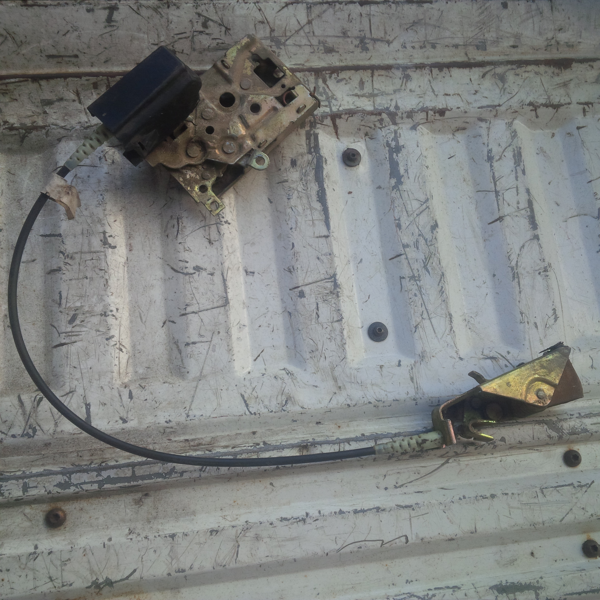

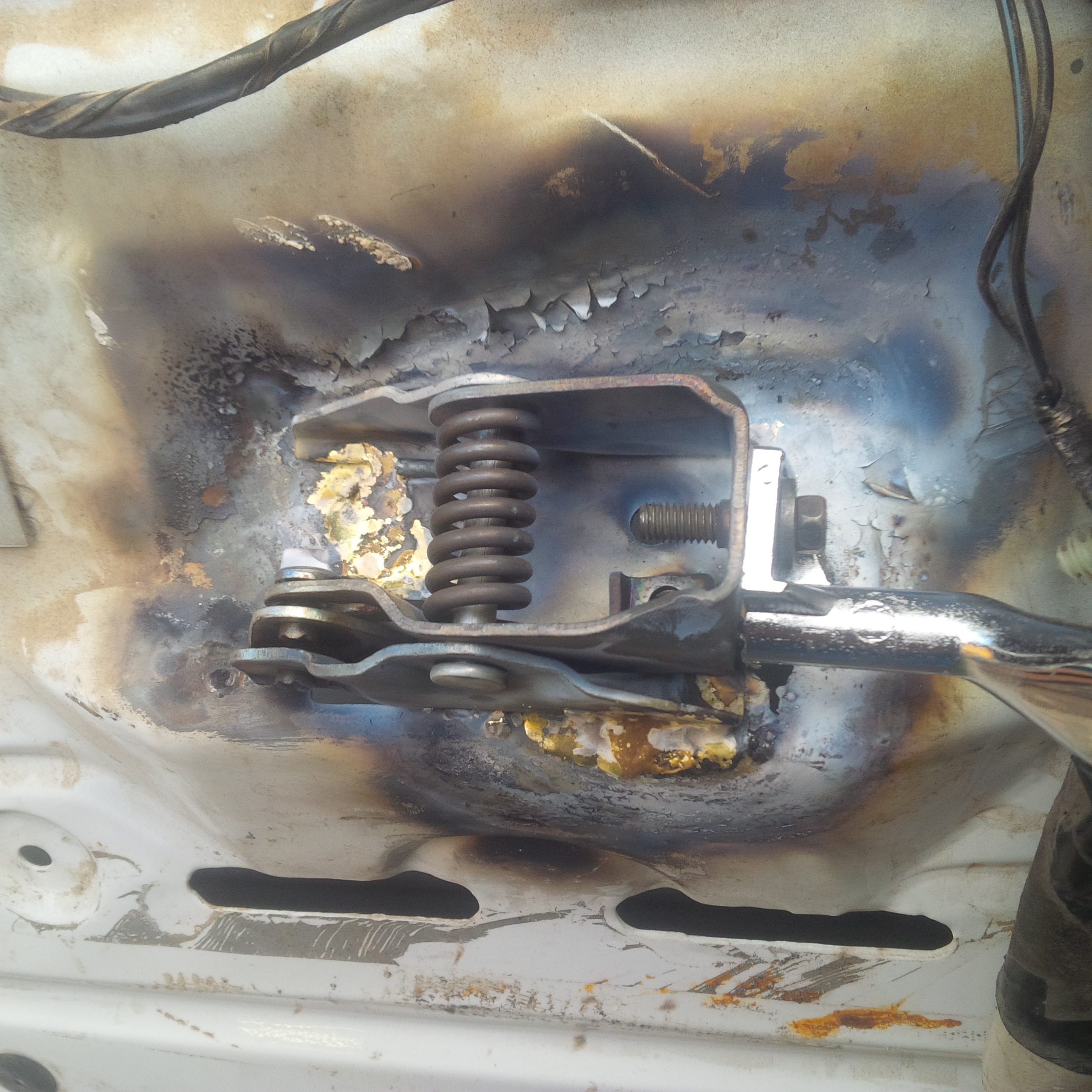

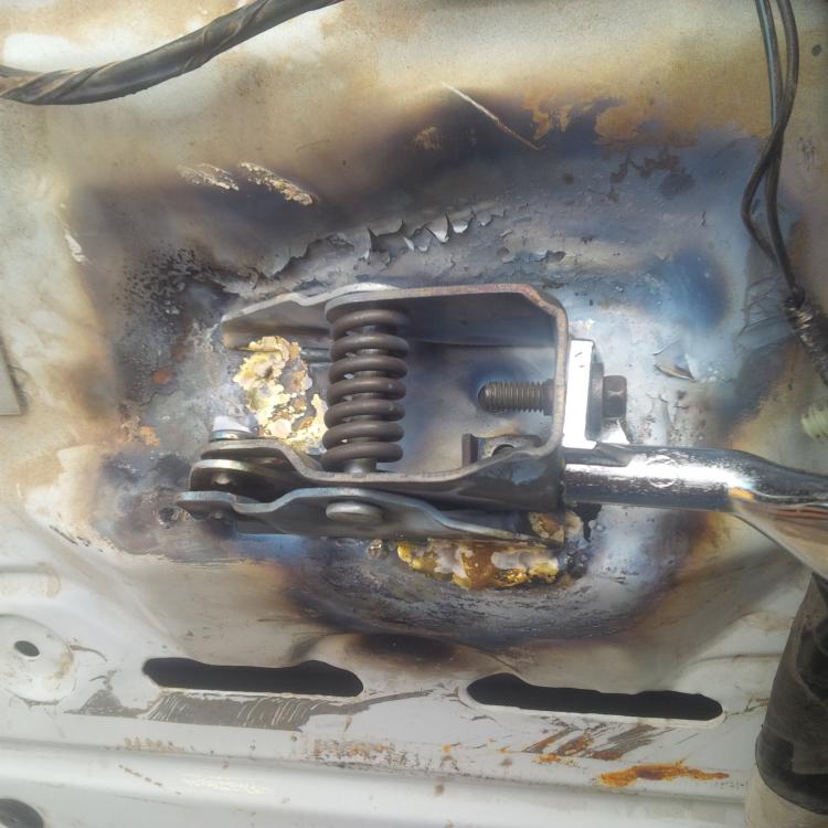

So I had the typical problem of the driver's side door latch handle snapping off in your hand when trying to exit the truck. The door panel was cracked on a previous repair, and so I'd welded the lever the handle bolts to onto the door panel...a fact which I had forgotten about prior to this repair. Anyway, handles kept snapping, and I looked into the matter online to see that I'm not the only one. Apparently, when Ford went to this body style, they started using a cable to reach between the release handle and the latch...which the internet was saying would "stretch", causing the lever to not move enough to release the door. Sounds plausible enough (although now, I think it's more a matter of the cable gumming up and not slipping through the cable guide as easily, causing increased pressure needed on the handle, which breaks it over time). I had even tried the 80's style chrome plated pot metal handles over the OEM 90's style plastic ones...and they, too, would break.

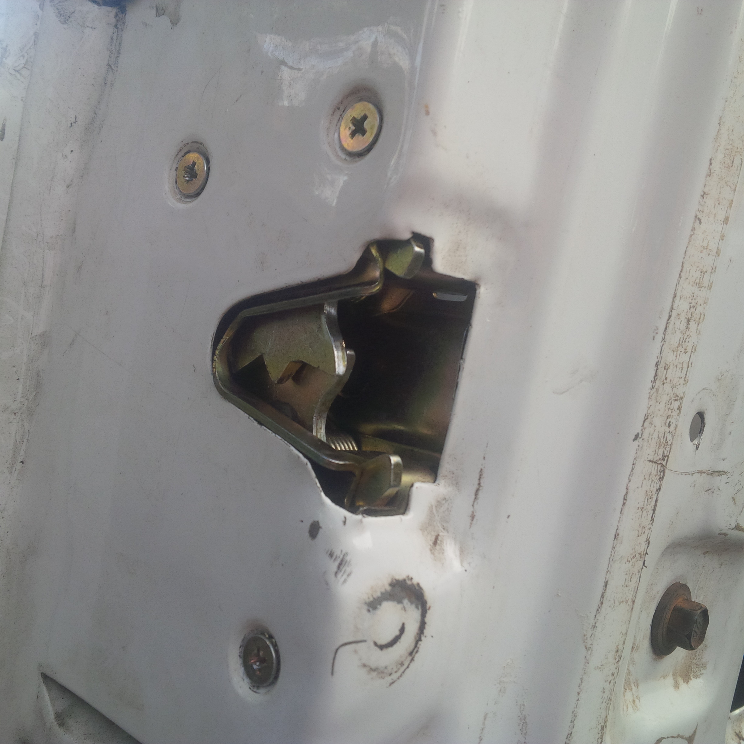

Anyway, fast forward to last weekend, I had received through LMC the door latch, rod, and lever, along with a new handle...to retro-fit the OLD style door innards into my truck. Everything went together just fine, except for having to cut the old latch out & braze the new one in due to the prior welding.

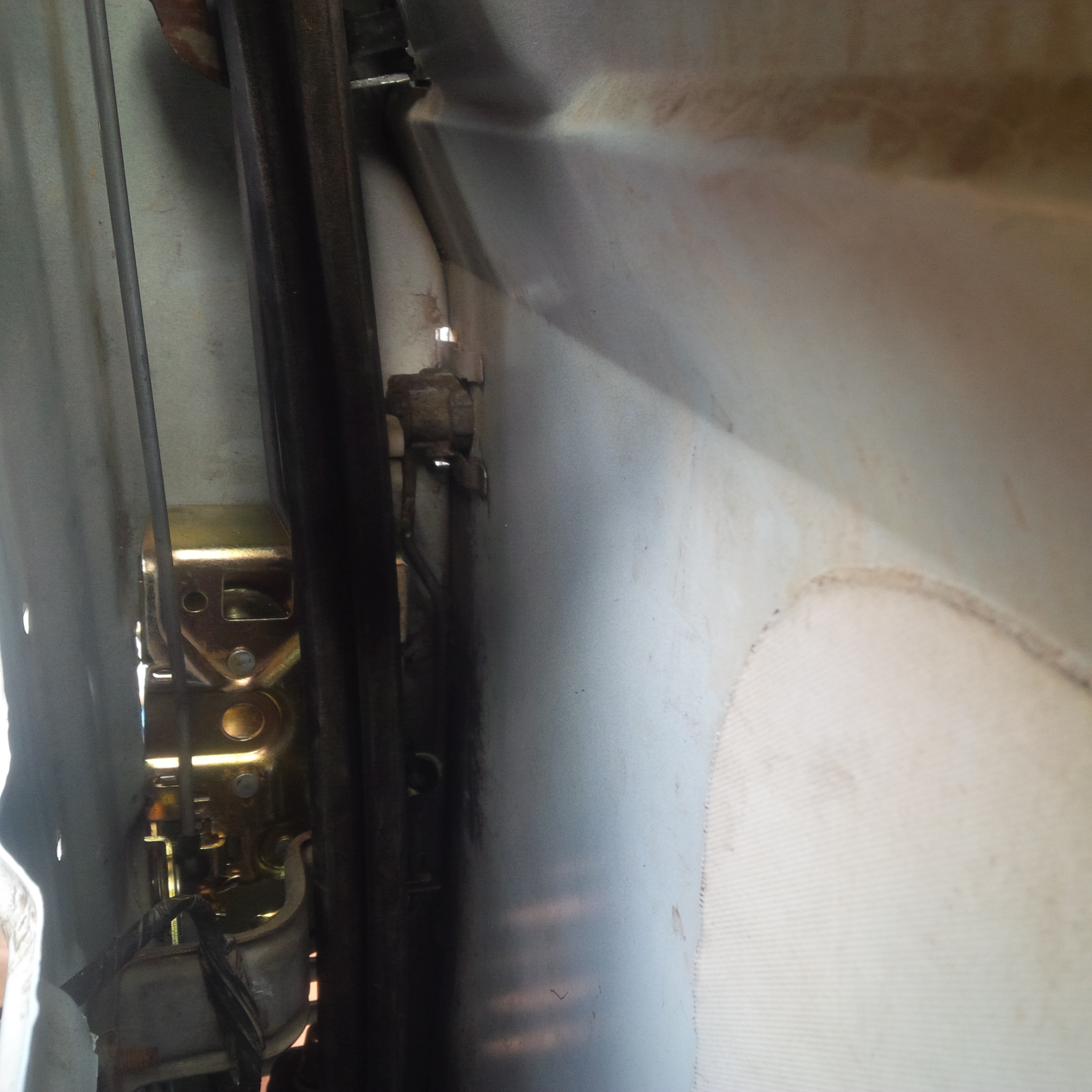

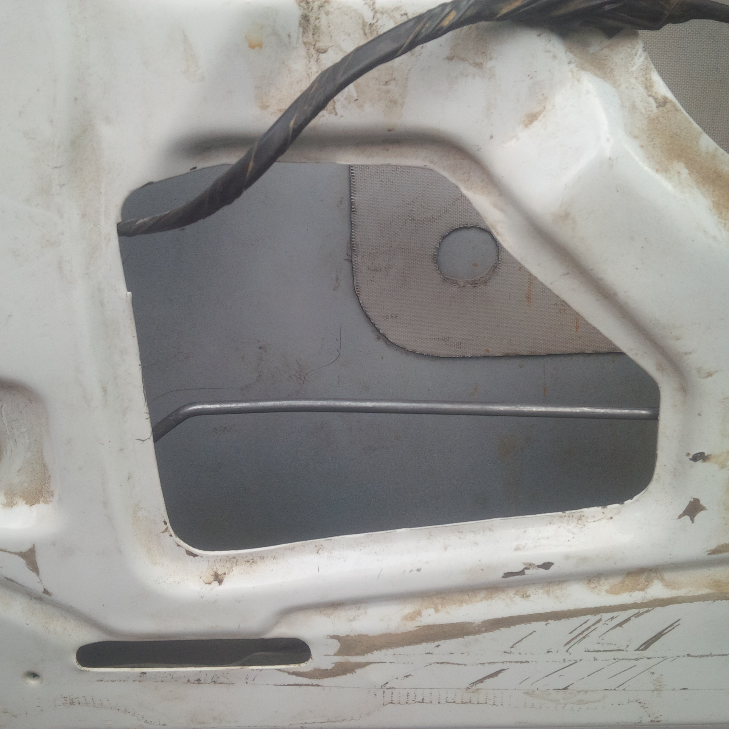

So today, I've got the driver's door torn apart again. A friend mentioned he had a similar thing happening with his Mustang, and it turned out to be the power door lock actuator was loose. Not the case here, as it is pretty snug in there...can't wiggle it at all. I've lubed everything up w/ silicone lube, and WHEN it works, it is the smoothest operating door I've ever worked. When it doesn't? No comment.
I think I have narrowed it down, though. Seems to work great until you try to open it from the outside while the door is locked. Then it sticks, and until whatever is stuck loosens up again, you won't be able to open the door from the outside. The rod going up to the handle on the outside of the door doesn't return to where it's supposed to be, which prevents the door from being unlocked.
