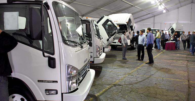

Isuzu’s all-new entry in the Class 6 medium-duty truck segment—the 2018 Isuzu FTR—is almost here.
Isuzu began production on the truck on May 8 at a new 80,000-square-foot Spartan Motors facility in Charlotte, Michigan, which represents a $6.5 million investment. Much of the engineering for the truck was done at the Isuzu Technical Center of America in Plymouth, Michigan, and many of the parts for it are US-sourced.
“This is still pretty new, so we’re going to continue to see this grow,” said Tim Ellsworth, product planning manager. “It has a wide variety of applications. The big picture we want to share is that this is going to be a great Class 6 truck that will accommodate a lot of the needs of different types of applications and equipment.”
The FTR is powered by Isuzu’s 4HK1-TC 5.2-liter turbocharged four-cylinder diesel engine—a first in the segment. It generates 520 lb-ft of torque and 215 horsepower and carries a B10 durability rating of 375,000 miles—meaning that 90% of engines should reach that mileage before requiring an overhaul. The truck has a gross vehicle weight rating of 25,950 lbs.
Eight wheelbase lengths, ranging from 152 to 248 inches, accommodate bodies from 14 feet to 30 feet, allowing for a wide variety of body applications.
The truck’s Dana-supplied axles will have capacities of 12,000 lbs up front with a 19,000-lb rear suspension.
Bridgestone or Continental 11R22.5 tires will be the standard offering on the 2018 FTR, fitted onto 22.5-inch x 8.25-inch steel wheels.
