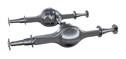

BELLEVUE, Wash. - Paccar is launching a new proprietary tandem axle that is the industry’s lightest and most efficient axle in its class.  “Paccar is pleased to deliver the most fuel efficient axle in the industry to complement the superior performance and fuel economy of our Paccar (DAF) MX Engines,” said Landon Sproull, Paccar vice president.
The new Paccar axle is designed to improve the operating efficiency for line haul, regional haul and pick-up and delivery customers. The new axle is rated at 40,000 pounds, supporting a gross combination weight of 80,000 lbs.
Kenworth will begin offering the axle to customers in January 2017.
“Paccar’s axle reduces vehicle weight by up to 150 pounds, and provides improved fuel economy,” noted Sproull.
The Paccar axle features a unique pinion-through-shaft design that simplifies power flow in the axle for maximum efficiency, and incorporates an innovative laser-welded carrier design that reduces weight and improves fuel economy.
The Paccar axle comes with an industry-leading warranty of five years or 750,000 miles.
Ratios from 2.47 to 3.70 are offered, with engine torque compatibility up to 1,650 lb.-ft. and multi-torque rating compatibility up to 1,750 lb.-ft.

Driving the new Paccar rear axle, 2017 MX engines

The fuel savings provided by Paccar axle – figures have not yet been disclosed – will come from reduced weight and internal friction. Gansle said the new axle is 80-140 lbs lighter than competitive offerings.
“This is going to be more efficient than anything out there,” vowed Baney.
Weight was taken out by laser-welding internal components. Less oil is required as well. And Baney said there’s less friction within the axle. A pinion throughshaft design simplifies power flow in the axle for improved efficiency, Paccar claims. Ratios from 2.47 to 3.70 are offered with engine torque compatibility of up to 1,650 lb.-ft. and a multi-torque rating of up to 1,750 lb.-ft. It was designed for linehaul applications. The gross vehicle weight limit is 80,000 lbs.

The new Paccar tandem axle, the industry’s lightest and most efficient tandem in its class, is designed to improve the operating efficiency for line haul, regional haul and pick-up and delivery customers. Rated at 40,000 pounds, the Paccar tandem axle supports a gross combination weight of 80,000 pounds.
The Paccar tandem axle features a unique pinion-through-shaft design that simplifies power flow through the forward axle for maximum efficiency. The axle also incorporates an innovative laser-welded carrier design that reduces weight and improves fuel economy.
“The new Paccar tandem rear axle for the aerodynamically efficient Kenworth T680 on-highway model and the T880 vocational flagship model provides enhanced fuel economy, reduces vehicle weight by up to 150 pounds, and complements the excellent performance and fuel efficiency of the Paccar [DAF] MX-11 and MX-13 engines,” said Kurt Swihart, Kenworth marketing director.
The Paccar tandem axle offers ratios of 2.47 to 3.70 with engine torque compatibility up to 1,650 lb.-ft. and multi-torque rating compatibility up to 1,750 lb.-ft. Warranty coverage is five years or 750,000 miles.
