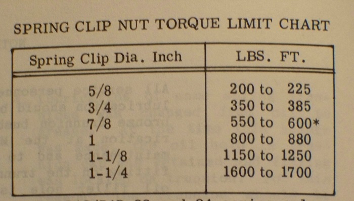

Thanks, I'll be sure and do that.....and what do you torque the gripes at? I've heard everywhere between 1100lbs. to 1600lbs? I don't remember what we did on the spring we repaired years ago....but the 1100 seems to be in my mind, but that's a far cry from the 1600 I've heard recently.
