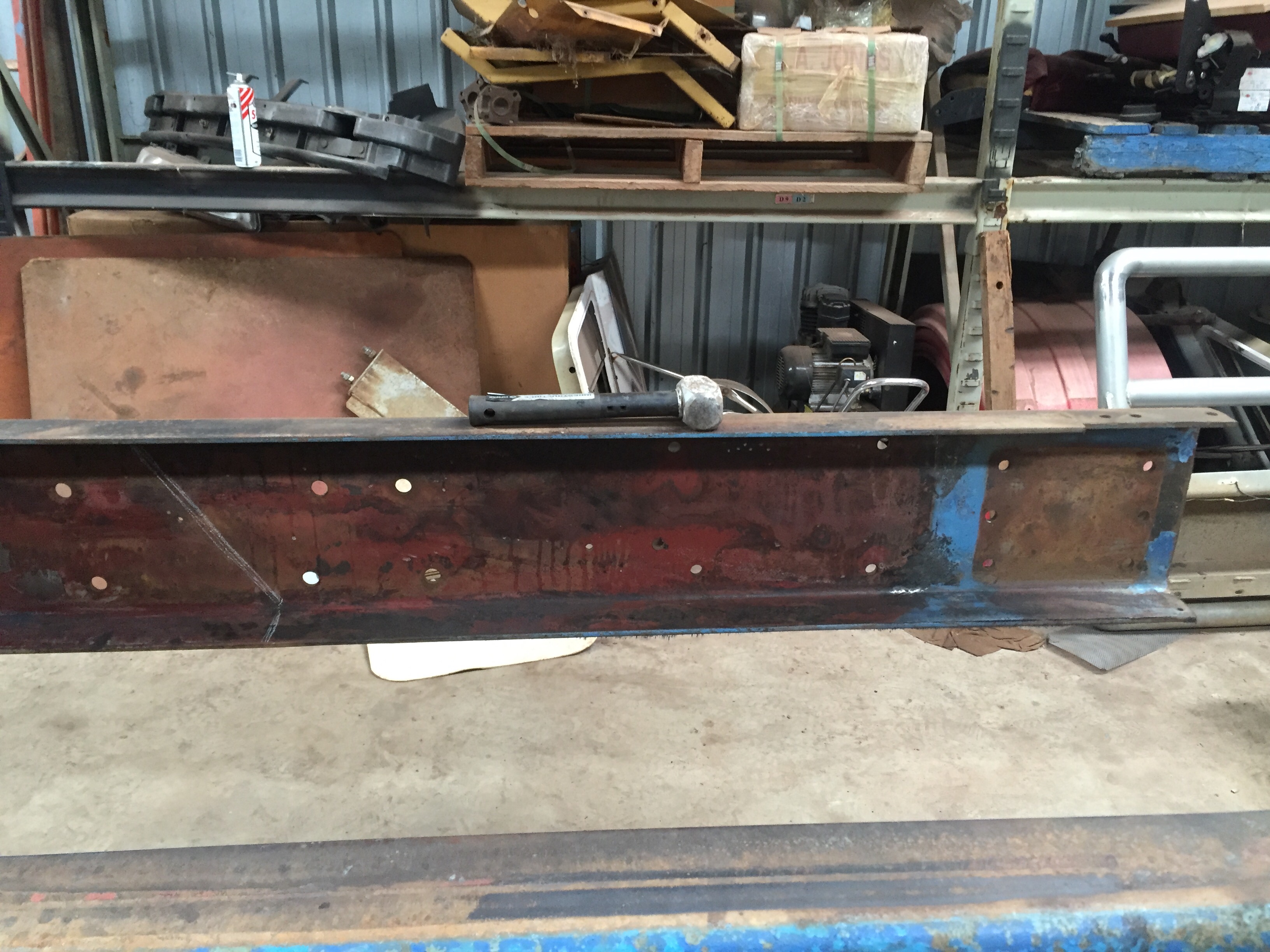

I've pulled my ass end apart and yeah mine has been extended at some stage. As the rest have said, it was joined between the trunnion bolts and had some frame inserts added.
As for the crack in the flange, I hope it turns out to be an easy fix. Would be a lot easier to fix that and add on the end.
https://www.bigmacktrucks.com/topic/47381-frame-lengthening/#findComment-349527
The crack is an easy fix. It's not bad at all. The back of the frame is cut short, short enough that there isn't room for mud flaps. I can move the trunion to the back that will give me a 210-215" wheelbase not exactly what we're looking for but it would def be better than it is right now. Maybe that's what we will do.
