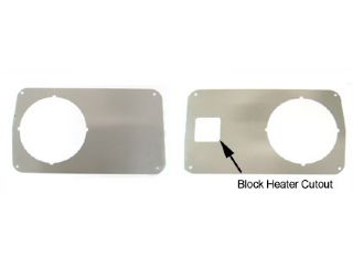

If you mean that guy runs RD with a round headight in a suare bezel to fit a RD newer hood suare opening it was a factory option for some RD's. Sure they had them on both sides when new. There was a talk on that on here recently. Just a couple weeks back. I'm not ready to point you to it right now.
No. The headlight bucket was fitted right onto the hood. With the bezel (chrome ring) on the light unit. The outside stainless steel plate attaches straight to the hood either with screws. No real connection between the bucket and the plate.
