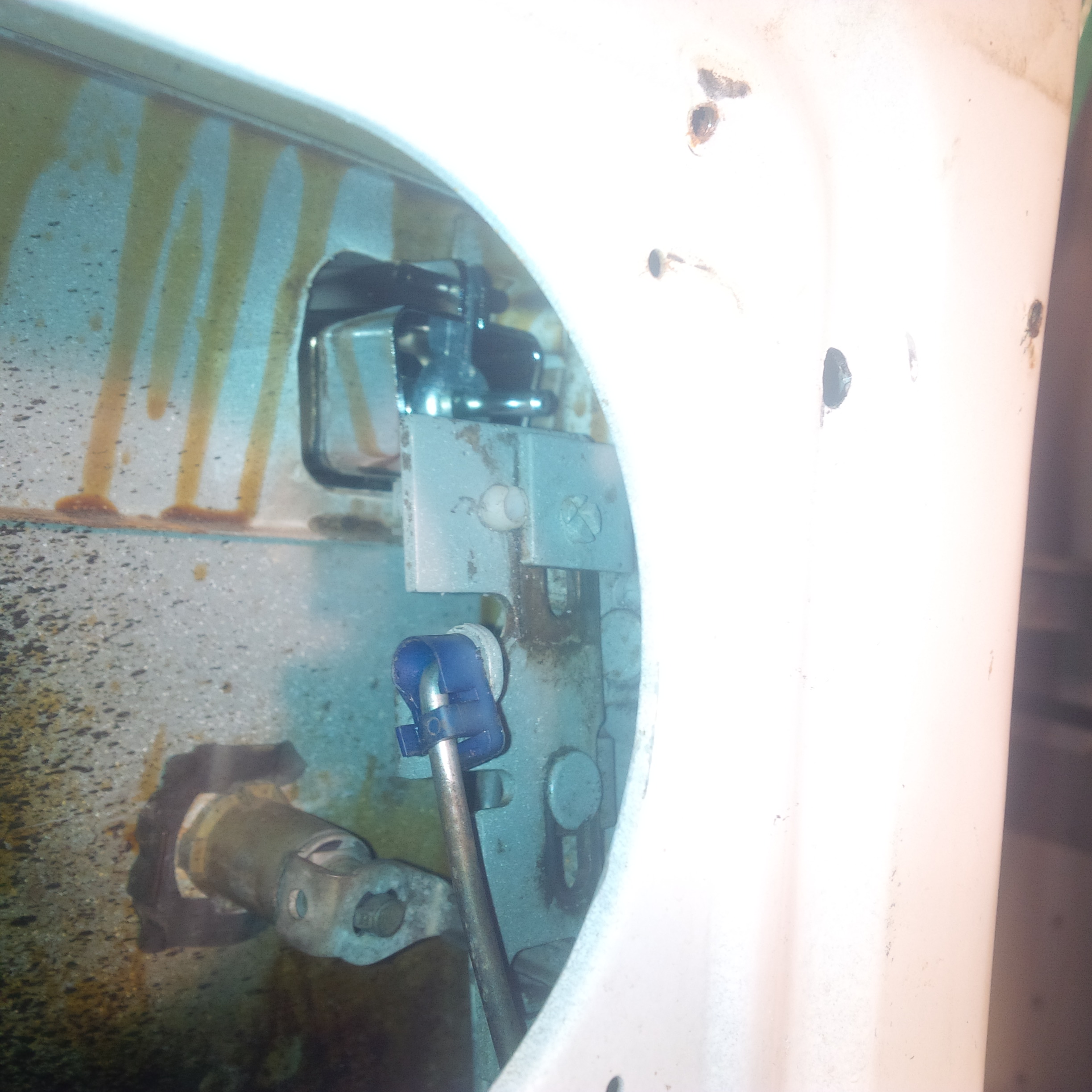

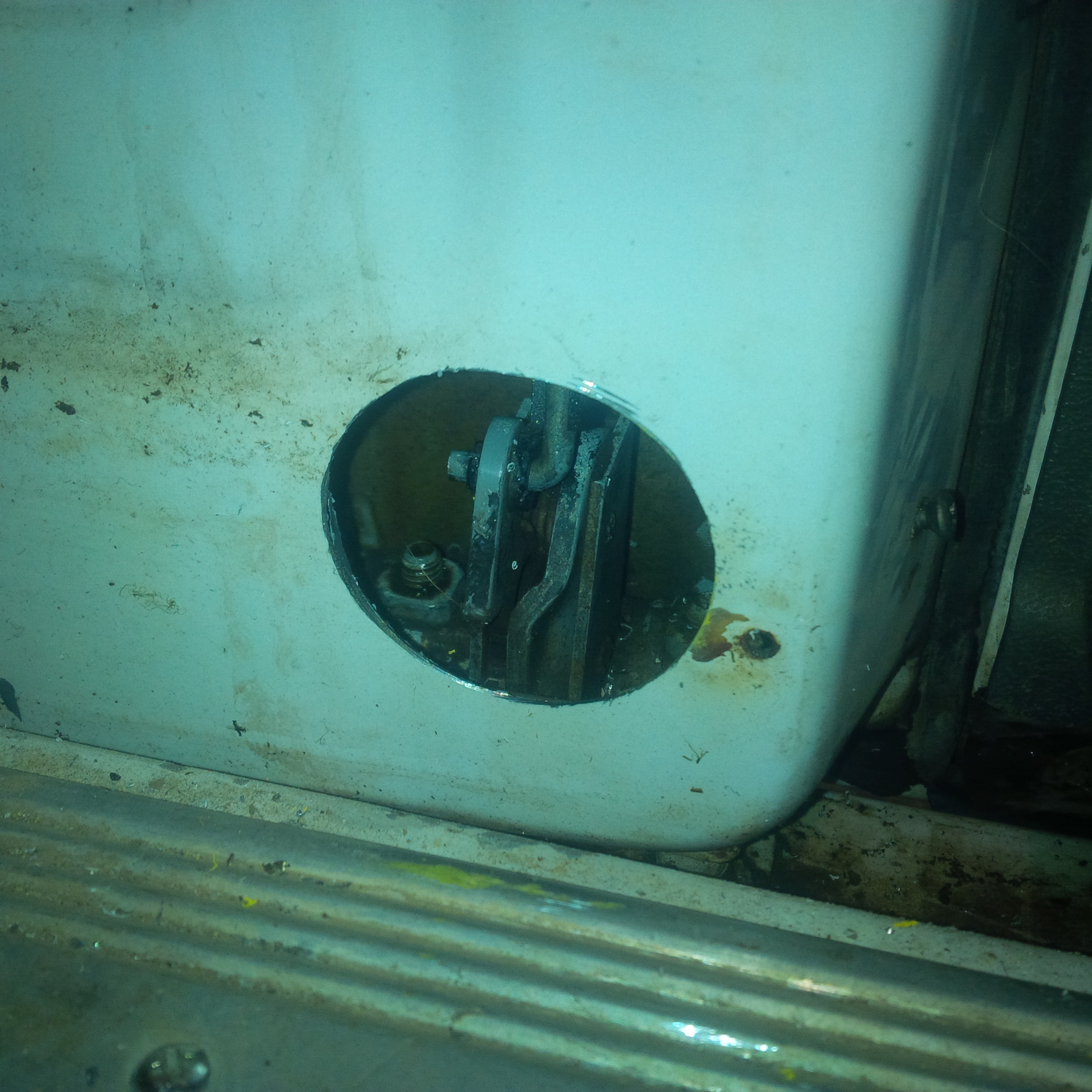

Rear barn doors won't open. Got the interior panel peeled back to access the interior stuff, and it seems like the latch @ the bottom of the door is stuck. Not much room to work, but got it soaked with some WD40 for now. Have all new latches to install once I get the damn thing open...just being a pain in the ass. Gotta order the rear handle, too, because it broke as I was messing with it.
Anyway, if I haven't mentioned it already, I hate working inside doors.
https://www.bigmacktrucks.com/topic/47592-more-suburban-fun/
Never had to dig into the barn doors on a Suburban.  Only replaced the W/S once.  Does it help to have someone push the doors "in" at the bottom to to take the pres. off the latch while the other tries to work the mechanism?
Don't like working inside doors either.  Wish I had better info for you.

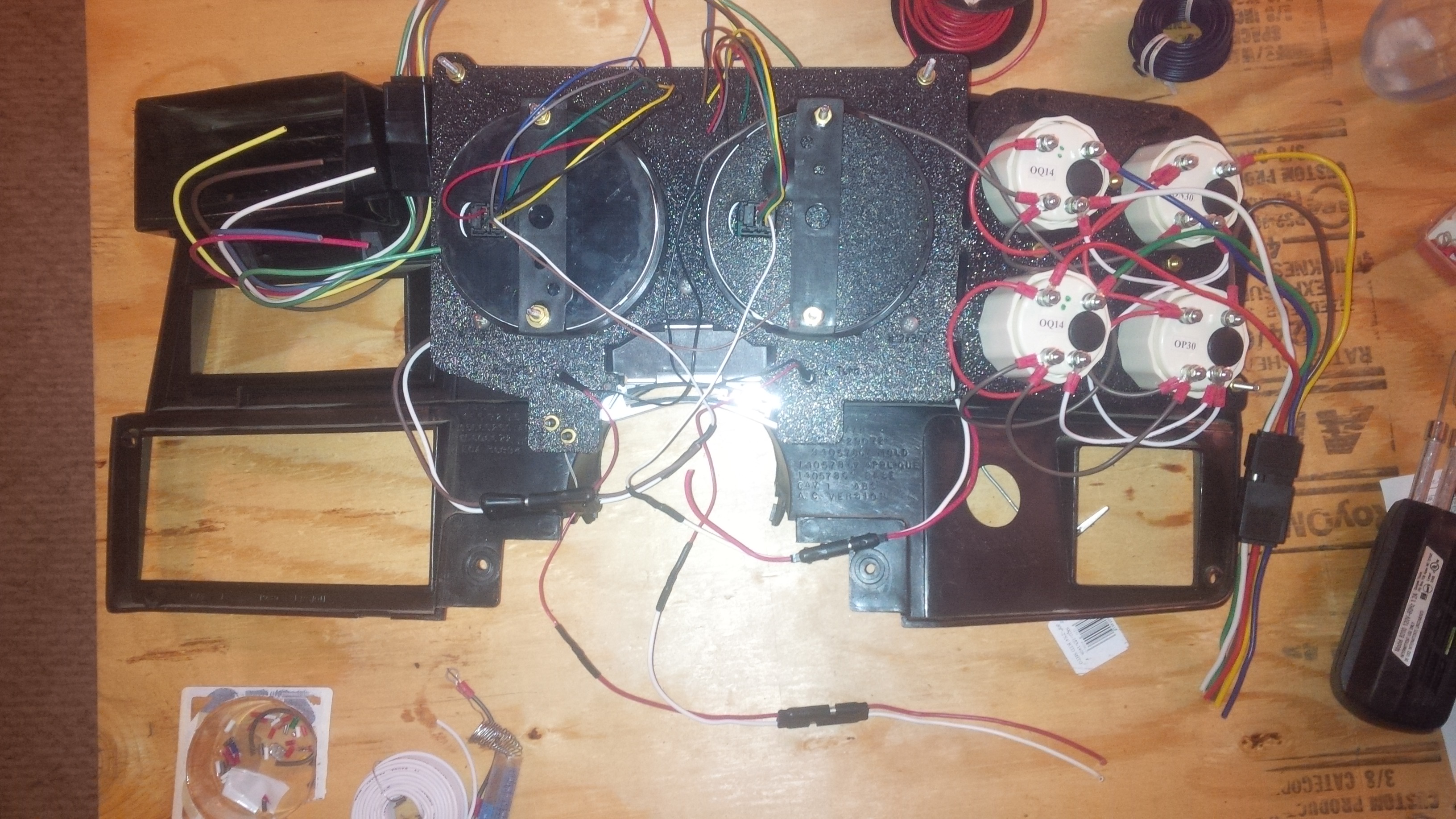

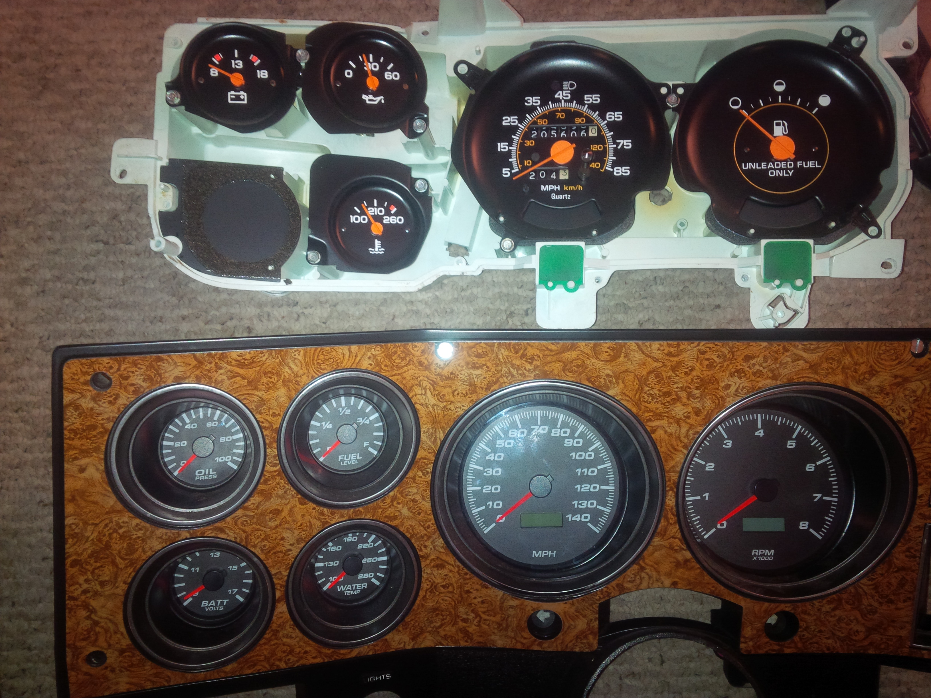

Also working on replacing the gauge panel. Speedometer has never worked, but the Odometer was still clicking off the miles. Well, that quit, too. Can't replace "just" the gauge that doesn't work...damn cluster. Found an aftermarket cluster in the LMC catalog that said it had all of the warning lights included for the "stock" look...and it mounts behind the original dash...so I ordered it. Should have paid the extra $500 and got the Autometer gauges with their replacement panel. Gauges would have looked better (more variety to choose from to pick ones we liked), and we would have got EXACTLY what we ordered. The tach on the gauge kit we ordered is supposed to have a blue halo light for the high beam indicator...supposed to be a wire on the backside to splice the wire into...ain't there. No wiring for any other lights...check engine, brake, etc...despite the catalog saying it'd have them. This is why I hate mail-order stuff...don't always get what you thought you were buying.
Anyway, Dorman has some pretty slick looking LED indicator lights in a variety of colors...and some momentary-on push button switches that match and look a hell of a lot better than the cheap little plastic buttons they sent to reset the trip meter and such for the speedo and tach. Picked 'em up in all 5 colors...blue, red, amber, green, and white. Since I don't know how we'd label them without it looking cheap, I figured it'd just be best to use different colors...blue for high beam, red for brake, amber check engine, and not sure which yet for seatbelt and battery...could go either way. At least that way if a light lights up, we know what it's trying to tell us. There's also a couple other lights I might make them...perhaps 4x4 instead of the seat belt...haven't quite made up my mind.

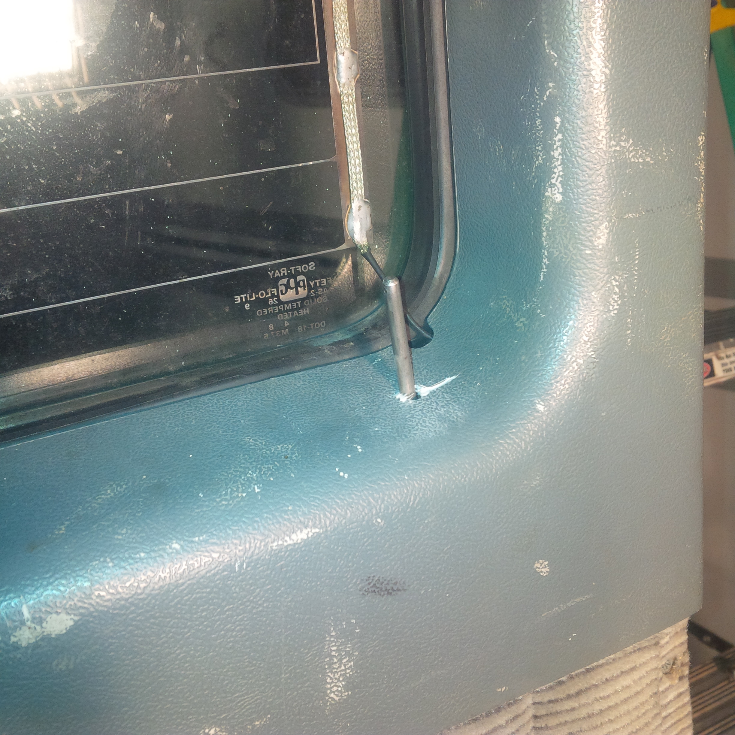

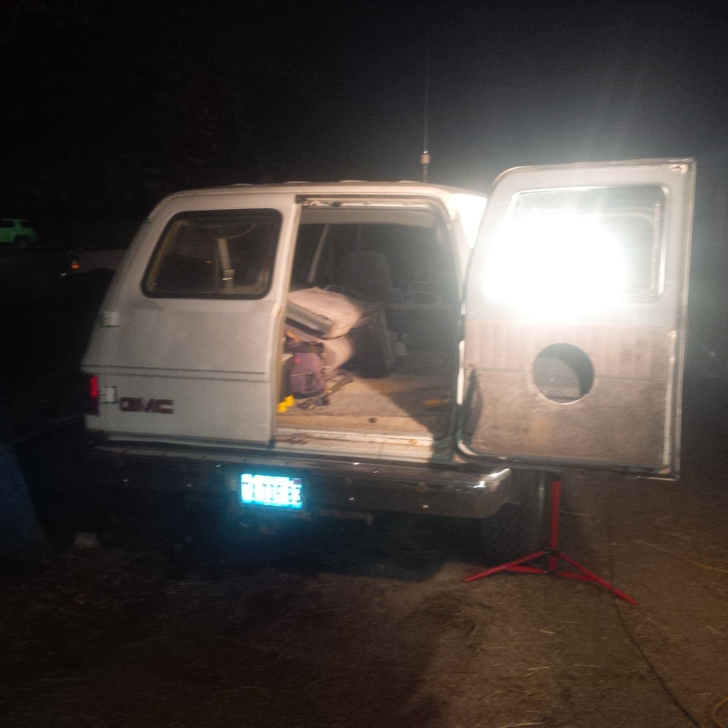

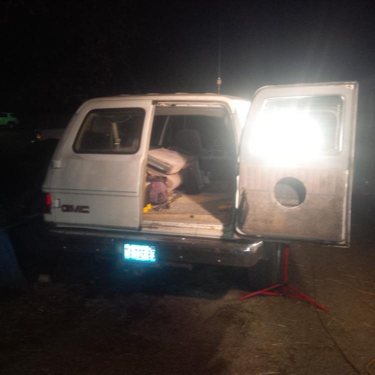

Back door problem solved...just needed a hole saw, chisel, and a BFH. Gave the release mechanism a good thump, reached inside the door to trip the top latch release, then gave the door a good swift kick from the inside...and she opened right up.
https://www.bigmacktrucks.com/topic/47592-more-suburban-fun/#findComment-353114

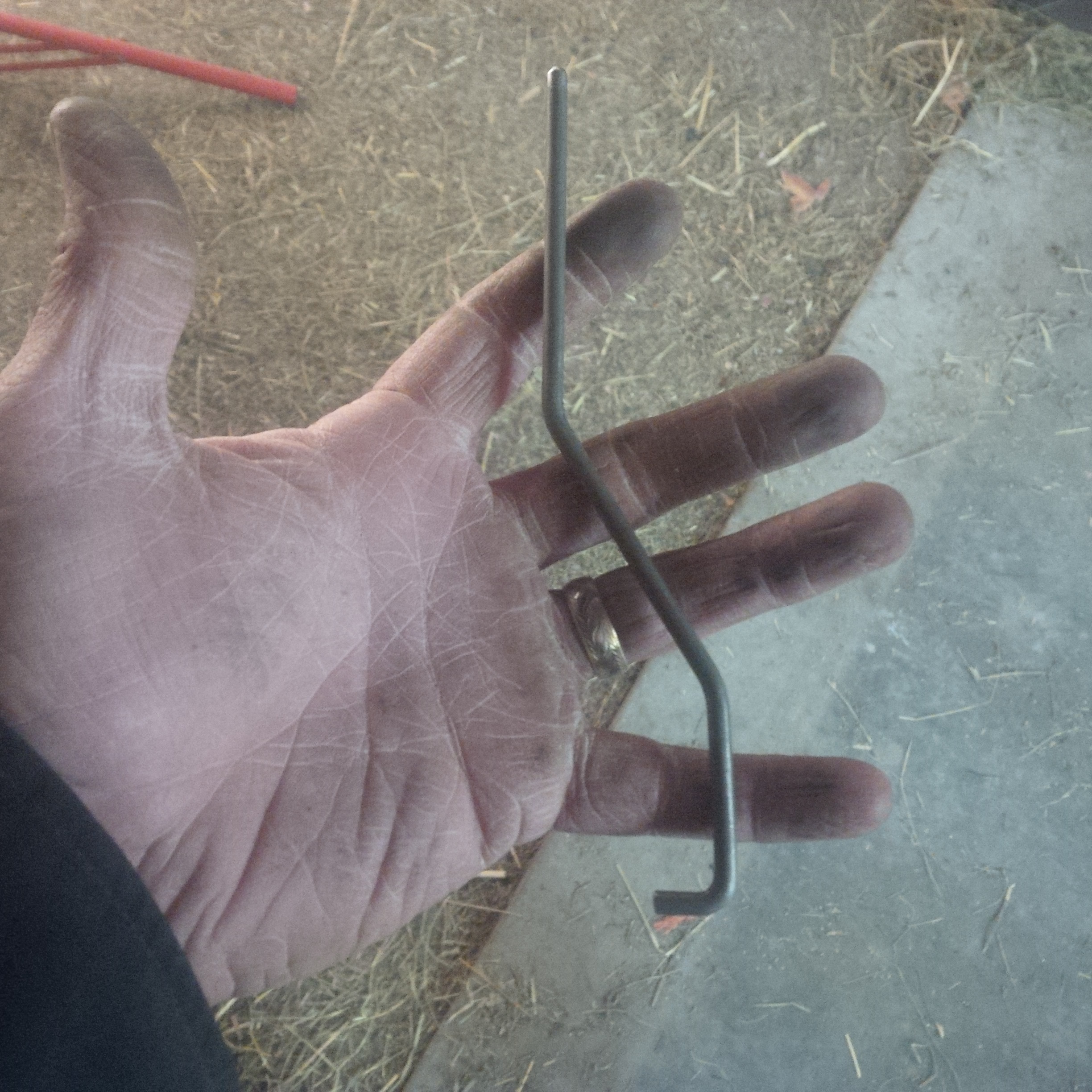

Then, while the door was open, I replaced the upper & lower latches, as well as the door handle...and the power door lock actuator. UNFORTUNATELY, the new power door lock actuator was so stiff that the key couldn't lock or unlock the door with it hooked up. So, I decided to add a little something GM forgot...used my drill and some 1/8" rod and added an interior lock knob.
https://www.bigmacktrucks.com/topic/47592-more-suburban-fun/#findComment-353115
Then, I decided to disconnect the power door lock actuator rod from the lock mechanism since I really don't care to fight with this stupid door anymore. Locks & unlocks with the key and the newly fabricated lock knob just fine, and the door opens and closes smoother than it ever has.

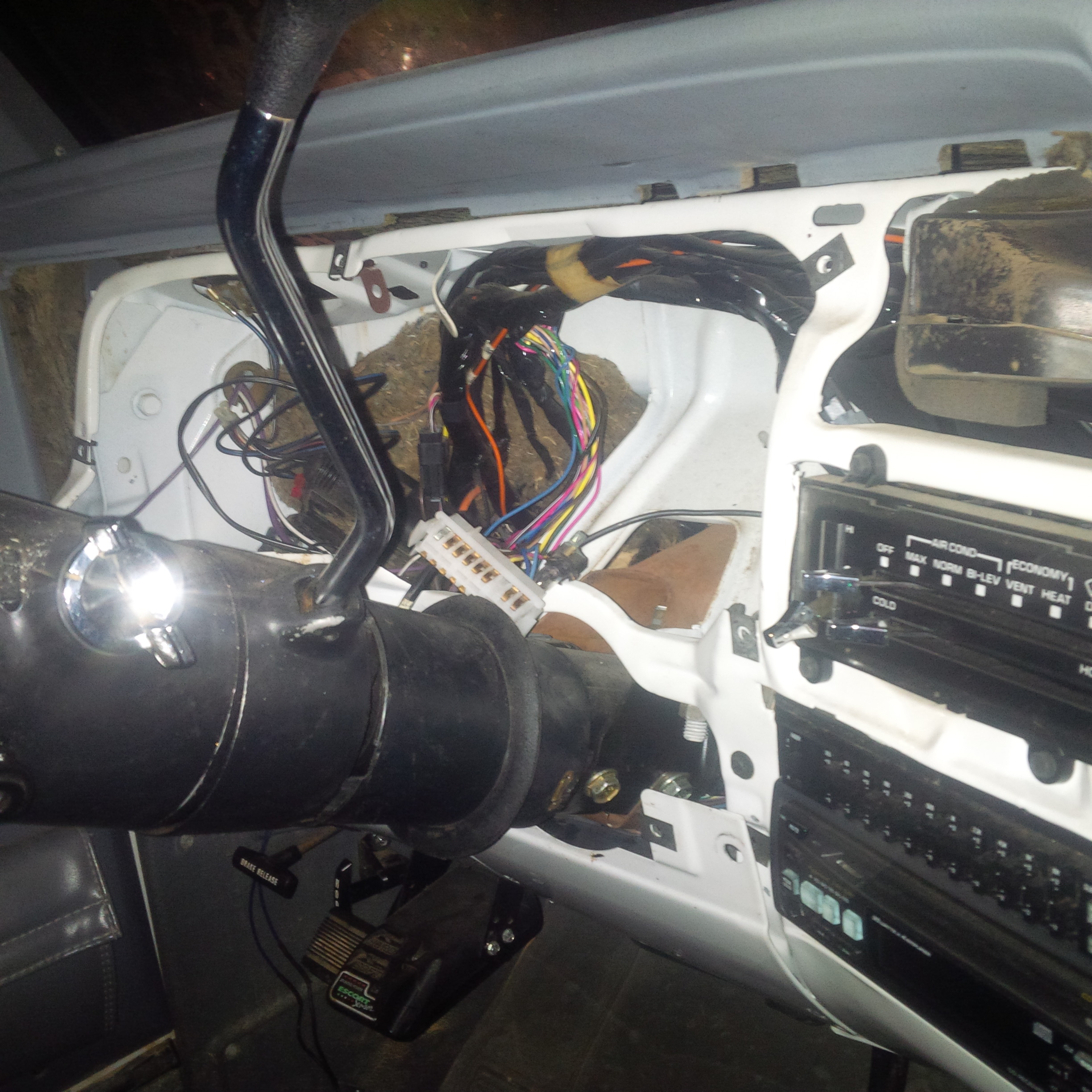

Now all I have to do is get the dash put back together...

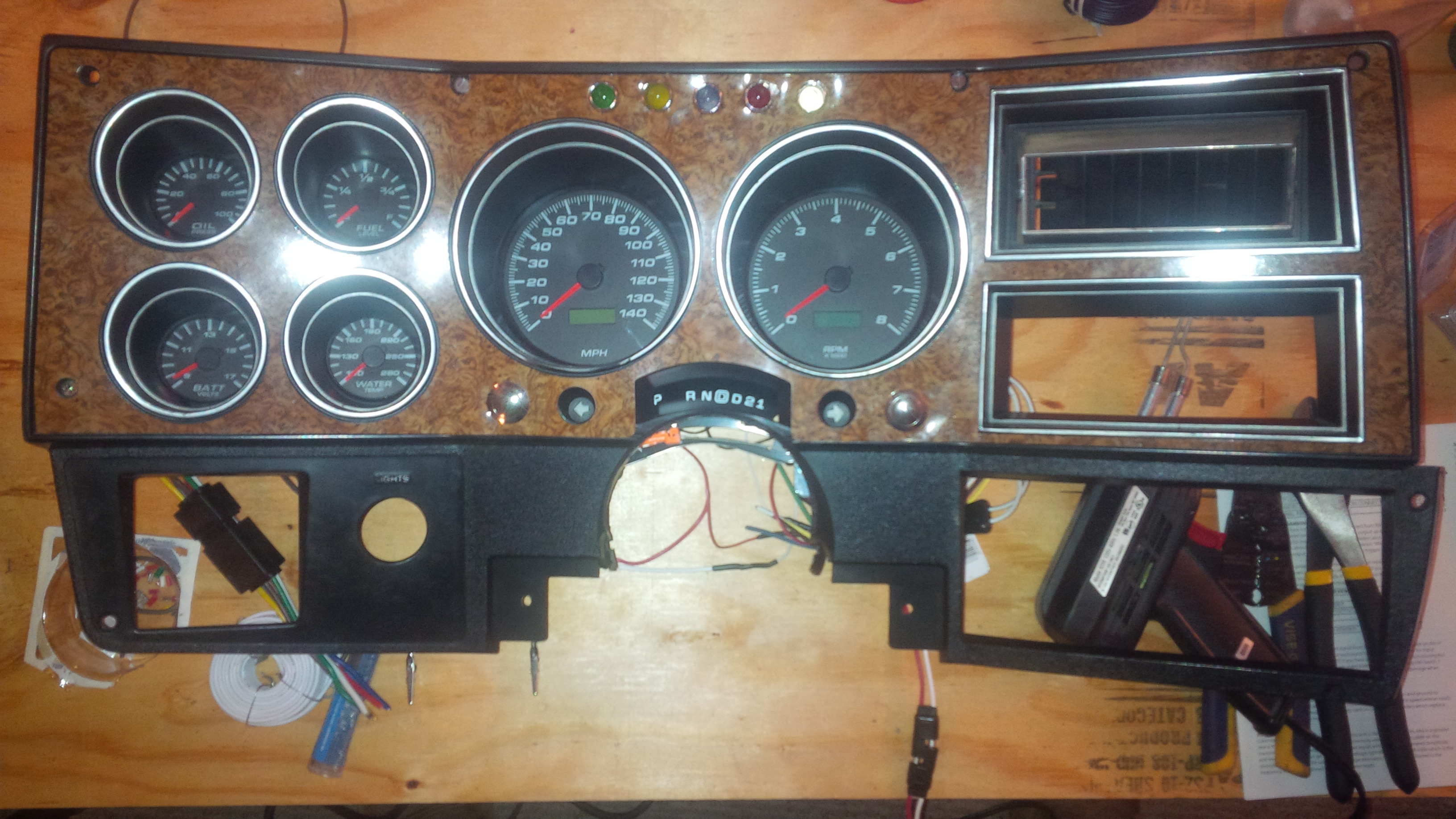

One word: TEDIOUS
Got the warning lights and speedo/tach reset buttons installed, then wired up the dash tonight. Now, just need to solder the other half of all of the plugs into the proper circuits in the Suburban and take 'er for a test drive. That'll have to wait for another day...

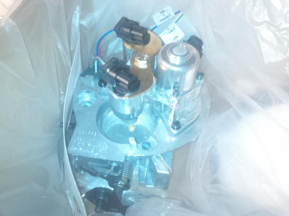

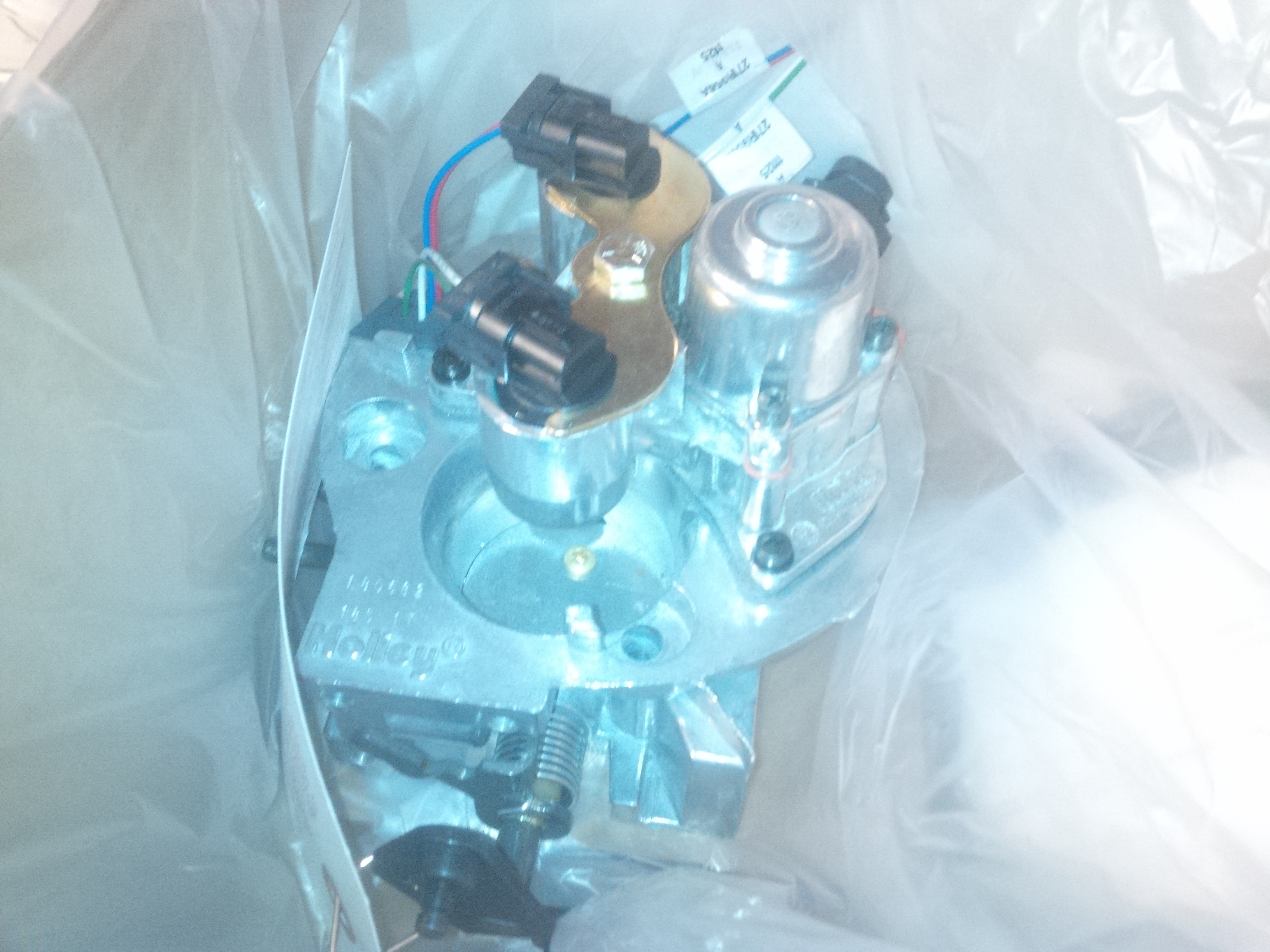

Well, I've run through just about every cuss word there is & even made up a few. Waited damn near 2 months for this thing to show up, and it turns out the TBI replacement for a "1990-1995 5.7L GM TRUCK" is not the right one for a 1990 GMC Suburban. Everything LOOKED right, except for the TPS plug. Instead of ordering the 502-9, I SHOULD have got the (less expensive) 502-6 for a "1987-1989 5.7L GM TRUCK". I'll receive a credit for the sale price I paid for the more expensive TBI once they receive it. In the meantime, they're charging me nearly $5 more than I'll get back because they aren't on sale now. The correct TBI ships tomorrow, should be here Thursday, so I'll have it put together by Friday night and be ready to test it out on the farm next weekend.  I even asked if the 502-6 TPS would bolt onto the 502-9 TBI...easy enough to swap out if it did...but it doesn't. So, it's parked in the driveway 'til the right part gets here...still out of commission.
On the bright side, I did get the ignition module swapped out and new ignition wires installed. 2 wires had made contact with the headers, and the spark plug gaps weren't even CLOSE to what they should have been...guess I should have paid more attention to that when I was putting the new motor in. Oh well. I was going to swap the magnetic pickup, too...but that would require pulling the distributor and disassembling the damn thing. Screw that. Tested it with an ohm meter and it is whithin spec, so I left it in.
The other piece of good news is that the new TBI gaskets are tapered to make the transition from the 2" bore on the new TBI down to the OEM bore size on the intake manifold. I was thinking I'd have to port the manifold to open it up, but since the gaskets are tapered to fit I'll just leave it as is. Of course if I still feel it's starving for air, I'll pop it off and put my dremel to use...but no point in doing that if it isn't necessary. I'd also have to trim the taper off the gaskets or the port job on the manifold would be pointless.

TBI take 2. It's at the post office awaiting pickup, so the wife will do that today. HOPE to have it on by the end of the day. Wrong TBI is "out for delivery" as of this morning, so we'll see how long it takes them to refund my money.

Got it on easy enough. Throttle linkage was a little different, so I had to do a little Redneck engineering to shorten the rod for the cruise control. If I get a 6-40 die, I can trim the rod and remove the bolt...until then, it seems to work. The crimp connectors to splice the injector wires weren't the heat shrink kind, so I swapped them out for some that were. Kinda stupid to spend all that money on making it run right only to place a time limit before wires corrode and the injectors quit working.
Anyway, seat-of-the-pants Dyno says it found a few more ponies and a couple extra ft lbs...definitely gets off the line now and ALMOST even wants to spin a tire. Eventually I might pull the TBI again to port the intake manifold, but for now it seems to work. We'll find out for sure whether it's good or not the first time we hook up to the horse trailer.

Before you port the intake at the RBI, I would see how much of the restriction is needed to create turbulence  to stop the atomized fuel from puddling. Found that bit when I port matched my small block cross ram TBI 's to  their intake mount. Ended up with idle issues and low speed stumble. It did pull good at wide open throttle.    Paul
