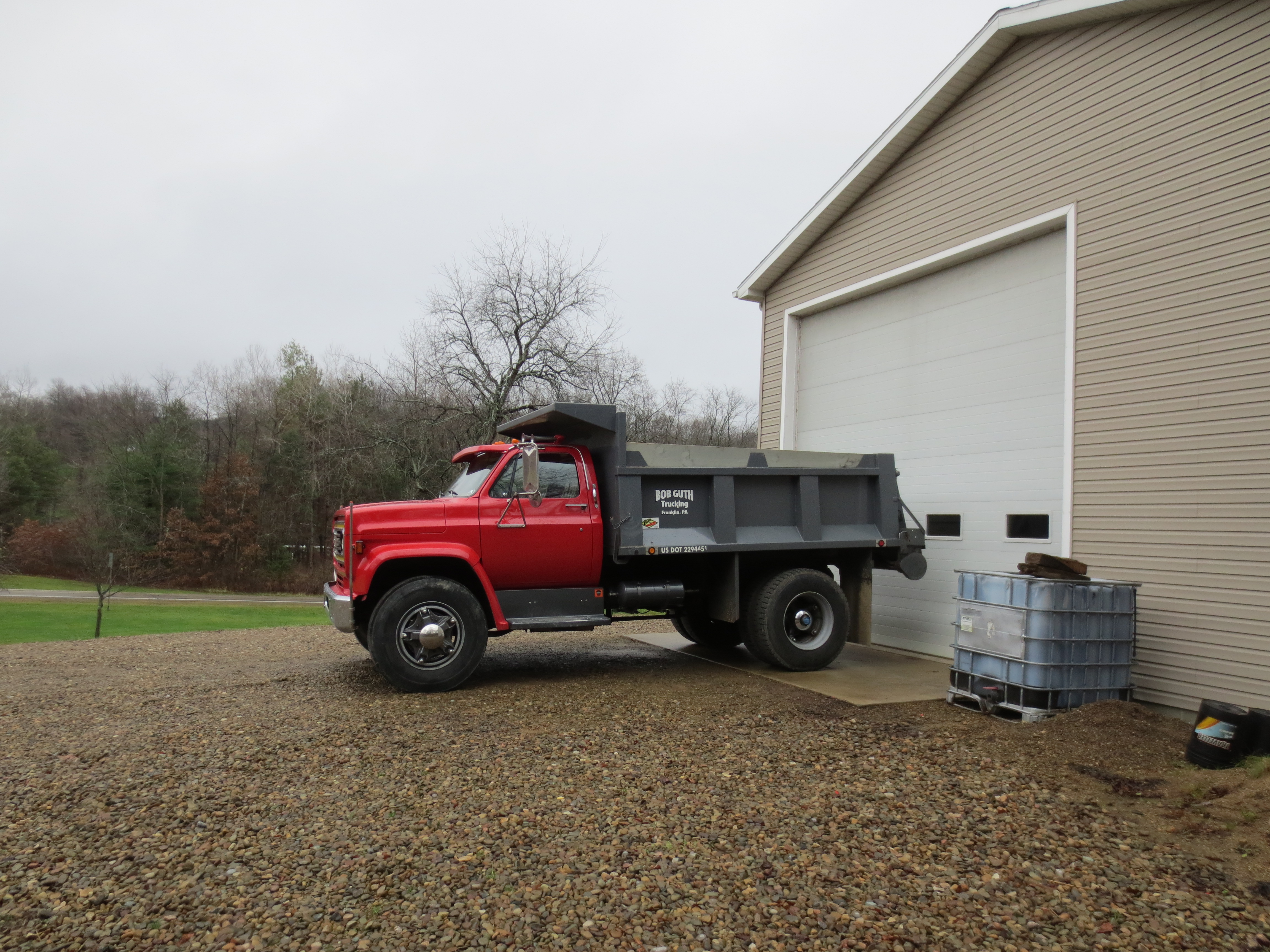

That's a slick looking C60 -- looks like it's air brakes too, eh? I like those Dayton wheels with the chrome caps.
