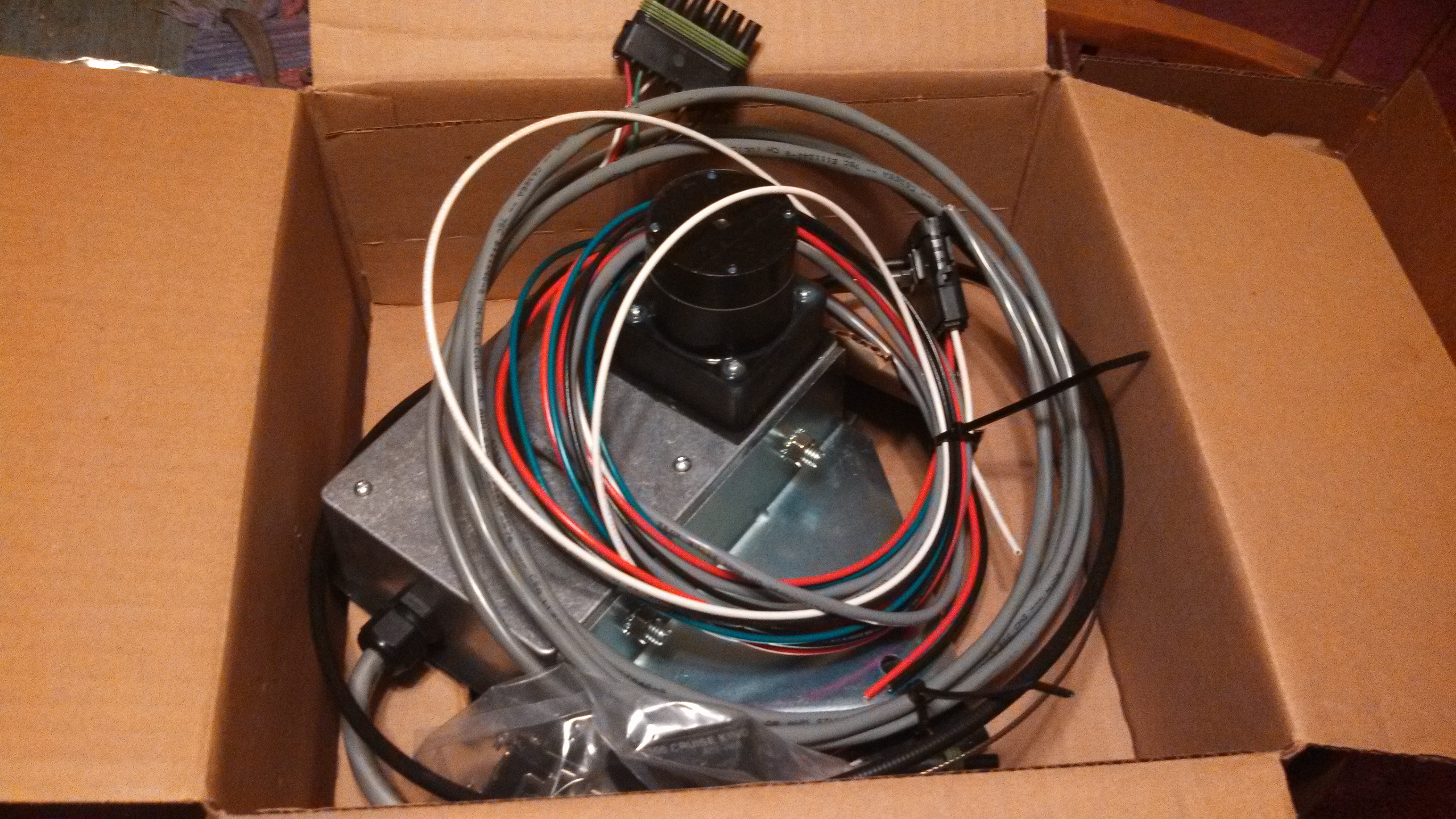

I bought myself an early christmas present.  I have heard about this from other places and thought i would give it a try.  Ordered it and it showed up a couple days later.  Seems pretty simple to install, even easier since I already have an electronic speedo for a signal.

My first question is how "heavy" of a return spring can I leave on my pump?  I've got a pretty stiff one right now and not sure how strong that stepper motor is for torque?  Might have to change the spring to a bit softer version?

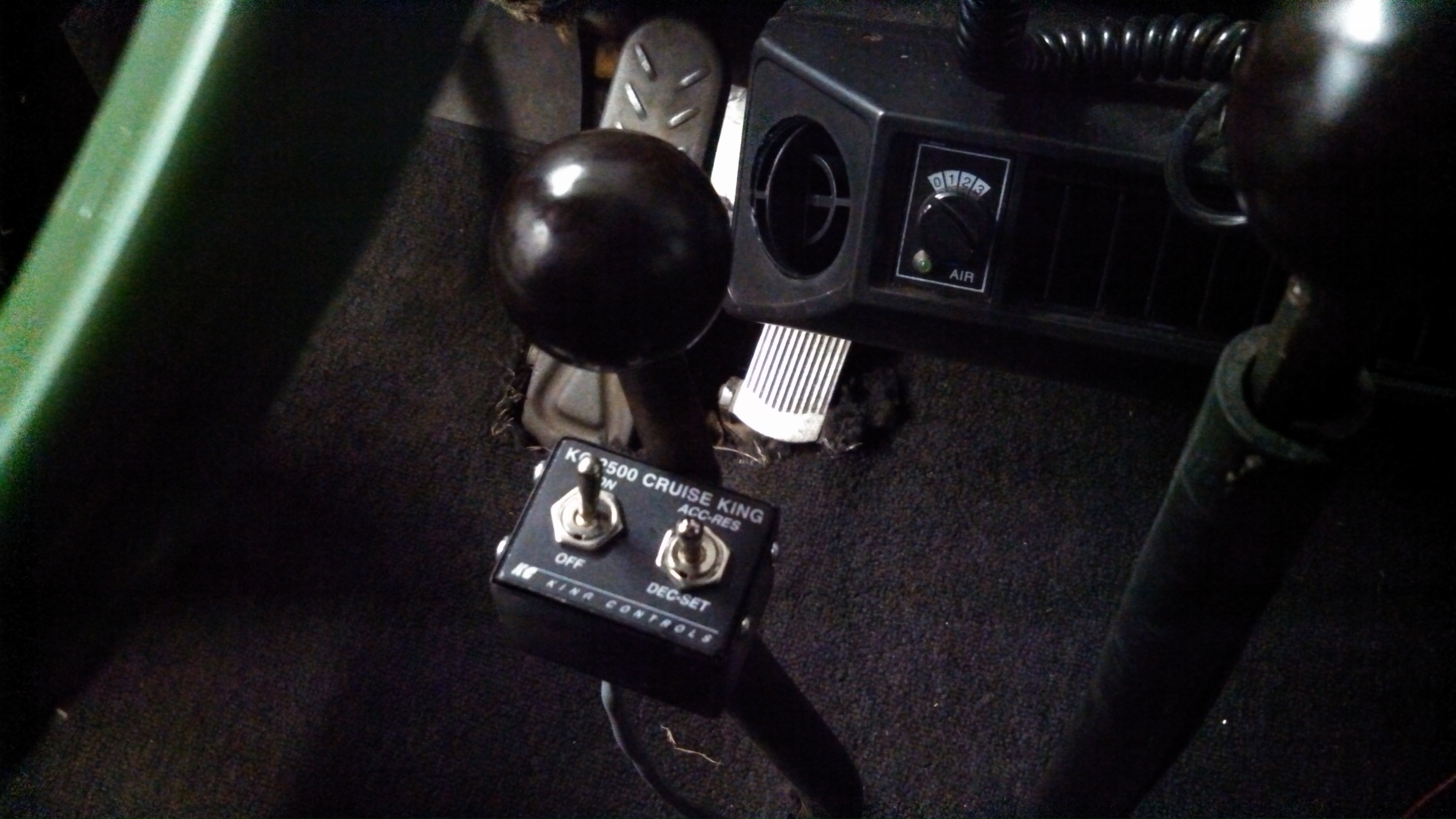

I know they did offer a shifter mounted unit with a dial on it for speed changes.  I didn't ask about it but I think I'm going to make my own little box and mount the two switches to the compound shifter handle.  That would keep them in easy reach as that is the shifter next to my leg and the most common to have to downshift first if need be on a hill.  Grab the handle and flick the switch with my finger..........sounds like a plan.  I have a small metal brake at work so making the box should be easy enough.

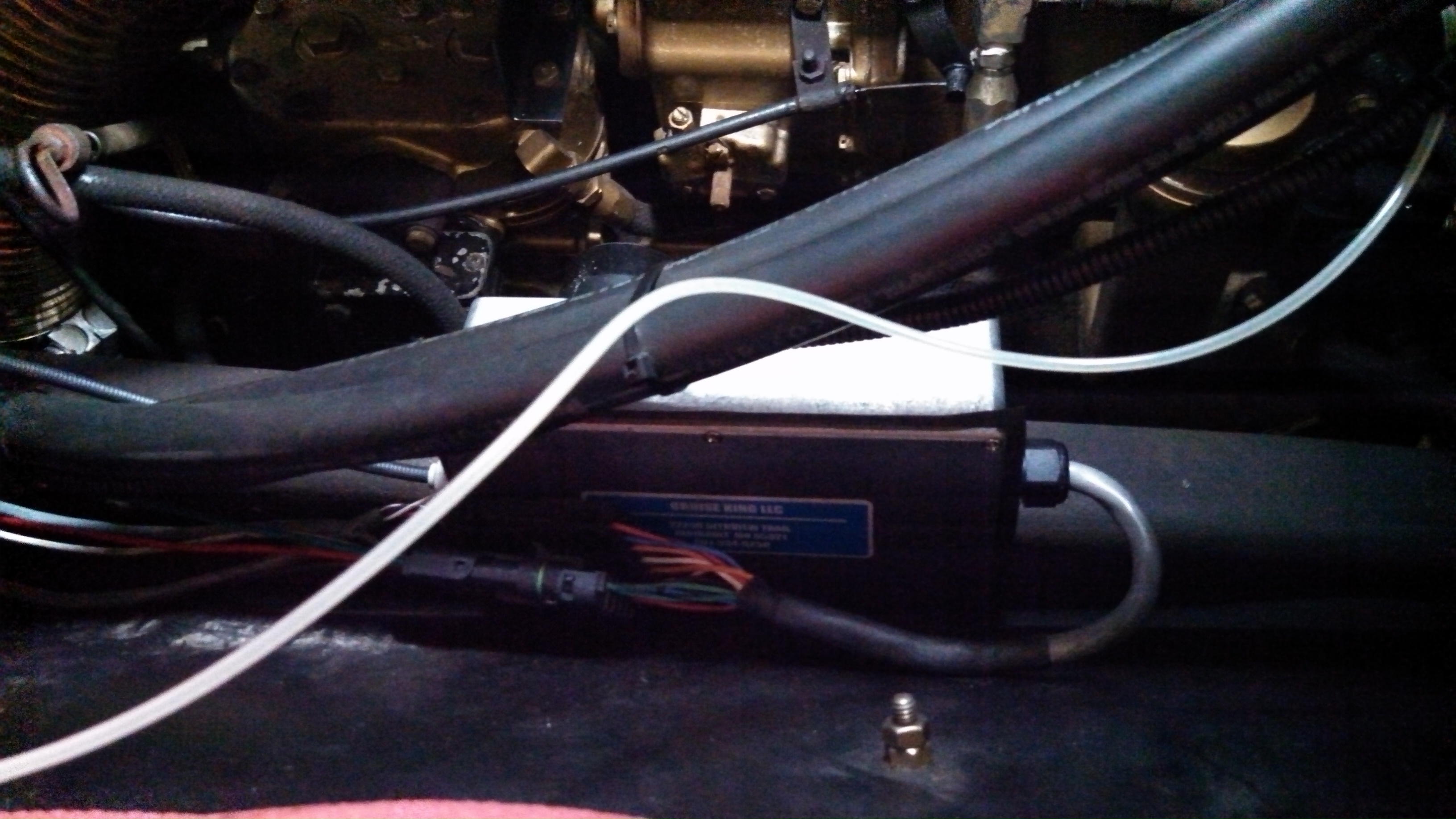

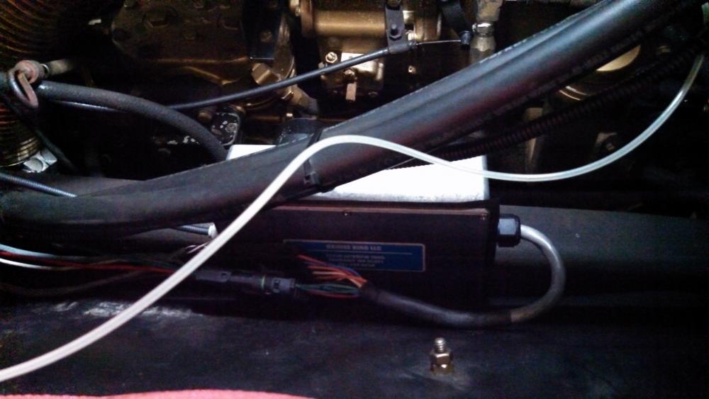

Did a little investigating with my new upgrade yesterday.   Seems the cable is wayyy too long for my application(go figure).  Without cutting things I will likely end up mounting it up in the very front corner behind the passenger headlight bucket on the frame.  That will give me the length I need to loop the cable down the inner fender and around to the throttle linkage.

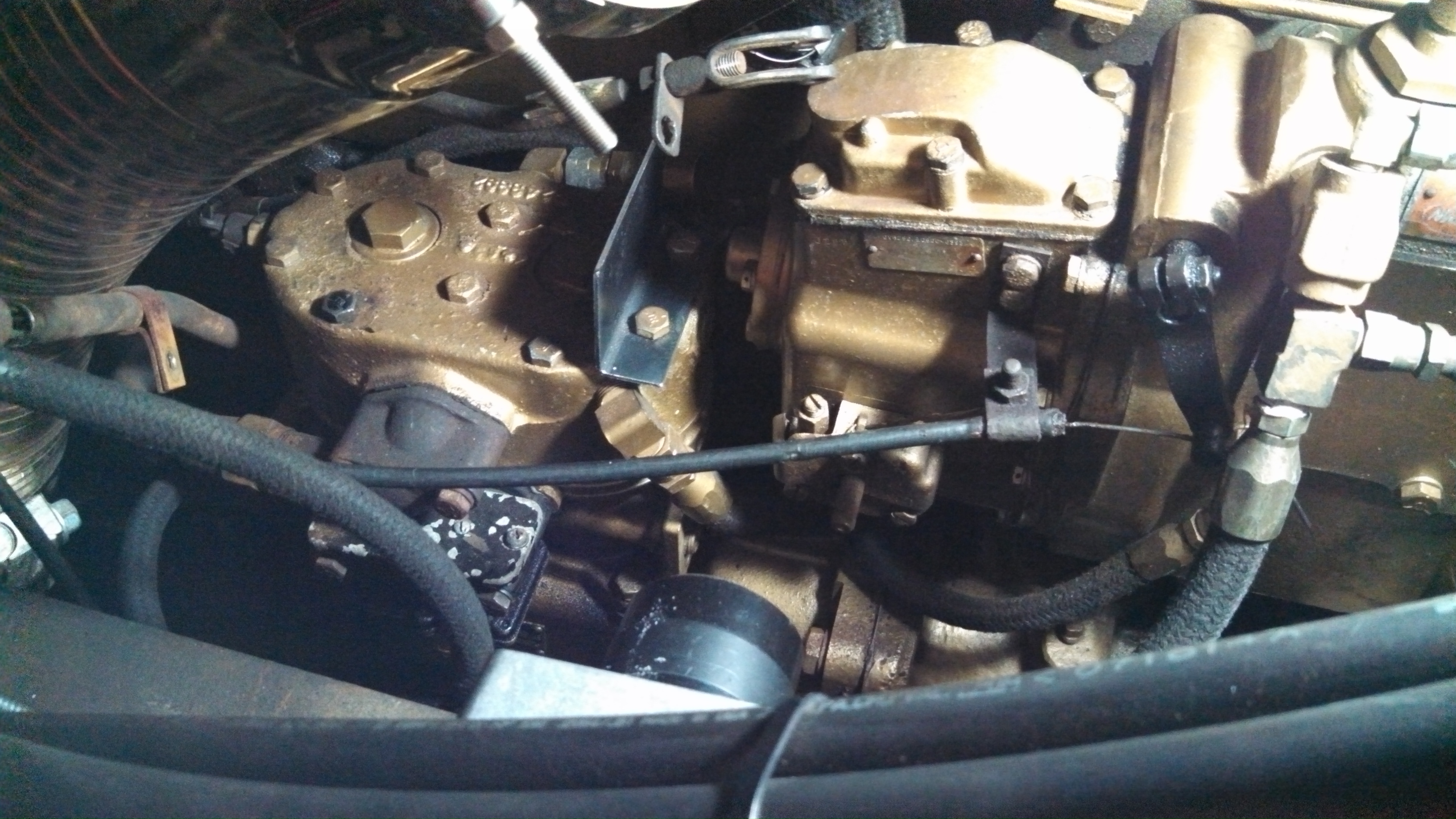

I send an email to them asking about the strength of the stepper motor as my return spring is pretty stout and worried about the ability for it to pull it and not damage it.  When I receive a reply I'm going to ask them about changing the length of the cable.  Do I have to return it to them or do it myself?

With the unit mounted so far forward all the wiring is no where long enough on anything so I'll be soldering extensions.  It does come with weather pak style plugs on the unit itself.
They offer a shifter mounted control box but I didn't want to ask what that costs so I am making my own little box to mount on the compound lever for my two switches.  That will be more driver accessible friendly then mounted on the dash(which is too far to reach for my driving comfort).

I had the switch and rheostat on the shift knob, and it was real easy to use... What the heck, your right hand is there anyways. After a while I got practiced enough that I could do clutchless upshifts, just quick switch the unit off then back on.

I have a drawing for a box for the shifter, just need some thinner material as I don't have anything lighter then 16 ga at home.  Some 20 ga would likely work much easier to bend into such a small box.  It's more decorative then structural.

Small steps.   Unit mounted on frame.  Making bracket for cable to mount to compessor.  Made a small box for switches to mount on compound shifter for "easy reach" while driving.  Few more wires to go.

By the end of the evening last night I had it "functioning".   I was able to get it to wind the cable up and return back by working the switches on the shifter.  My big concern was cable travel.  It only has 2" of travel.  The stuff they give you to mount to most late model pumps makes it seem it has way more then that.  I suppose the new pumps don't travel as far as mine does to get WOT.  I was expecting to have to make a long arm to use most of the cable travel(what they recommend), but after getting it to function I was able to measure and realize it will be tight to get WOT with only 2" of travel.  Measuring right at the pedal arm it is 2" for WOT.  I'll be having to fab up something so the cable attaches at the same spot.
