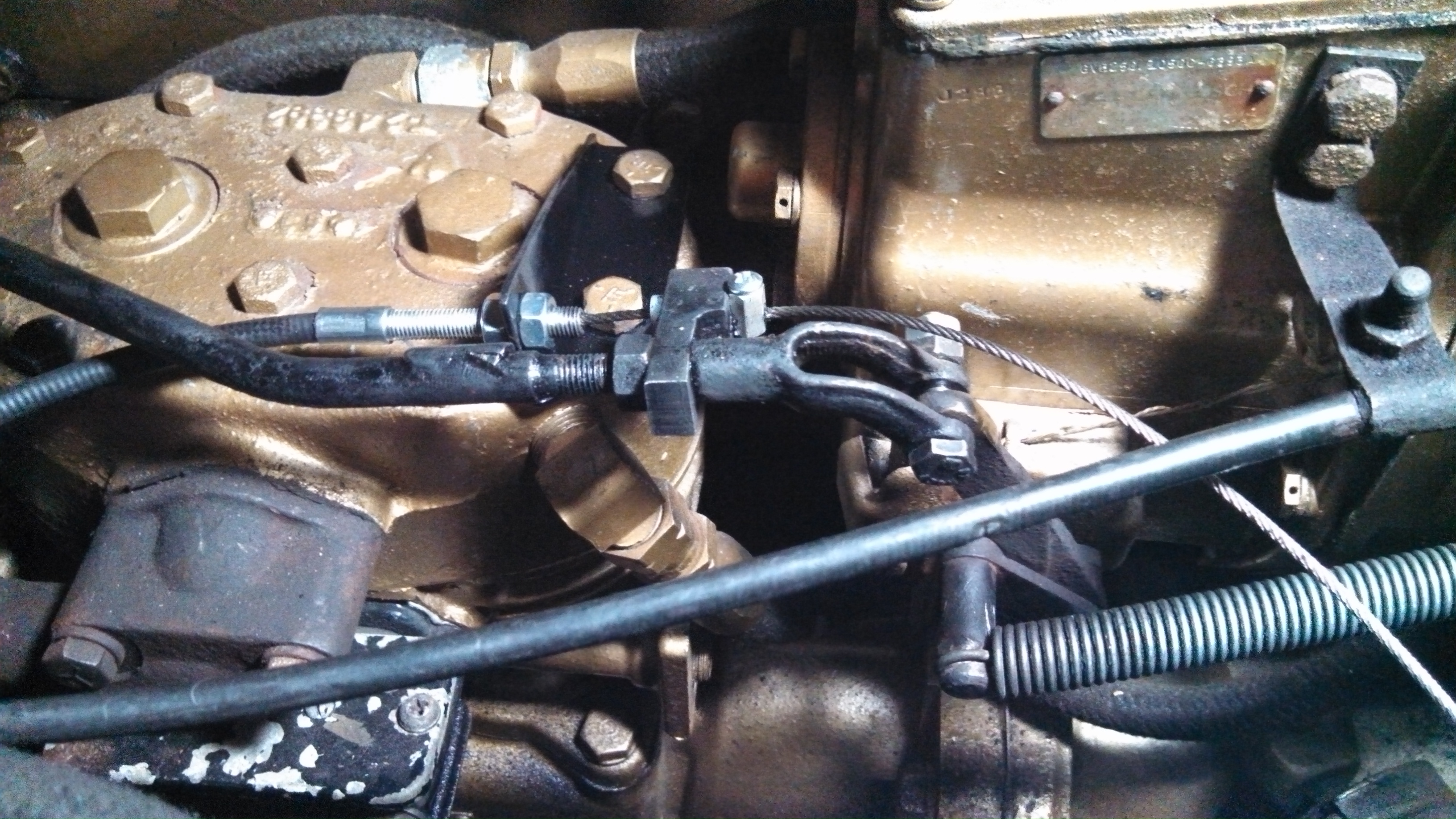

Well i got it finished up and working.  Made up my little bracket for cable and slip bushing for throttle.  Got it adjusted and works fine.
One note:  make sure your batteries are up.  Wow...i spent a few hours chasing my tail til I realized the batteries are down a bit and apparently it keeps track of input voltage and will shut off if under 12? volt, or whatever.  It started messing with me and I couldnt figure it out.  Hooked up battery charger and it works flawless.  Go figure.
Picture shows WOT.

The little bushing I made mimics the little sheetmetal tab that was on there for the hand throttle.  I just made this out of a piece of 3/8" square stock.  Milled a 1/4" hole and installed a nylon bushing(from home depot) for the cable to slide through.  They give you an alum arm with bushing in it to use, but it won't work with my throttle linkage.  All the pictures they give you with the instructions is all late model stuff.  Go figure.
I was also concerned originally about the release of the cable when you turn it off.  It snaps off, like it has a locking paw that releases.  Then you hear the servo motor run for 3-5 seconds, I guess to get it back to its starting point.
