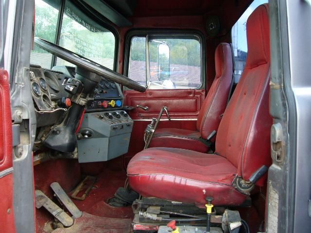

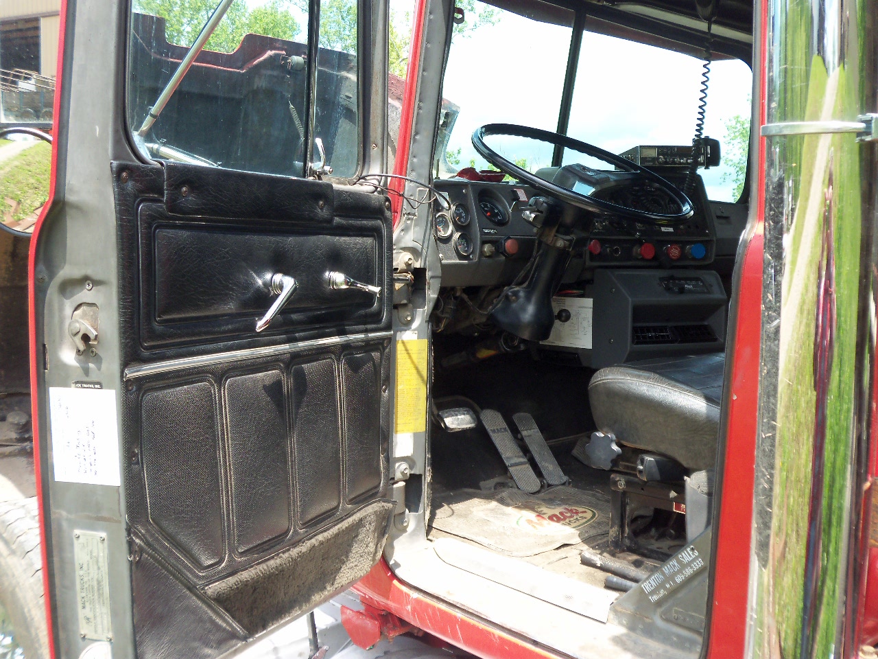

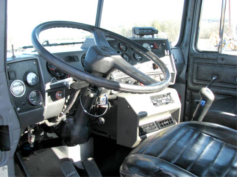

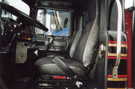

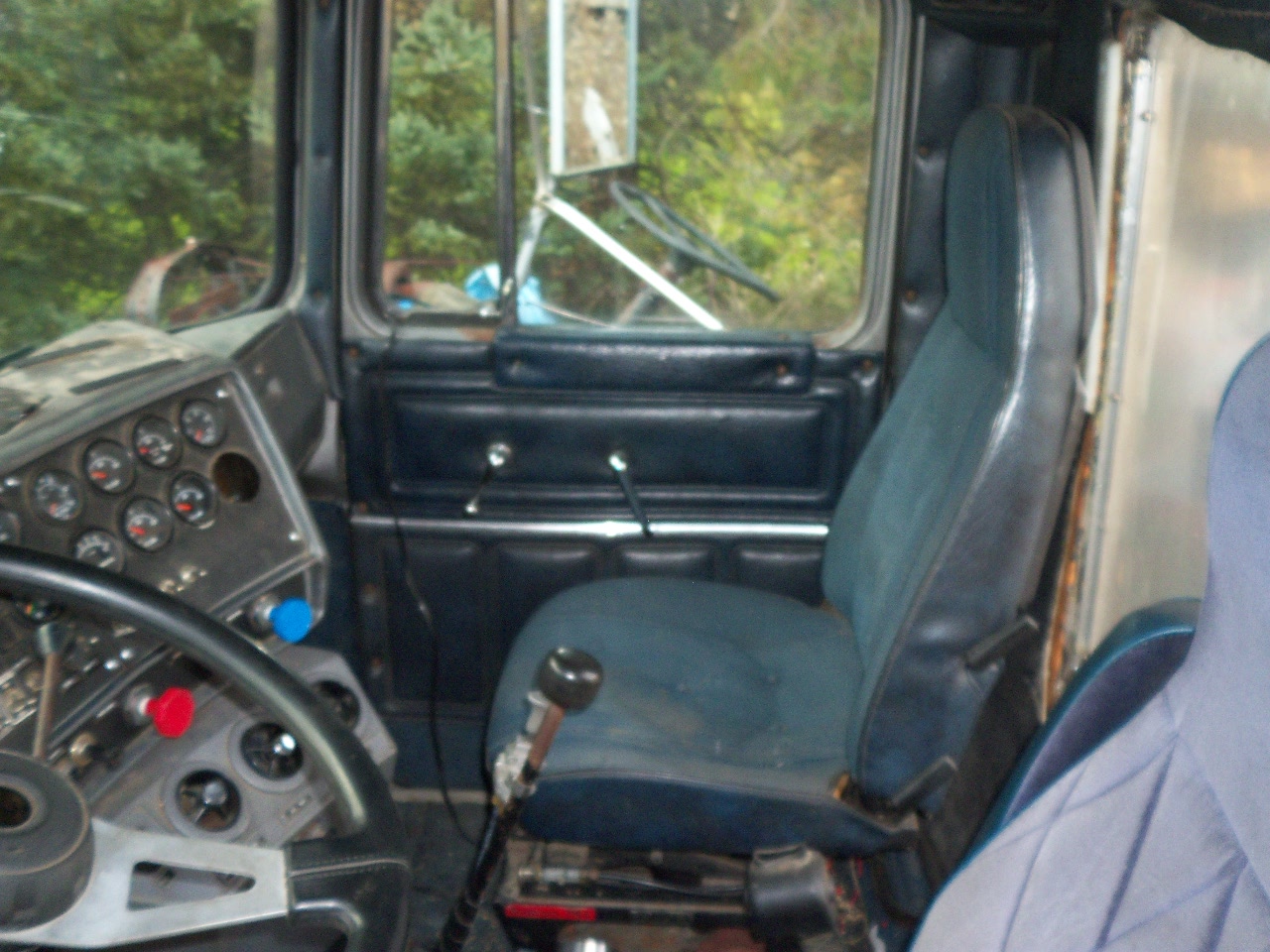

6 hours ago, Yoos Brothers Construction said:
Level 1 is grey with no door panels
Level 2 is grey with door panels
Level 3 is black or blue with full carpet floor and cloth seats
Level 4 is red(85-87) or grey(87-93) with full carpet floor, cloth seats, headliner, back panel, and door panels
I've included pic of all the interior colors with exception of level one(didn't have a pic saved of one)

On November 16, 2016 at 1:13 PM, Vladislav said:
Josh,
Minor question. Does Level 4 have the headliner and the doors lined with the same cloth as used on seats? Or another simiar material?
Unfortunately I don't remember a chance to observe it in person.
And thanks for the detailed explaining of the matter :thumb:
The bottom photo of the grey level 4 is a photo of  my truck the seats a a bit darker tweed cloth on the top and a marbled grey vinyl on the sides , the door panels have vinyl the same as the sides of the seats on the top followed by the soft lighter grey  cloth that the head liner is made from with grey carpet on the bottom  carpet in floor is grey  here's a pic of the door panel the lighting in the shed I store my truck in isn't good I'll take some better pics on the weekend if you want .
https://www.bigmacktrucks.com/topic/47679-rrw-trim-levels/#findComment-352275
Thank you for keeping in mind my interest.
Not much of need to make better pictures from my side, I have the most things understood.
Currently I have some parts of my R-model interior in the upholstery shop and going to reproduce them as close to the original style as possible.
My truck has level 3 blue color inside. The seats are with cloth on the main surfaces and vinil on their sides. The door panels are vinil with carpet at the bottoms, no cloth. And vinil headliner of perfarated material. I generally like blue but see no clue to have it combined with light green body color. So resolved to go with dark grey. Just had an idea to make doors of vinil top with something different in the middle. Maybe perfarated vinil or cloth. But it seems to me resonable to use the same material on doors as some other parts utilize. For example the same cloth as the seats do. Now I see Mack did different way and I generally dislike it. As for the seat cloth itself I hope to save my original stuff just combined with new vinil sides. So no spare seat cloth to put onto the doors if I want to.
