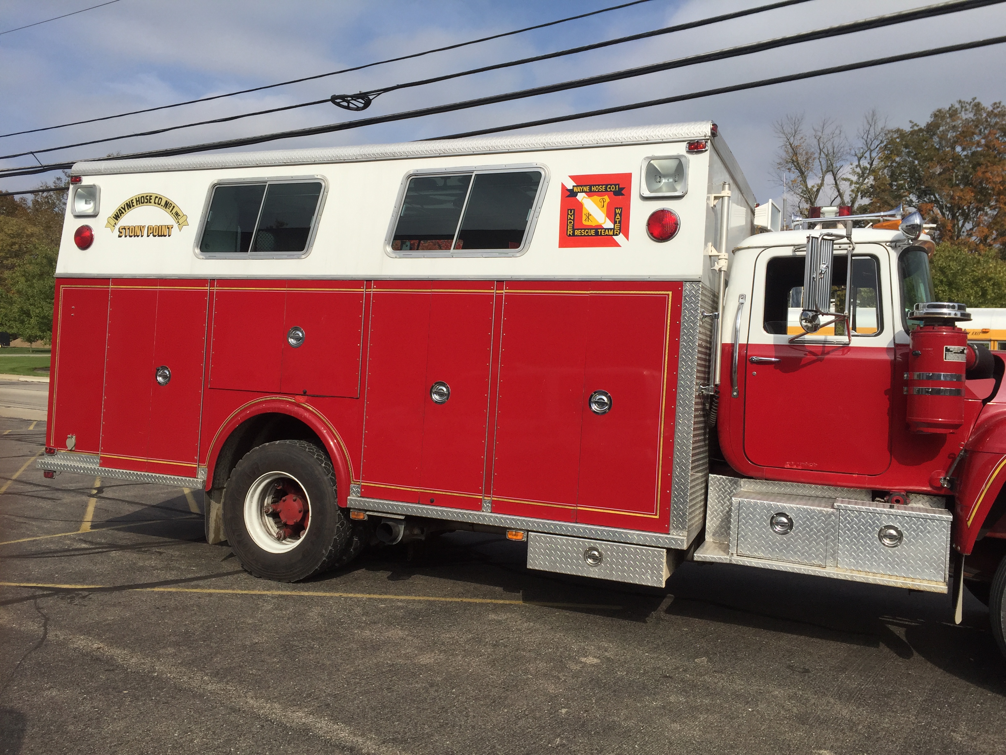

Recently purchased a 1980 Mack R series Rescue Truck. I will be requesting information from the Mack Museum soon, but want to change the fluids now and I would like to know the capacities of the fluids, oil, water/antifreeze, transmission. Truck serial # R611FC-1057,  motor type ETZ673 ( might be RTZ673, my copy not too clear). Transmission is a HT-740D. It is a diesel motor with a turbocharger
