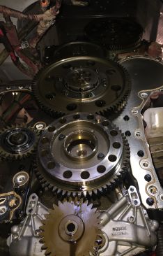

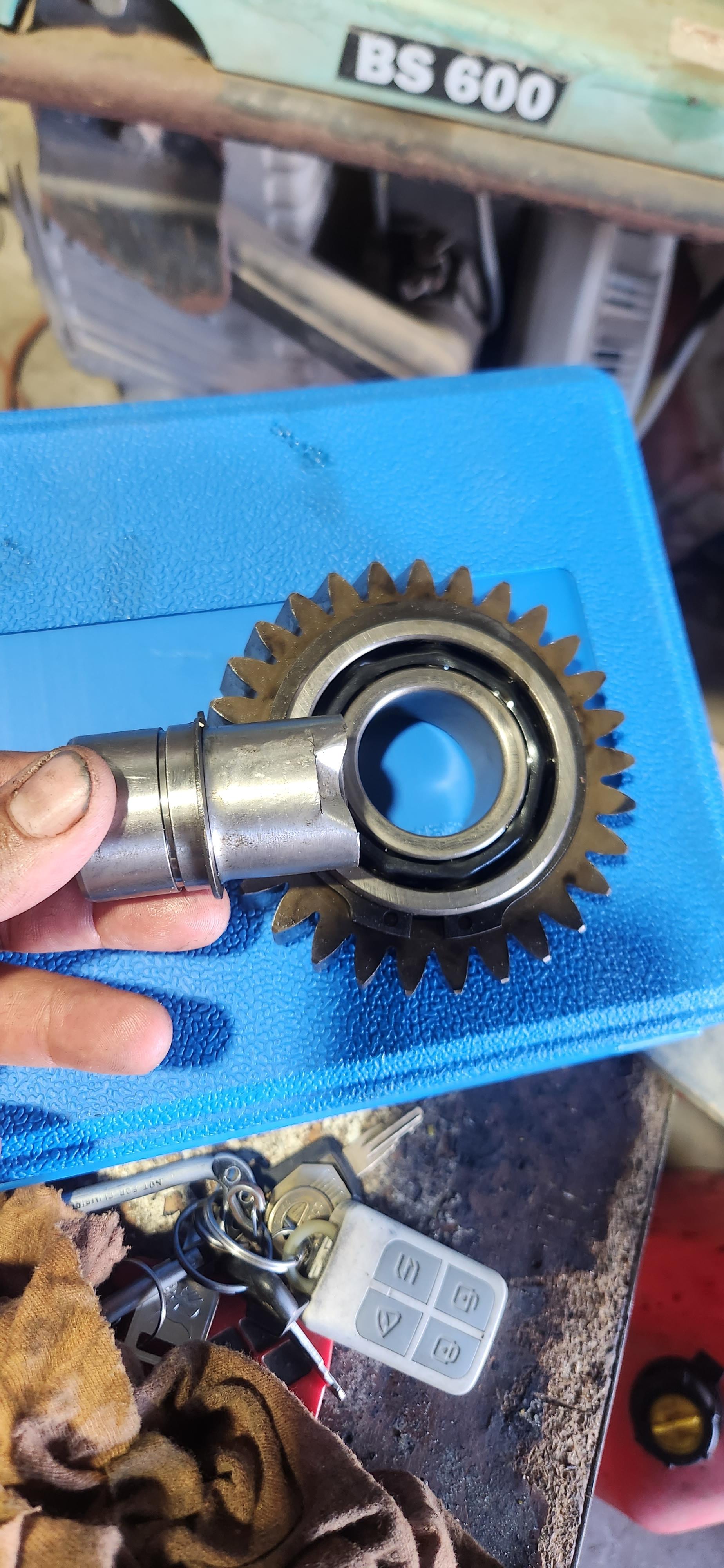

Fjh speaks good sense here..  its been at least 6 years since i made one of these repairs. One of the last ones i did, i pulled the MP-7 out of the GU chassis.  When you get the new compressor gear, be sure to get the correct diameter gear, there are 2. The small one will not engage the other gears. One of my co workings taught us that the hard way..  I wish you much success, is the housing easy to find?

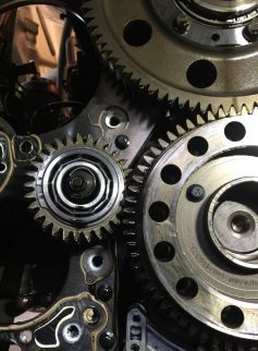

We've had several geartrain failures on MP engines the three years I've been here. I don't remember how many were MP7's or 8's, but I do know the air compressor gear was almost always involved. I despise the rear gear train design, it's a massive headache for the tech working on the crap.
