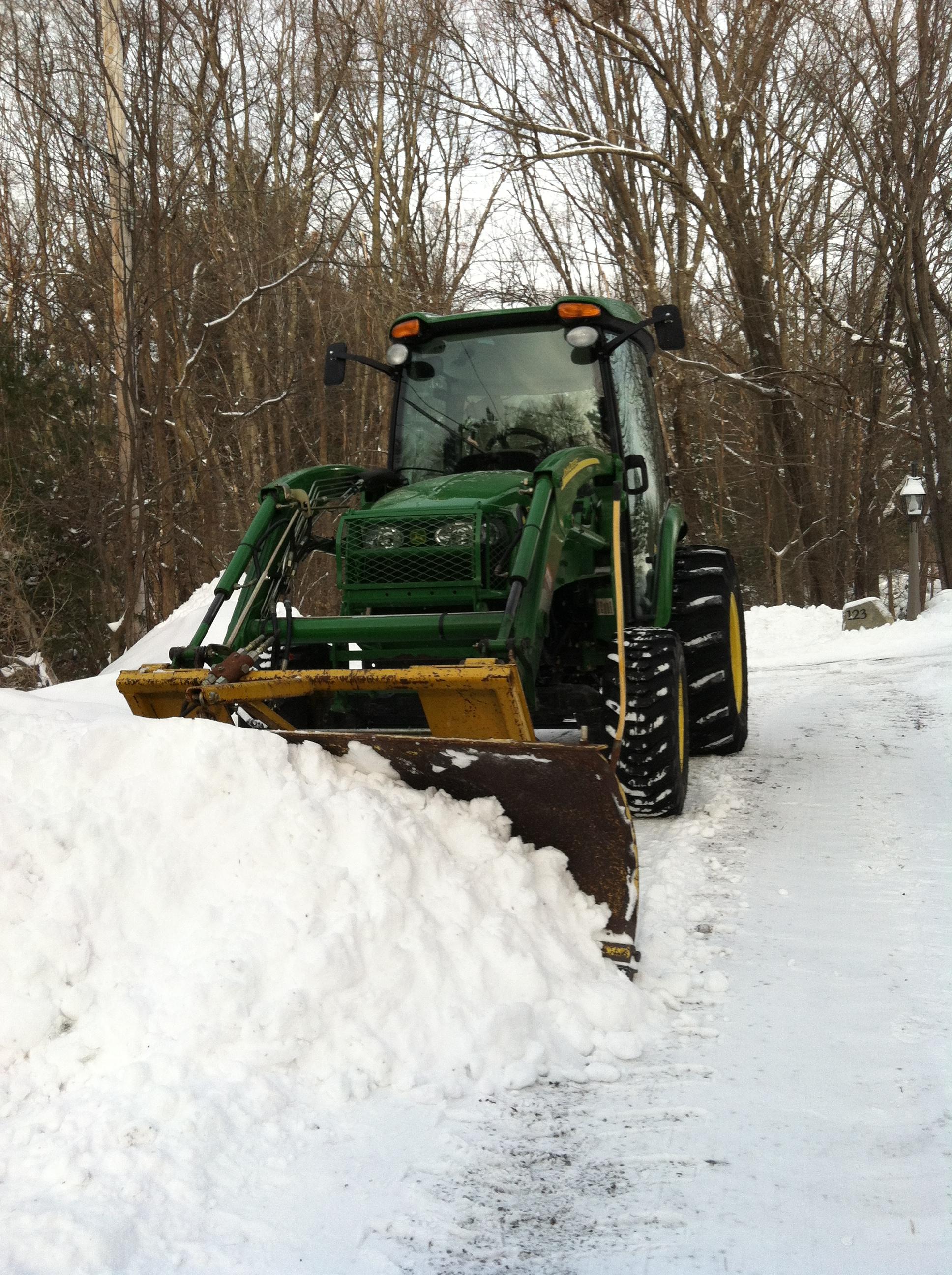

Here is my previous ride; Kubota 3430 with a Meyers 7.5 blade. I just replaced it with a Kubota 4060 cab tractor which I haven't had time to get pictures of yet.
Well Fxy good move on the cab- after years of ice on my glasses and soaked Carhartt coveralls-they are pretty waterproof for the first 15 minutes I got rid of the open stations (755, then a 3320) and got this 4720 cab-I convinced the wife it was cheaper than treating me for pneumonia.  Loaded tires and about a 550 lb concrete block I cast with a receiver hitch built in.  Blade is a 6.5ft- I shop at Junk yards-looking for a 7' now-machine will handle an 8 but too tight for bay I keep it in.

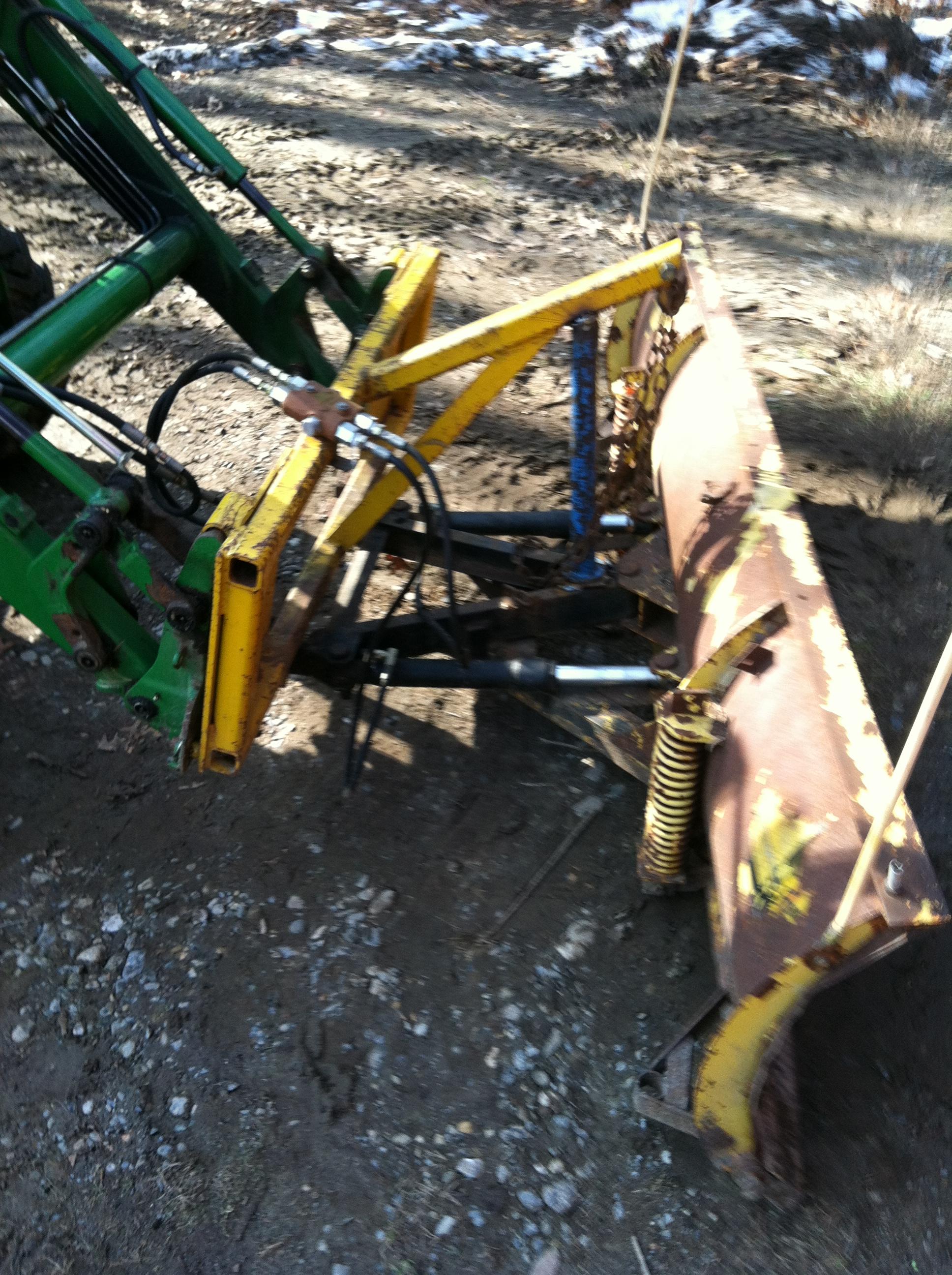

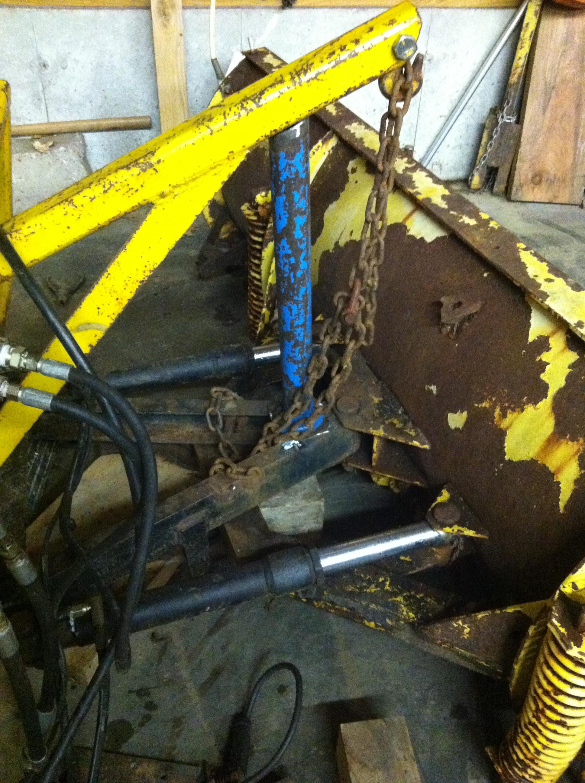

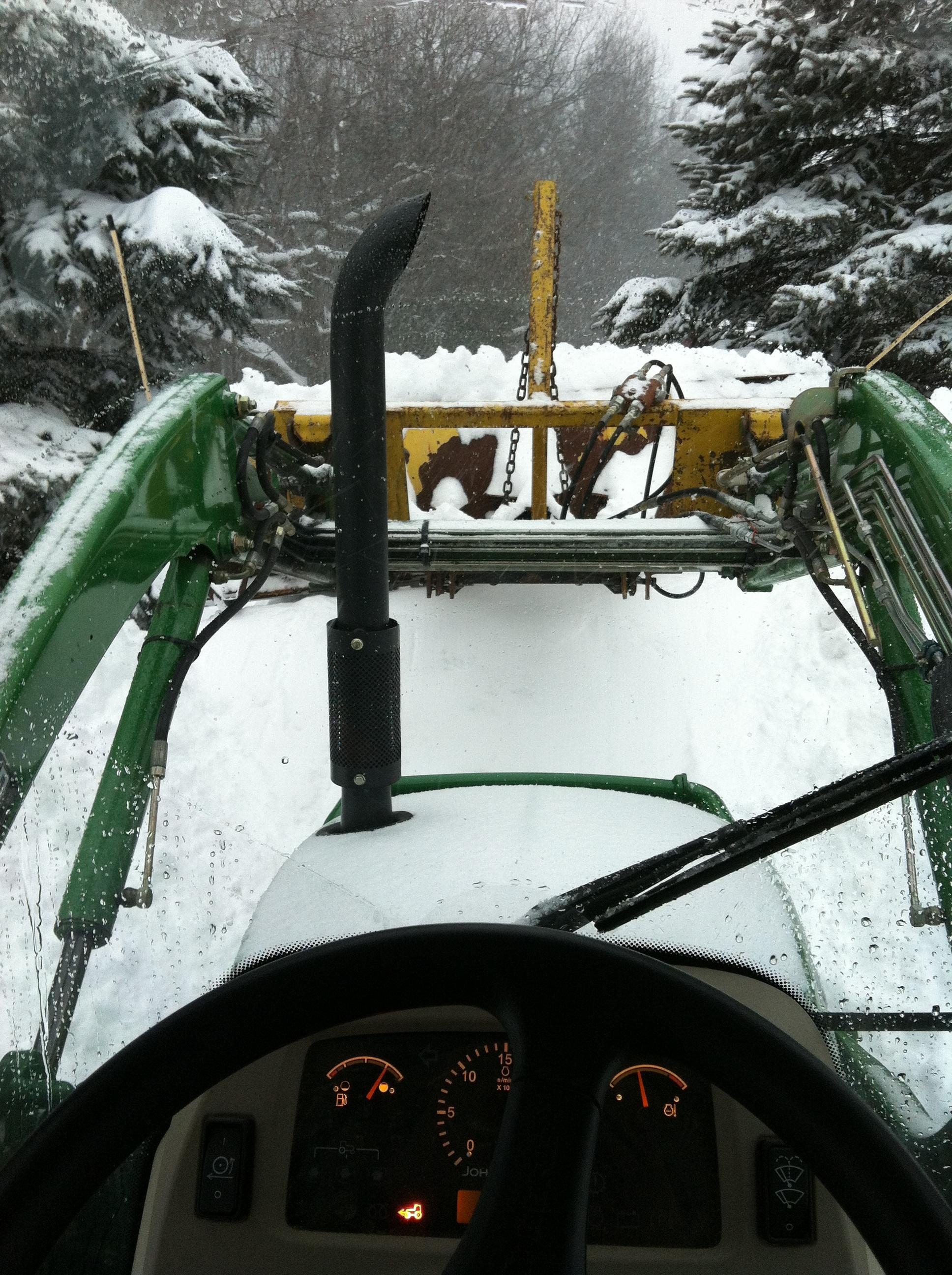

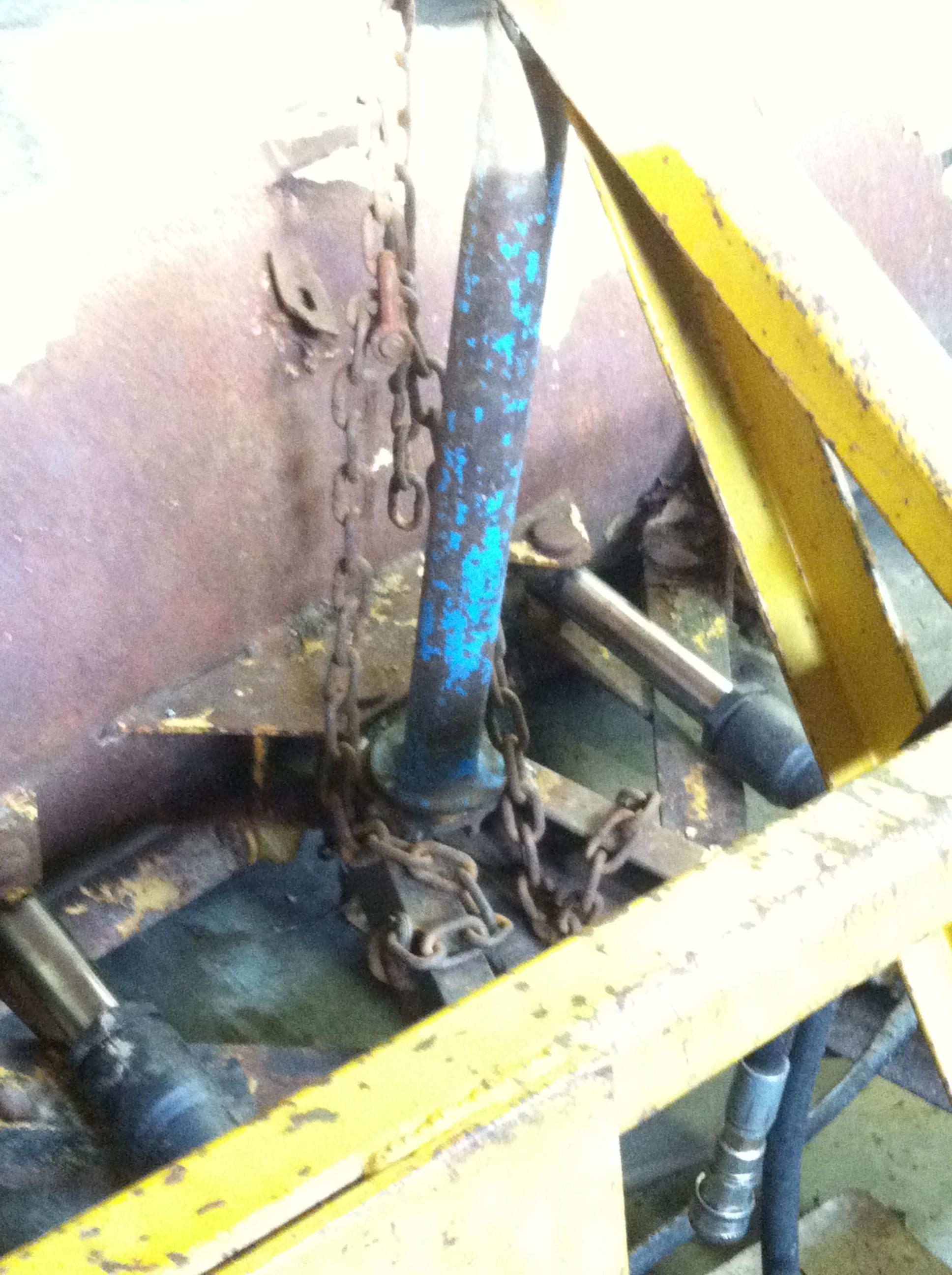

Should have added this for what its worth.  Like a lot of guys I'm plowing with a conventional power angle snow plow hung off a loader in place of the bucket.  And like a conventional pick up equipped with a typical Fisher /Meyers/ boss etc you have no down pressure.  This makes it difficult to clean out up against garage doors etc.
To correct this I welded about a  2" D Sched 40 pipe (its blue in pix) to the lift arm that the lift chains are attached to.  This is positioned such that when I lower the plow, I roll the "bucket" control (quick attach plate) forward and the pipe then makes contact with the plow A frame.  I can now put all kinds of down pressure on the blade.
See attached shots-works very well.

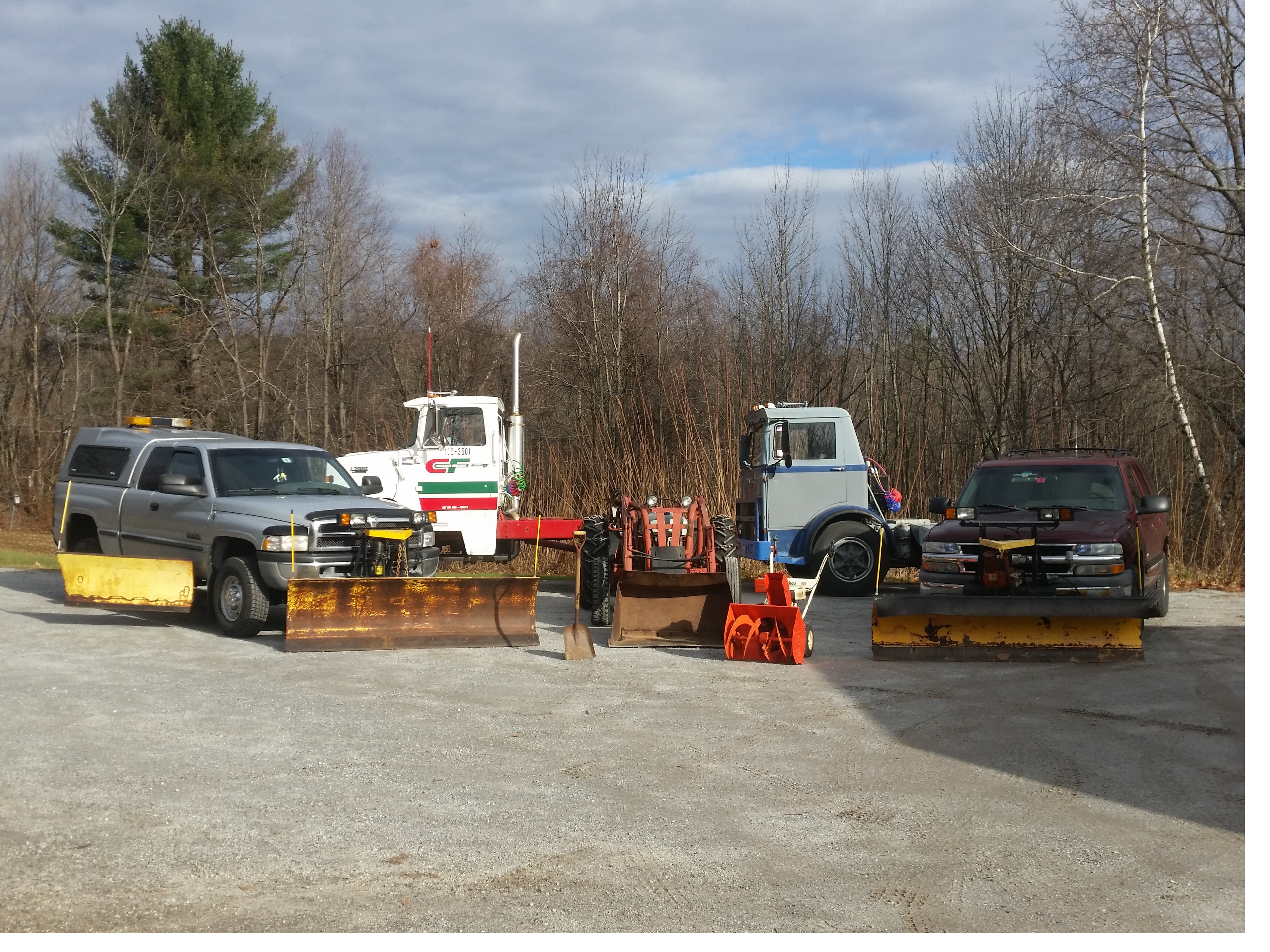

We got our crew together today. '99 Dodge 2500, 7.5' plow & 4' wing - Stand alone shovel (How to downsize a road crew in half) - '90 Ford LN7000 - '52 Ford 8N - '74 Ariens - '70 Mack MB607 - '01 Chevy Tahoe, 7.5'LD plow. Pay no attention to the plows not being painted yet!    Hippy and Ricky
