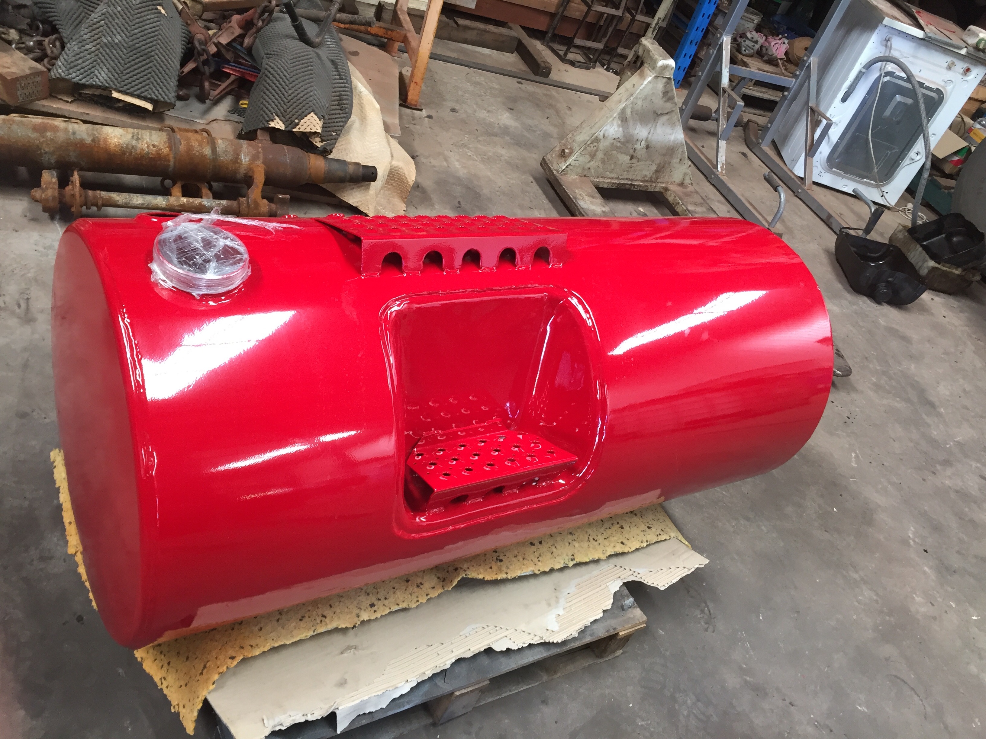

I did the same with one of my aluminium ones on the R locally. Locally was 700 km from home though :)
They made a new tube but couldn't offer the bottoms of the correct size. So my old ones came back together with the steps, filler neck and the drain pan.
