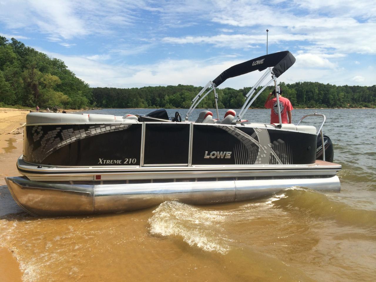

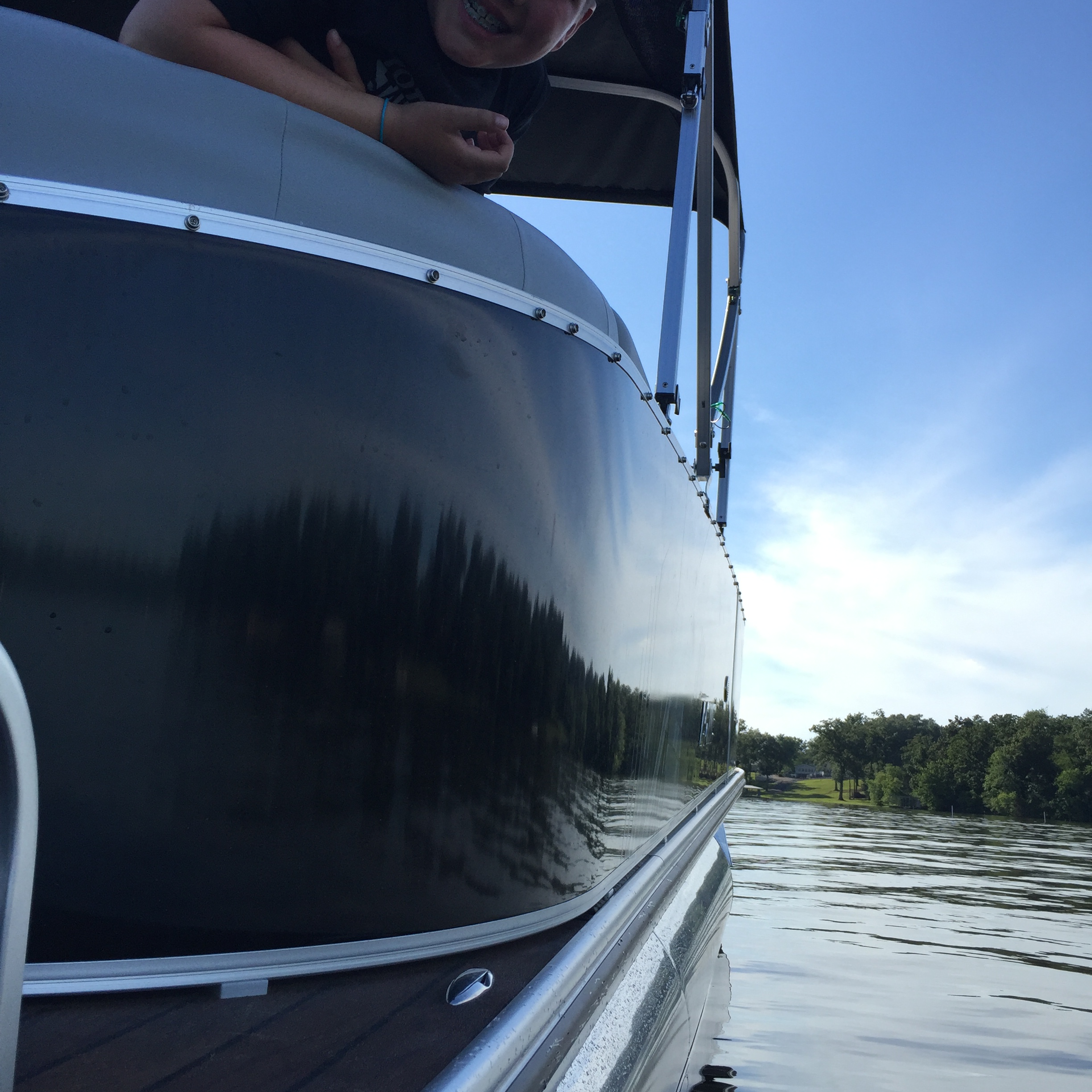

It takes alot or work , In two years I've worn  3  high speed buffers  polishing  my tri-toon.  Then its a constant job to keep it looking good.  I spend about an hour a side every weekend in the summer.  I use White Diamond polish then wash the haze off with  a rag soaked in mineral sprits and then wash with soap and water  before anything dries. .
