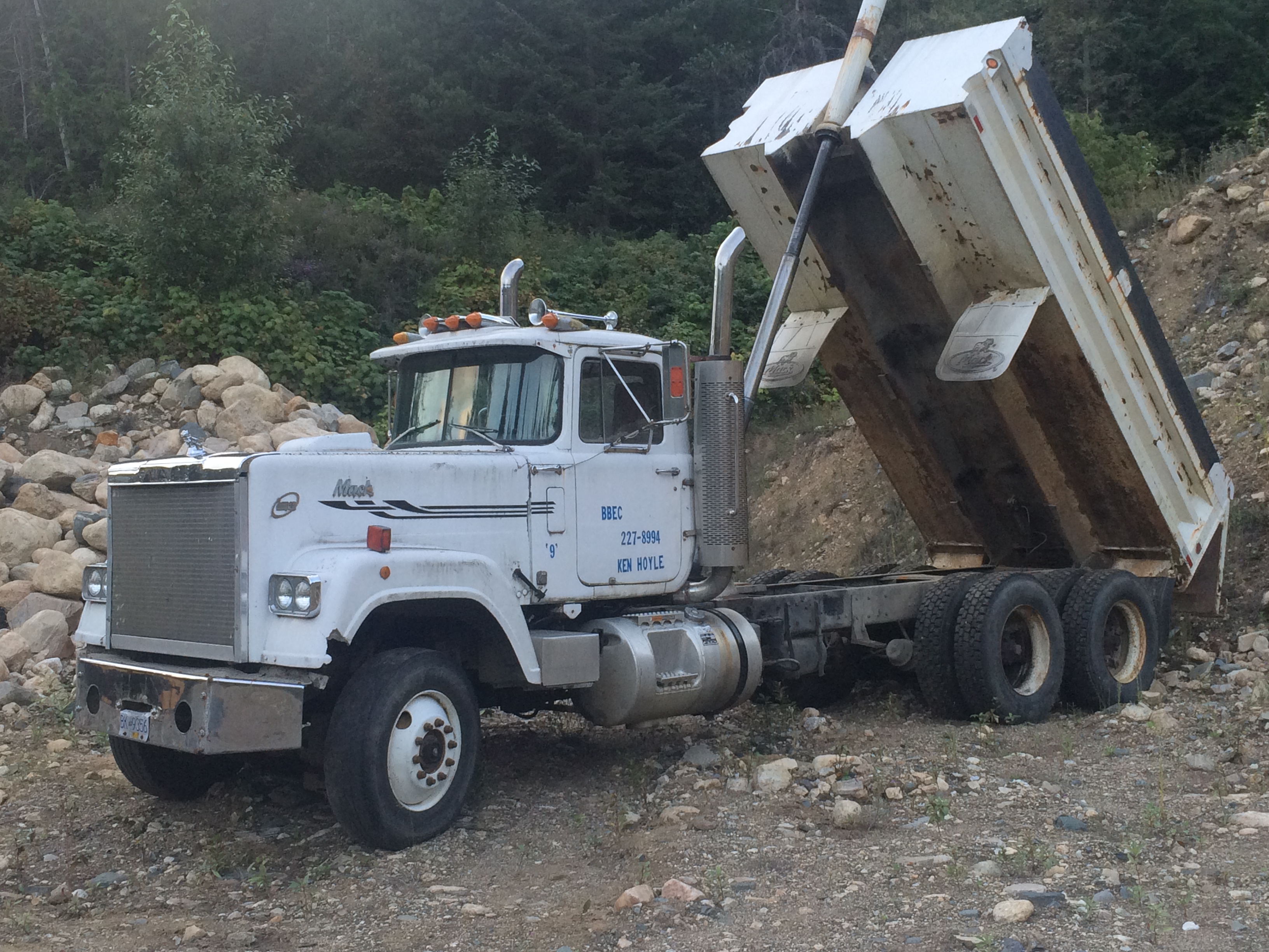

I've been reading as much info as possible from all of you but I'm still today unable to locate the chassi VIN for my 1985 Superliner.
 Went and look everywhere, driver side, passenger side, under the cab, above front axle... to no avail.
 Any other locations? Should I start looking inside the C channel?!
The reason for the need to have the VIN is to figure out if the front axle is properly identified for the weight/load capacity.
 Thank you for your help

Okay, so based on the stamping, your truck's front axle mounting arrangement is 1QH39315P5 (that's a 5-digit Mack Western type arrangement number), and the model is, as we've already mentioned, FAW5371C (FAW537 series, 12,000lb/5,443kg).
Mackpro, what was the number of the 1QH arrangement you saw, when looking up RWS721LS-1528 ?
From your pictures, this appears to be a single rail chassis. Some bridge formula mixer chassis ran single rails because the mixer body acted, to an extent, as a supporting subframe. But my experience was we had crossmember failures and frame rail failures. Your truck has a far deeper frame rail than an R-model, but I question the long-term durability of this truck in tipper service when articulating off road. As I mentioned earlier, a (self-steering) pusher axle could help two-fold.

Here are some pictures;
#1:   The door...
#2:    Front axle, I'm standing on the passenger side, facing the forward part of the axle, shooting the picture slightly upwards so you can see the leaf spring
 VIN is what I wrote.
 FAW 537C1 is stamped on front axle.

Now, we know you have a 12,000lb FAW537 steer axle (typical of a tractor).
Mackpro saw it was built with 3-leaf taperleaf springs. However, your truck presently has 11-leaf multi-leaf springs. Perhaps, they have adequate spring capacity, but your FAW537 axle does not have adequate capacity for tipper operation, particularly given the tremendous weight placed atop when loaded given the far rear location of your bogie. The only way to resolve the situation is to add a (self-steering) pusher axle.
Is your frame single or double channel? If double channel, was it added, perhaps of limited length, or does it run the full length of the chassis. If this was a tractor, the frame probably isn't reinforced for the flexing that a tipper will see off road. The pusher axle's mounting flange would help reinforce your frame somewhat, while allowing your 12,000lb steer axle to live.
