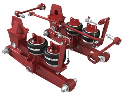

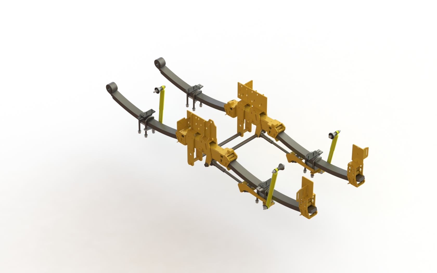

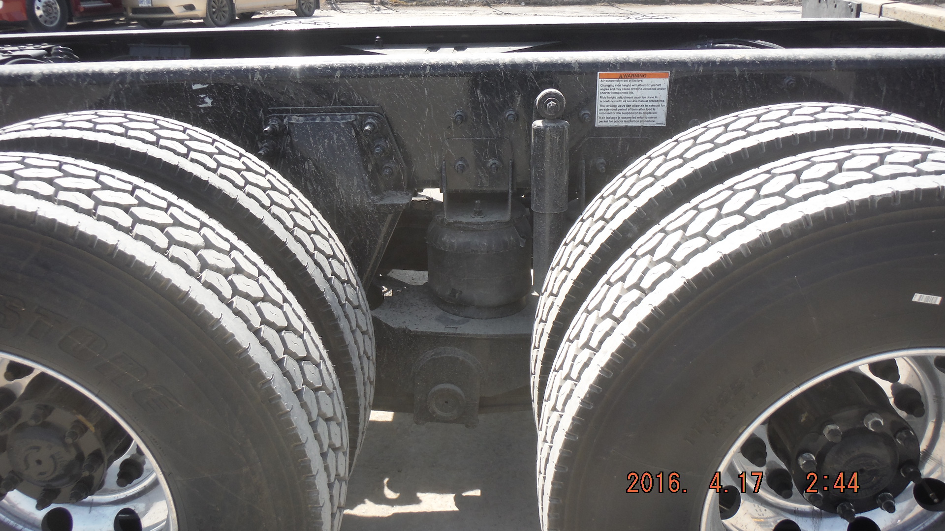

Anyone run Raydan (now Hendrickson) Air Link rear suspension? It's basically the old Hendrickson walking beam, but on 4 air bags instead of springs or rubber blocks.
In theory it looks good. Gives the articulation of walking beams, and the bags have rubber stoppers in them, so it says in the event you loose air or blow a bag they can be ran deflated.

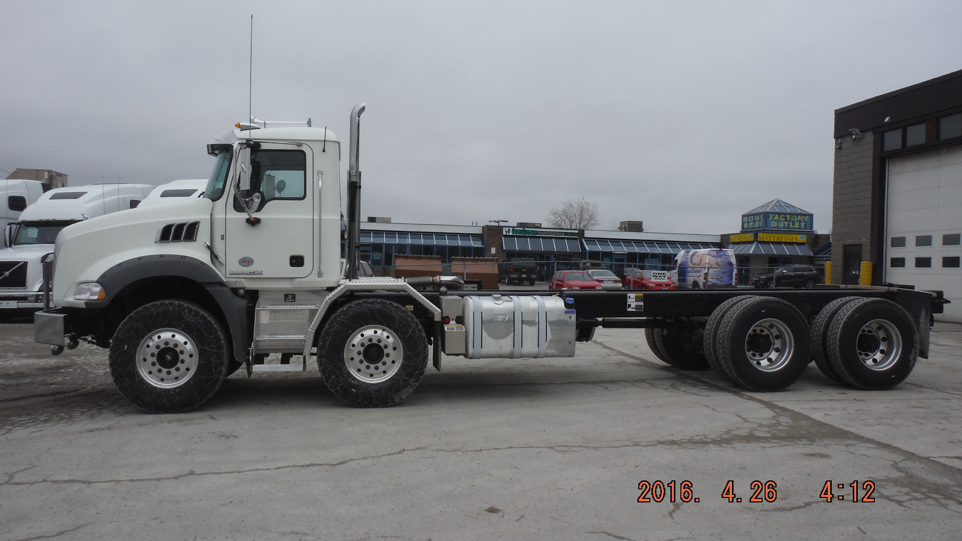

Has an MP8 505M and Allison auto. I'm waiting on pricing for one with 14 speed M-Drive and M-Ride with Mack rears.
Will have a 22 foot dump box.

We have dozens of raydan here it's ok real fussy to set the ride height  raydan both ends? As with almost any dump you'll need to dump the bags to get the load off. We have a half dozen twinsteer mixers with it here no complaints.
Edited by fjh
Just the raydan not the one you have pictured there as I I said the air ride front is quite complex However the ride quality is good a bit on  the sqishy side As with any air ride the shocks have to be kepted up on !We have sold mixers a few  with the raydan  and most often the AMS40T2 !
Both work OK from a customer stand point Usually A simard install
If I was doing it I would go for spings  stability wise  I think having a dump on total air you would feel horribly tippy when dumping Mixers dont have 20 feet of material in the air.
Edited by fjh
We had a Raydan come in a few weeks ago where the bushing attaches to the beam split.  had to replace the beam. it was a twin steer dump on a large dump fleet customer in Toronto. I wouldn't bother with it.  plenty of other proven suspensions available. I'm starting to see more Simard twin steers coming in with helper air bags on the spring centers to the frame. one large cement customer has them on all.  that looks like mid Ontario Barrie you are shopping at.

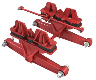

i have blocks in both trucks...and while they are AWESOME in the muck, they ride like crap empty.....ive been bugging the boss since i found out about the AR2 to convert the Granite, for my comfort and to save the beating on the truck and the bins/equipment i haul.
after putting nearly 120,000$ into the RD, hes a bit gun-shy.....
2011 Granite has this, with Meritor Rears
1989 RD has this, on Mack Top-loaders.
Both can supposedly be converted to this:
Edited by j_martell
Lack of planning on your part does not constitute an emergency on my part....

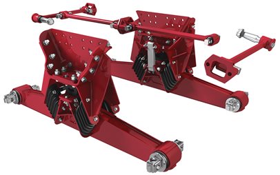

I had that first one (HMX) in my Paystar. It did ride good for rubber block. The second one with the big blocks holds up better in logging.
And the last one is the same as Raydan Air Link. Hendrickson bought them. And did also offer it as a conversion kit.
Funny thing about that Raydan Air Link though.....I had Mack reps at the Truck World show tell me years ago that they didn't like that because it puts too much stress on the frame because it has only that one mounting point at the pivot.
But I can't see how it could be too bad with both axles having transverse torque rods?
That's why I wanted to see what your opinions are.
Likely because both the rubber block suspensions mount via a cross member right in the centre of the tandem, with torque rods fore and aft, spreading the load better across the frame. easy to have a cross member--> Torque rod -->centre section --> torque rod -->cross member. Versus the AR2 with the mounts to the frame ahead, and both torque rods aft, placing all the stress behind the cross member.. best you could get is the mount, then both torque rods, then a cross member, leaving a large amount of un-reinforced frame to take the stress.
I hope that makes even 1/3 the sense it did in my head lol

Very few order camelback up here anymore.  Lots of trunion and spring issues over the last few years here.
I got to see an m ride fail that was less then six months old on a front end loader. broken torque rods and and all.
Every mixer company in Ontario right now is ordering Chalmers still to this day. Hendrickson is your best bet in my opinion. most of the reps don't even get involved in how the customers spec is doing on the road.   they just input orders. talk to the fleet owners.  get the real story.
I love Camelback, but they are also expensive to rebuild here.  So you are seeing M-Ride fail? I figured they would be good because they look very much like Tuff-Trac and we ran a few of those and they are bulletproof.

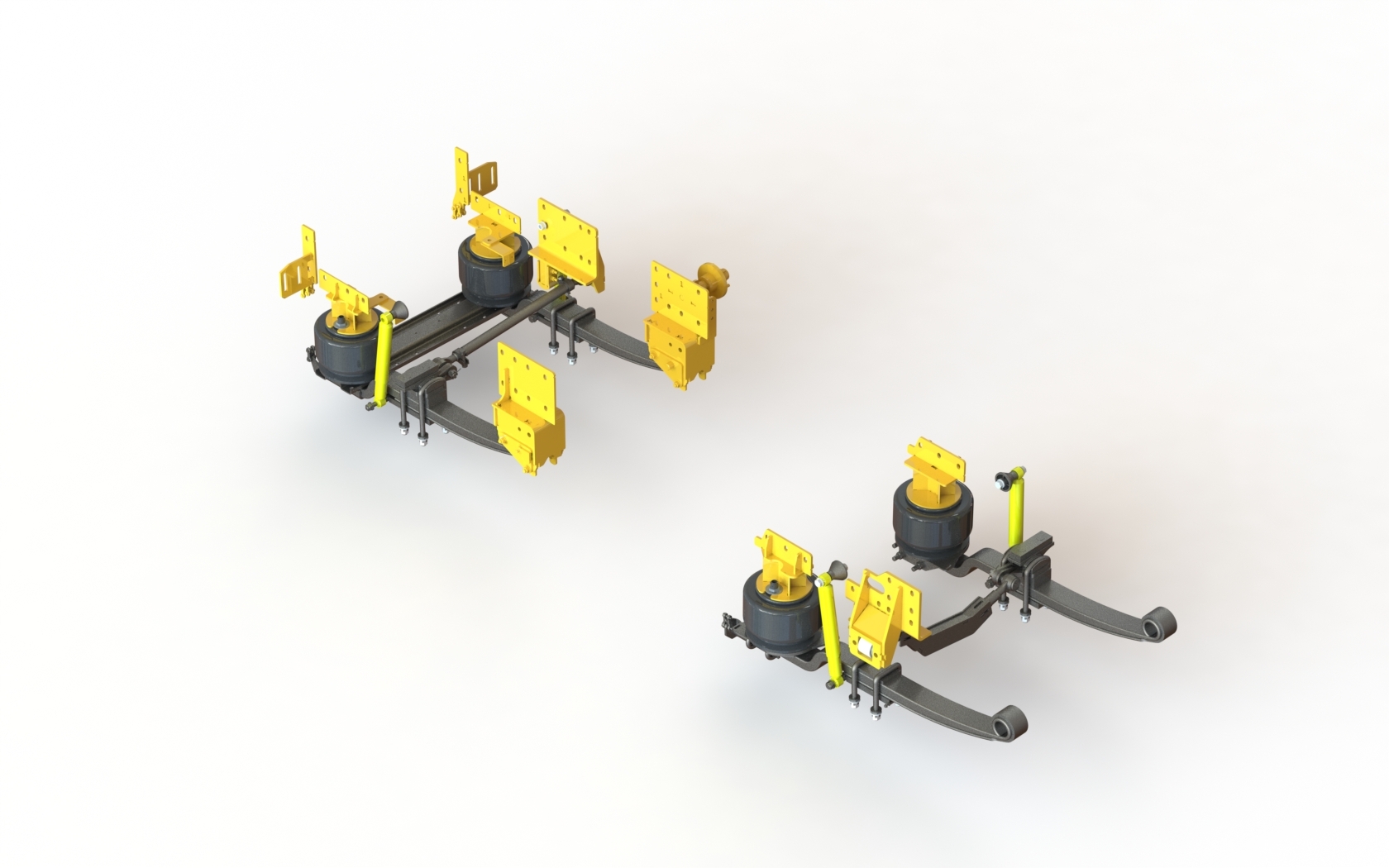

we had a super 18 with air ride rears .....it likes to lay on its side  every so often. the Ar2 doesn't have the internal rubber stop blocks that the raydan does, I was pricing one for my superliner , Hendrickson will no longer sell just the upper air ride conversion for the existing walking beams they now want 12k for the conversion, raydan was around 8600.00.  Raydan claimed that for off road or on site overloading applications to deflate the bags and ride on the interior blocks. If I remember right they would allow an extra 12000lbs when deflated.
