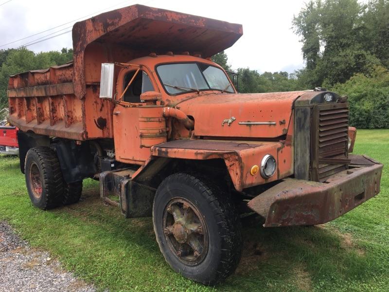

They made a lot more B81X and SX 2626 . The fenders for your B80 are multi piece and a metal shop with a metal bending break can easily form up the parts. Some o time with a MIG doing Plug welds and your ahead of the time and cost of finding decient used replacements.

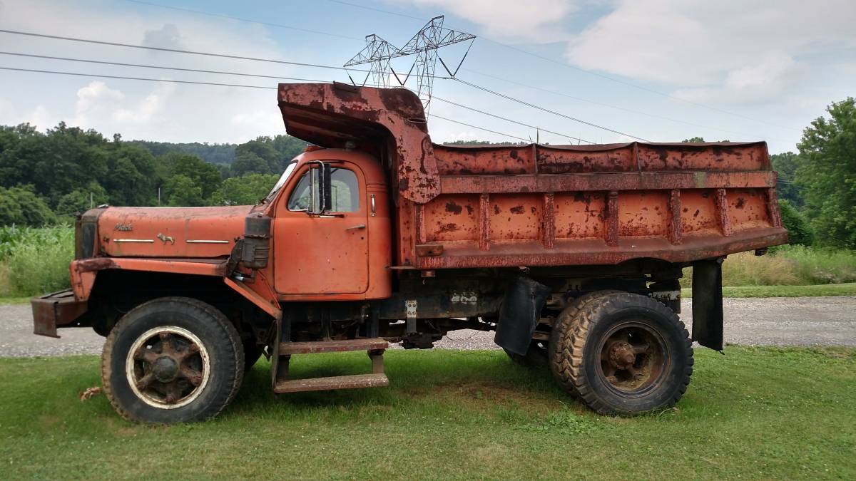

Looking at your photos I personally would straighten them out, Bumper too. A bit of heat and a gentle tug and 90% will straighten. The aren't torn or rotted from what the photos show.     Paul

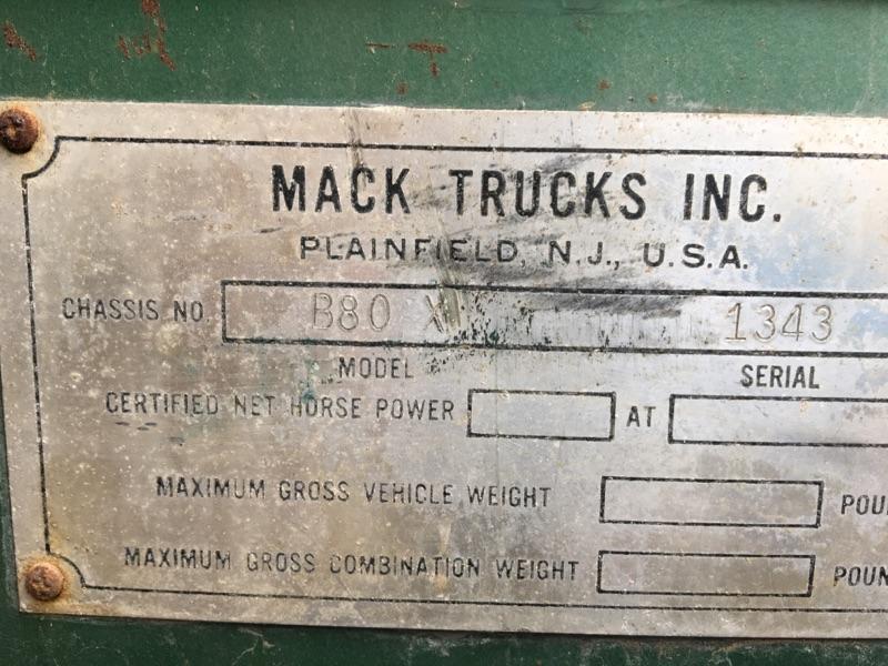

Send the chassis number to the museum with a suitable donation and they will send you quite a stack of information about your truck including who the original purchaser was.
I agree, the fenders are easily repaired. Pull them off, sand blast them to find out what you have and start "heating and beating" to get them into shape.
