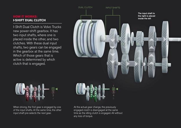

I-Shift Dual Clutch can basically be described as two parallel connected gearboxes in one housing. One gearbox contains the even gears and the other has the uneven gears. When one gear is active, the next gear is pre-selected in the second unit. When shifting changes from the first gearbox, the other is poked in. This provides ratio changing without any disruption in power or speed.
The I-Shift Dual Clutch has two input shafts, one located inside the other, and the two clutches. This allows two gears to be engaged simultaneously. Which of the gears that is activated is determined by which clutch is engaged.

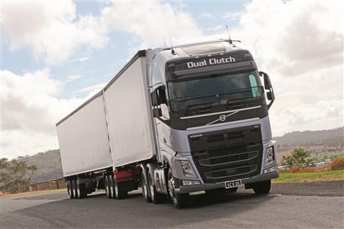

Volvo Dual Clutch: a clutch of class
Steve Brooks, Trade Trucks AU  /  June 26, 2019
If you think automated transmissions don’t come any smarter or smoother than Volvo’s super-slick I-shift, well, you’ll have to think again following the release of a new ‘Dual Clutch’ version. But are quicker, slicker shifts Volvo’s only motivation for adding the significant cost and complexity of dual-clutch technology?
Volvo’s dual clutch system is clever technology. No question. Launched in Sweden in 2014, which suggests any bugs have been well and truly ironed out by now, it remains a world first for heavy-duty trucks. As Volvo declares, "Transmissions with dual clutches are used in cars, but Volvo Trucks is the first and only manufacturer in the world to offer a similar solution for series-produced heavy vehicles."
Built on the remarkably, and deservedly, successful I-shift 12-speed transmission, the dual-clutch assembly makes Volvo’s supremely smooth and responsive automated shifter even smoother and more responsive. Some of the time!
But how much smoother and how much more responsive?
A little or a lot, the answer depends largely on where the truck is and what it’s doing.
Like, there were numerous occasions on a recent drive of a 13-litre FH540 B-double outfit when it was difficult to determine if there was any practical difference between this dual clutch version and the standard I-shift gearbox I’ve come to know and admire over many years in many trucks. Not just Volvo trucks either, but in the same transmission’s other identities as the Mack mDrive or UD’s strangely titled Escot.
Yet at other times during a busy stint that included hauling the 55-tonne combination up the formidable Toowoomba Range and down the unforgiving Cunningham’s Gap, the spontaneity of shifts through the dual clutch system was nothing short of outstanding.
Put simply, in the fluctuating flows of suburban traffic, where any modern automated shifter will routinely deliver multiple skip-shifts as traffic teeters between stop, go, fast and slow, the dual-clutch system showed little, if any, advantage over a standard I-shift.
Out in rolling country, though, and particularly where the grades came long and sharp both uphill and down, single-step shifts through the dual clutch system were breathtakingly quick and smooth. Sensationally seamless and, yes, appreciably more responsive than the standard I-shift.
Volvo refers to these single-step swaps as ‘power shifting’ – meaning no interruption to power and torque delivery during gear changes – and overall performance of the dual clutch system was effectively just as the press blurb said it would be.
Like, "When driving in conditions where it is optimal for the transmission to skip a few gears, the transmission changes gear just like a regular I-shift unit," Volvo’s press statement reads.
Conversely, as Volvo Trucks vice-president Tony O’Connell says in the same statement, "I-shift dual clutch … delivers seamless gear changes and uninterrupted engine power to the road when accelerating and climbing or descending tough grades."
And again, that’s just how it panned out on a run that started early on a weekday morning from Volvo’s Brisbane North dealership and ended 350km later at Volvo Group’s new headquarters at Wacol on the city’s western edge.
Riding shotgun was Volvo Group fuel efficiency manager Matt Wood (yes, the same Woody I’ve shared many travels with in his former life as a truck scribe) who had the 13-litre FH540 perfectly prepared, hooked to a B-double trailer set mounted on wide profile single tyres.
DEFINING THE DETAIL
With just 1,600km on the clock, peak performance was probably still a few thousand kilometres away but that said, Volvo’s top 13-litre rating was typically lively and certainly not shy when required to dig deep.
Even so, this was an exercise primarily designed to showcase the merits of the dual clutch system over a relatively short but demanding route, and ideally, how this form of transmission technology can aid the efficiency and performance of Volvo 13-litre models at 500 and 540hp (373 and 403kW) in either FM or FH forms.
At this point it’s worth noting the dual clutch system is not available behind Volvo’s flagship 16-litre models.

"The two [dry type] clutches are connected to two different input shafts, operating independently of each other. Since the gearbox has 12 [forward] gears, one shaft holds the six odd numbered gears while the other holds the six even numbered gears.
"During gear changing, the first gearbox is disconnected at the same instant as the second gearbox is connected, so gear changes take place without any interruption in power delivery."

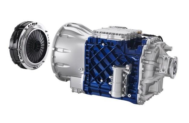

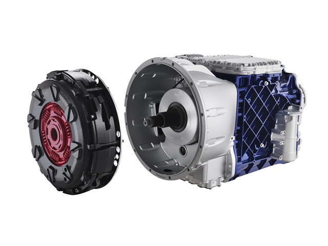

The I-Shift Dual Clutch transmission consists of two input shafts and a dual clutch, which means that two gears can be selected at the same time. It is the clutch that determines which of the gears is currently active. I-Shift Dual Clutch is based on I-Shift, but the front half of the gearbox has been redesigned with entirely new components.
Essentially, the I-Shift Dual Clutch is two gearboxes linked together. During gear changing, the first gearbox is disconnected at the same instant as the second gearbox is connected, so gear changes take place without any interruption in power delivery.
The two clutches are connected to two different input shafts, operating independently of each other. Since the gearbox has 12 gears, one shaft holds the six odd numbered gears, while the other holds the six even numbered gears. The gear changes using the two clutches can be used for all single step gear changes apart from the one between sixth and seventh gear, as this involves a range change –from low to high, or vice versa.
When the transmission control unit decides it is a good idea to skip ratios, when the load is light and the going easy, either going up or down the box, the I-shift will change gears as it would normally without a second clutch.
