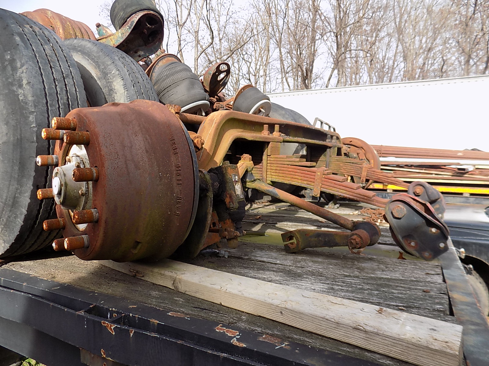

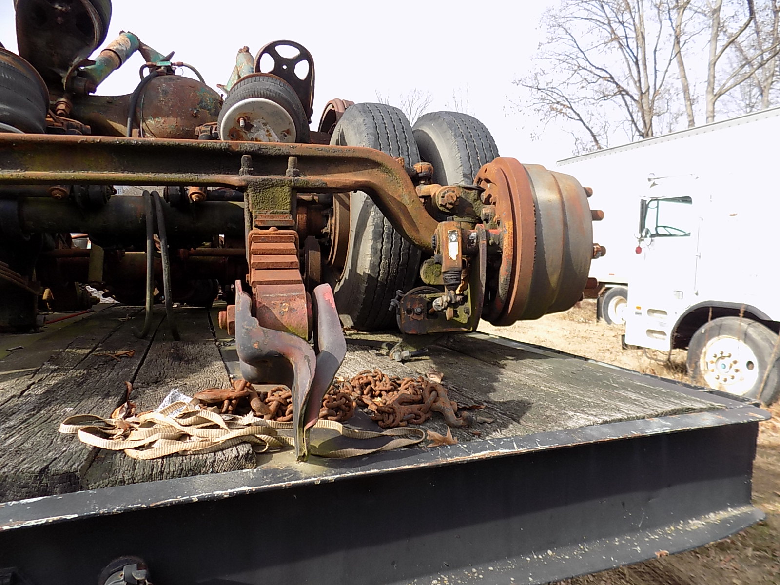

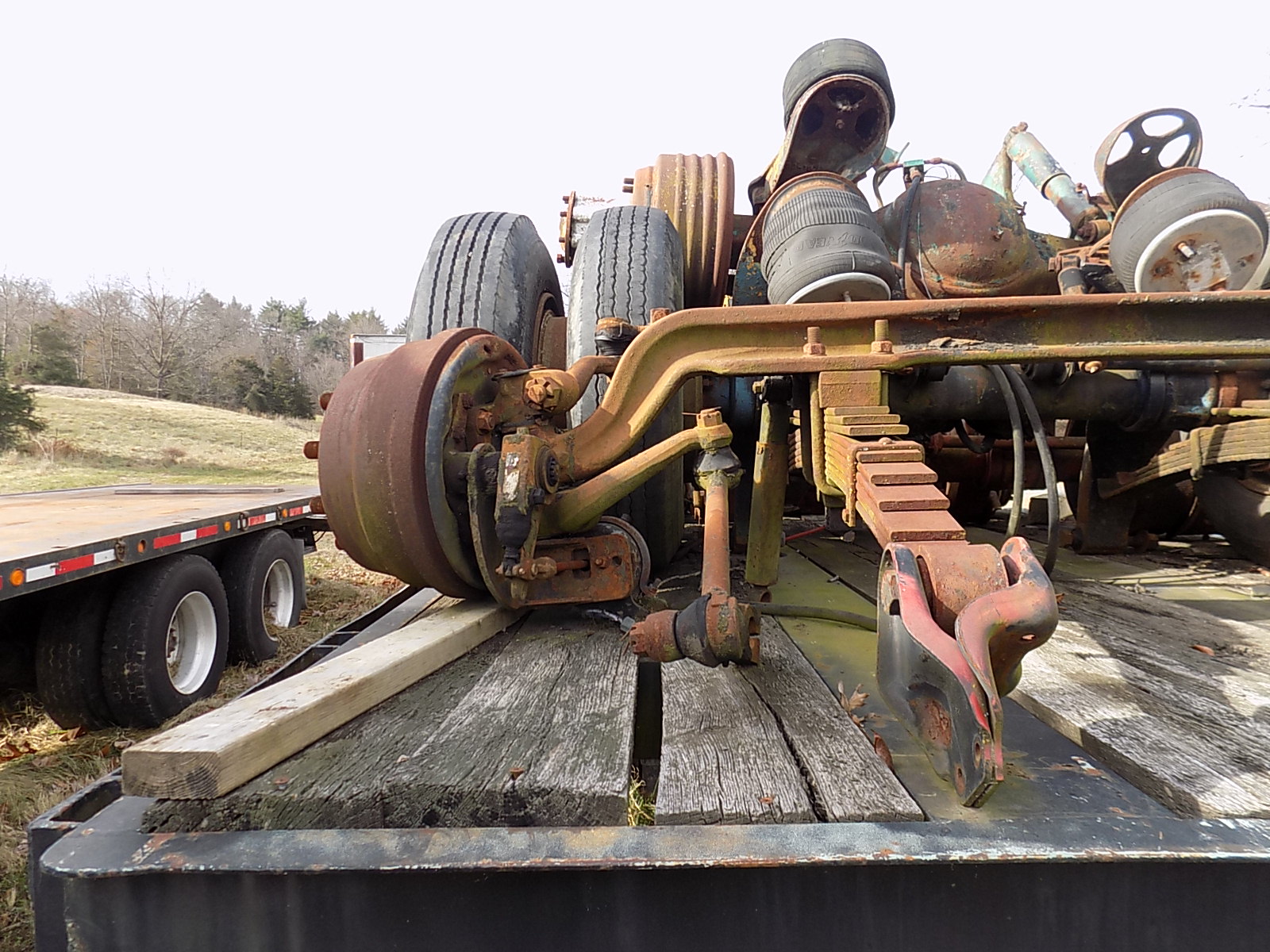

That's my plan.   By measuring from the outside of one spring to the inside of the othet I got the center measurement without removing my bump stops to actually see the center pin.   I thought about making bushings that would slide on the u bolt to take up the difference in spring width.   Do have a pic. of what mack used on the b42's?
https://www.bigmacktrucks.com/topic/48072-tired-pup/page/2/#findComment-355825
