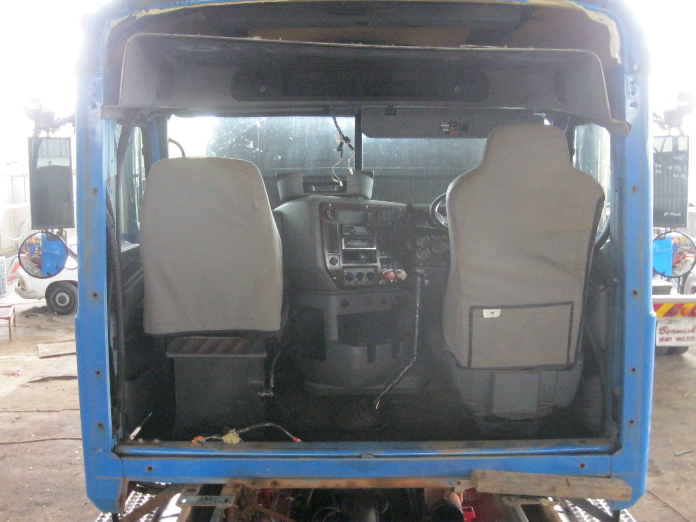

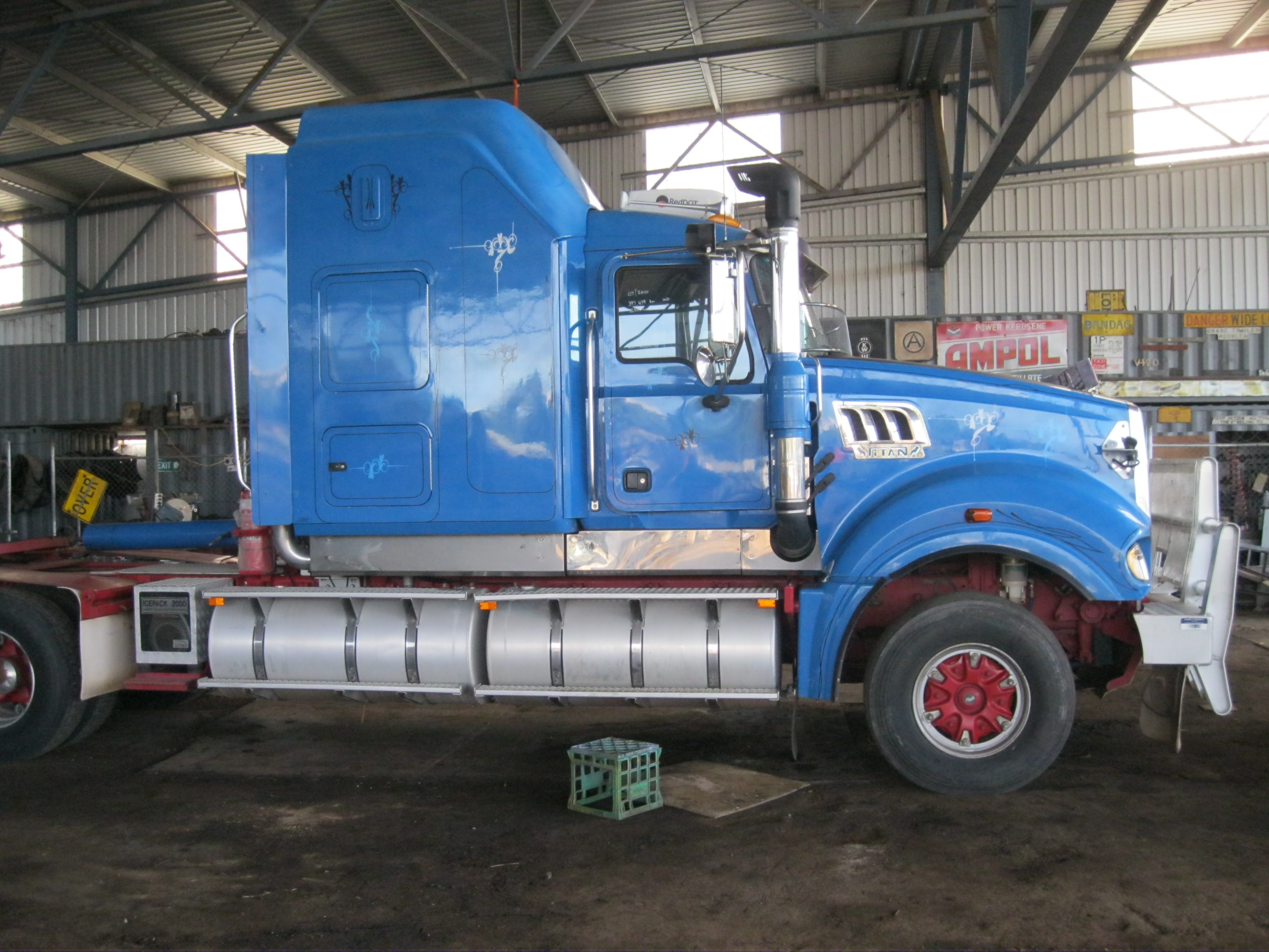

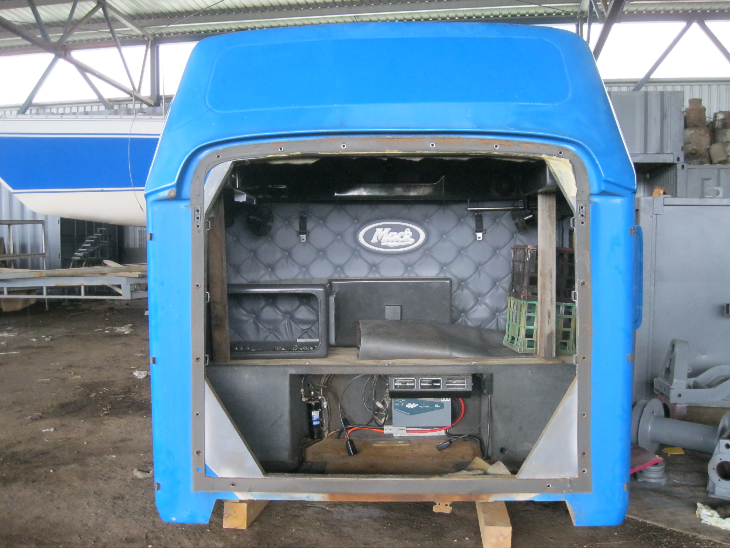

the walk in sleeper I removed was 64 inch it only had a thing rubber type gasket to keep the water n dust out
here is the removal of the hi rize walkin sleeper from a 2010 Mack Titan

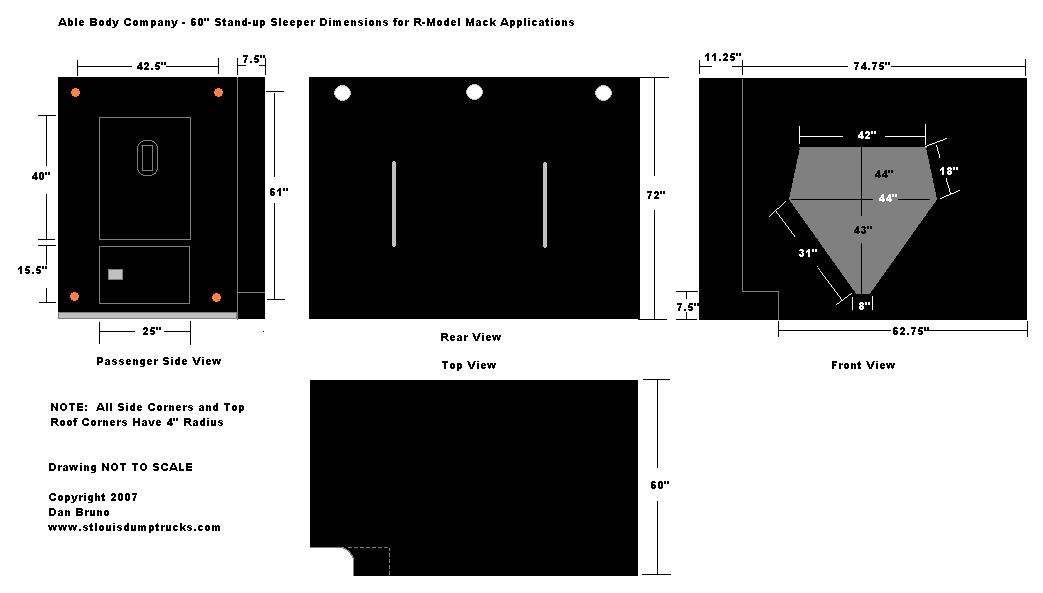

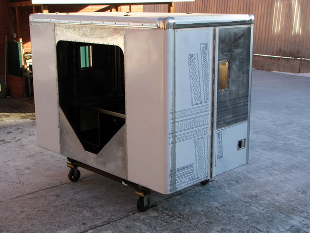

The days when "Rubber Duck Mack" fan website was full of power I sawed a picture from there.
It was adressed to modelbuilders who were requesting technical details.
You can see the measurments of the sleeper and the shape of the walk-through cut out.
When I had my R-model bunk redone I referenced to this drowing and found out it wery useful.
The upper part I kept original (which just reflected the rear window opening) and the lower design was made as there.
Worked out fine for me.
