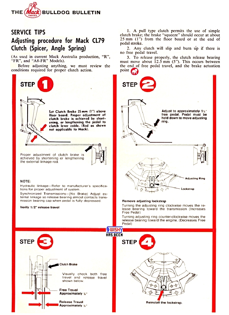

Is the clutch brake set where its supposed  to be? Right at the floor!! that is the most important first step that is sum times missed!
If you set the gap and  the brake is not set correctly the angle springs can be at the wrong angle to grip properly ! Depending on which clutch is in there! This is can be common Issue with an easy pedal clutch if not adjusted correctly! An over adjusted easy pedal may slip!

Once the beast leaves the factory wen new the linkage should never need adjustin as all the clutch adjustment is dun on the clutch pressure plate via the lock strap. adjust the clutch brake last after u have fixed the slipage
