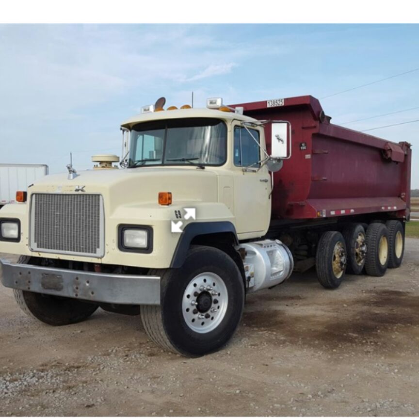

Buying a 2000 mack e7 400hp dump code ??
Question
1 answer to this question
  • 0
Can only be checked if the yellow/amber  "lighting bolt" is on. Turn the cruise on/off to off ( down). Then press and hold the set/decel or resume/accel  button till the fault lamp goes out , then release and the fault lamp will flash out a 2 digit code.
