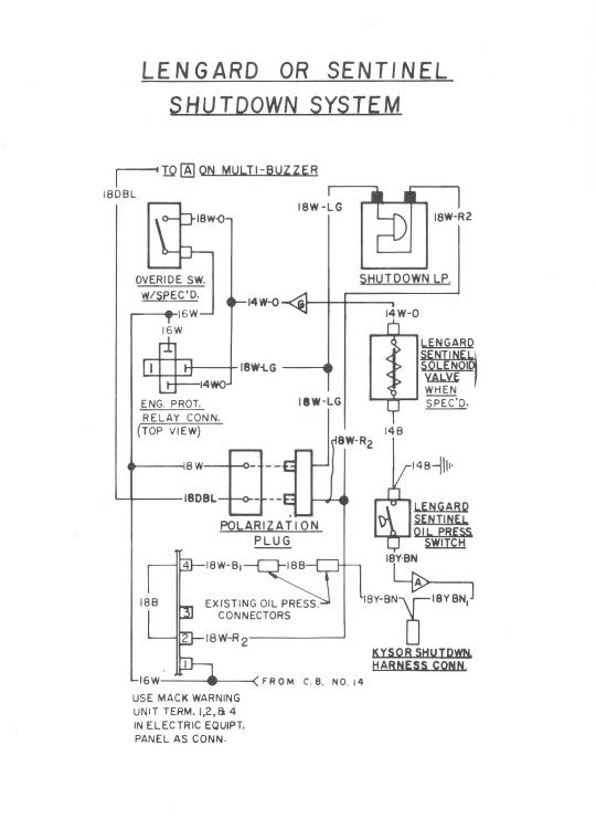

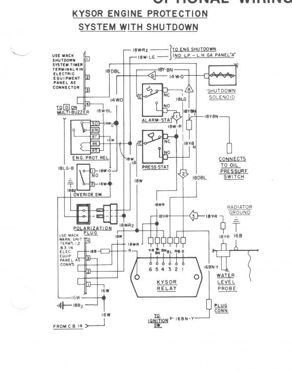

I may be getting ahead of the problem here.... and I'm taking a guess that Aus built MH's share similar electrical systems to US built trucks...
I have attached two references from the MH electrical manual which may be of use if this is the problem.
