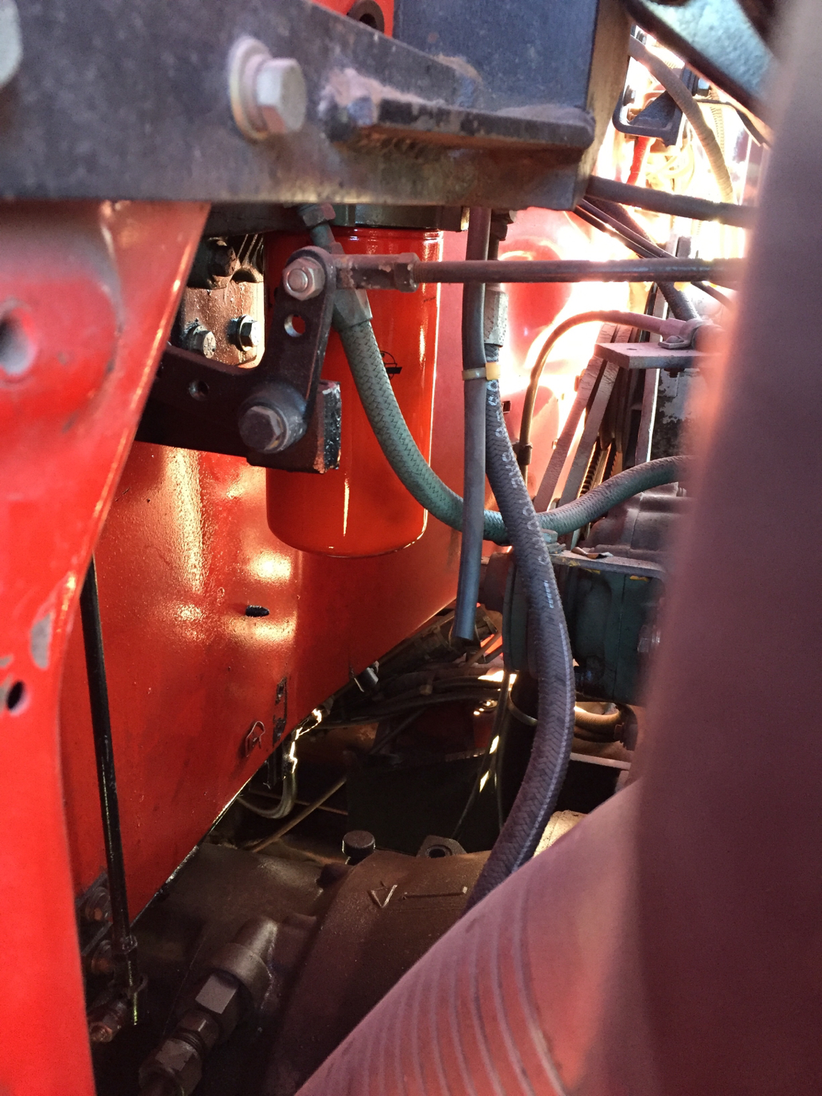

So we got the general Ike fired up today with absolutely no issues whatsoever until I pulled out onto the road. Started smelling diesel fuel pulled over and found that what appears to be the fuel filter attached to the firewall just behind the turbo charger on the 6V 53, was Leaking excessive amounts of fuel from where the filter meets the filter housing. I'm assuming that this is because the gasket is shot from sitting. Is this a simple unscrew the old filter and put a new filter on? Will the system lose prime when I go to do this? I assume that I should fill the new fuel filter with diesel fuel prior to installing

Should be fine if you fill filter up good; crank & hold throttle down bout halfway till it clears up good; probably secondary filter; if primary it would been sucking air
Makes sense. The Baldwin Filter part number is listed as a secondary filter.

A Detroit, LEAKING?  Who would have thought such a thing...?  I thought, "yeah no kidding"? when I read the title...good to see it's only fuel.  Fill the new one and spin it on.  Do as suggested above and you will be fine.  It worked for me.

So when I removed the old fuel filter you could see that The O-ring had been blown out of its groove and that is how it failed. Got a new filter lubed up the O-ring filled it with diesel installed it Truck fired up right away but as soon as I throttle it up it blows the O-ring out through the side of the filter and the filter housing resulting in the same pissing of diesel fuel problem I started with last weekend. Took the fuel filter off re-seated the ring reinstalled it and it happened again. Thoughts? Have to believe it's an excess fuel pressure issue. Is there a return line that could be clogged. Truck idles and accelerates perfectly so the motor is getting the right amount of fuel.

Need to check & see if your getting fuel from return line; dd engines use a restricted fitting to make fuel pressure; it could be stopped up

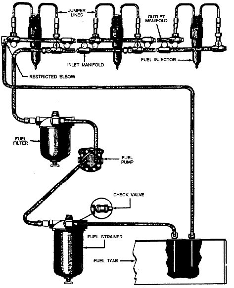

Typical D D fuel system lay out. This will give you a good idea where to look.
You can place fuel pressure gauge in the system to see what is going on. A gauge mounted on a "T" at the fuel filter inlet would let you know what the pressure is at the filter.
Since the truck ran correctly before it sat I would look for a simple problem like a kinked hose or a blockage caused by mud daubers. Take the time to think through what could be damaged by just sitting instead of jumping to the conclusion that it is something serious.
I'd take the return line loose and check for fuel flow first. If not blow it out.

I'd see if you can see return in tank if not remove return line & blow back in it; not lot of pressure; hopefully it's got a little shellac build up; those return lines & restricted fittings can be in a terrible place to get to; according how it's plumbed; take it loose at easiest place first & try;
checking fuel pressure is done at secondary filter head on "in" side; should have another 1/4" pipe plug you can screw into; 20# at idle 60# noload
