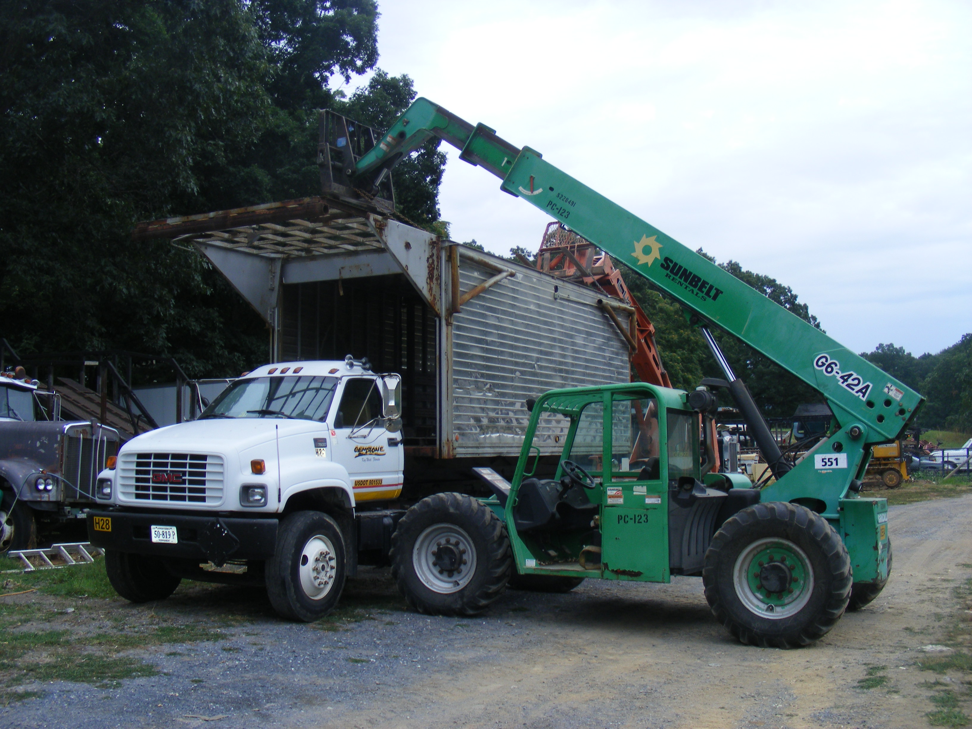

if you can find one of these to rent close enough to you  it the best all around lifter for what you`re doing      g642 gradall extenda boom  not a real good pic. but the green thing
